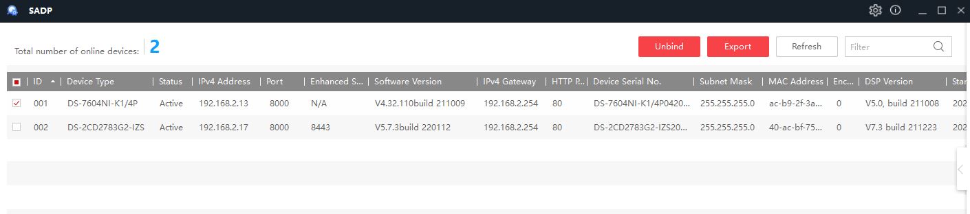

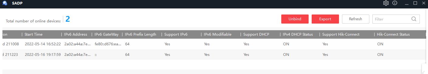

I cant access it with any browser on my LAN. The cameras I can access by the webbrowser. I did a restore to inactive but it was not a solution. My NVR is a DS-7604NI-K1/4P. Anyone a suggestion?
Here it is

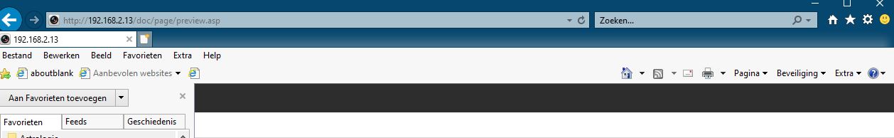

This is what I see after a login attemp with usn/pw
Is that Gateway address the correct IP address for your network router 192.168.2.254?
Its the address of my DHCP server. It is off course not my WAN IP address.

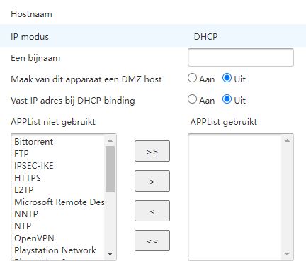

I have this specific screen for LAN addresses in my router. I dont know whether it means anything. But for the cameras and the NVR there are no APPs selected.

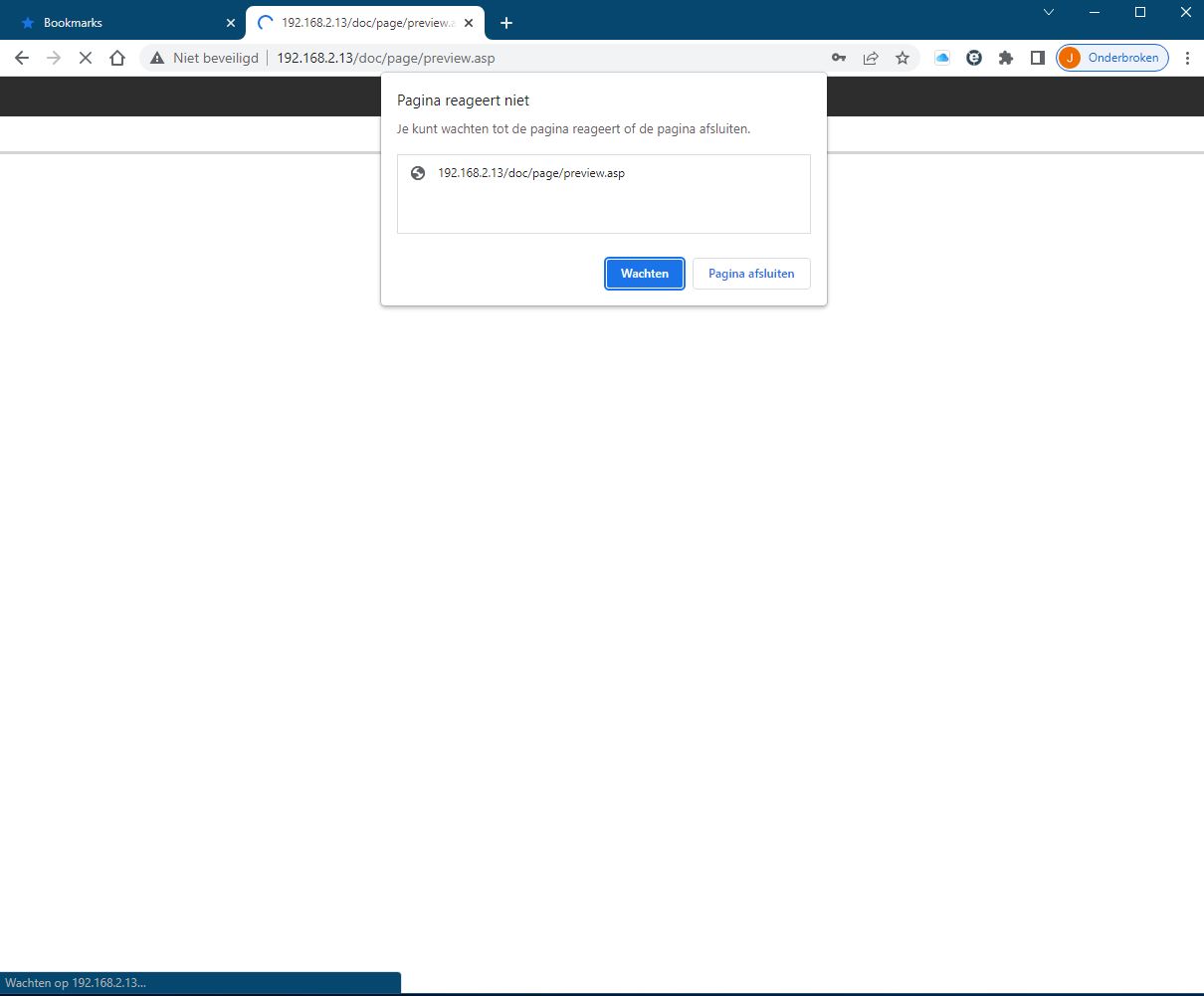

I have tried chrome with and without the IE tab; Edge and the old IE. All with the same result. I can login and wath I get is the result in knipsel C dated Monday at 8:28 PM. After some time the browser hangs and I are unable to do anything with it otherwise than force a close.

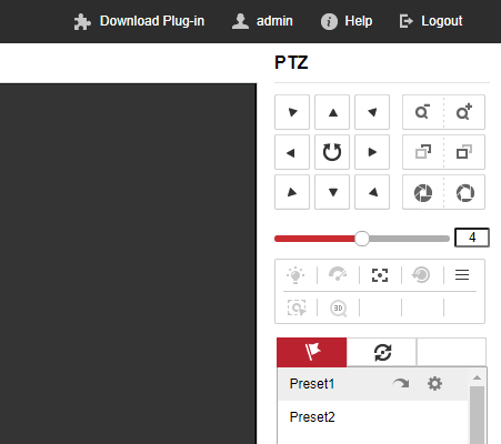

Did you ever download and run to install the web components plugin from the top-right of the NVR view?

In case the web component is different (specific to the NVR) can you try to download its plugin and install it?
Assuming you can login and see & download it.
Modern browsers (Chrome for example) should work fine with that NVR and firmware version - no need for IE10 / IE tabs.

What I see after logging in is in the newly attached file.
So it just tries to get access but it can't get access for one or another reason.
