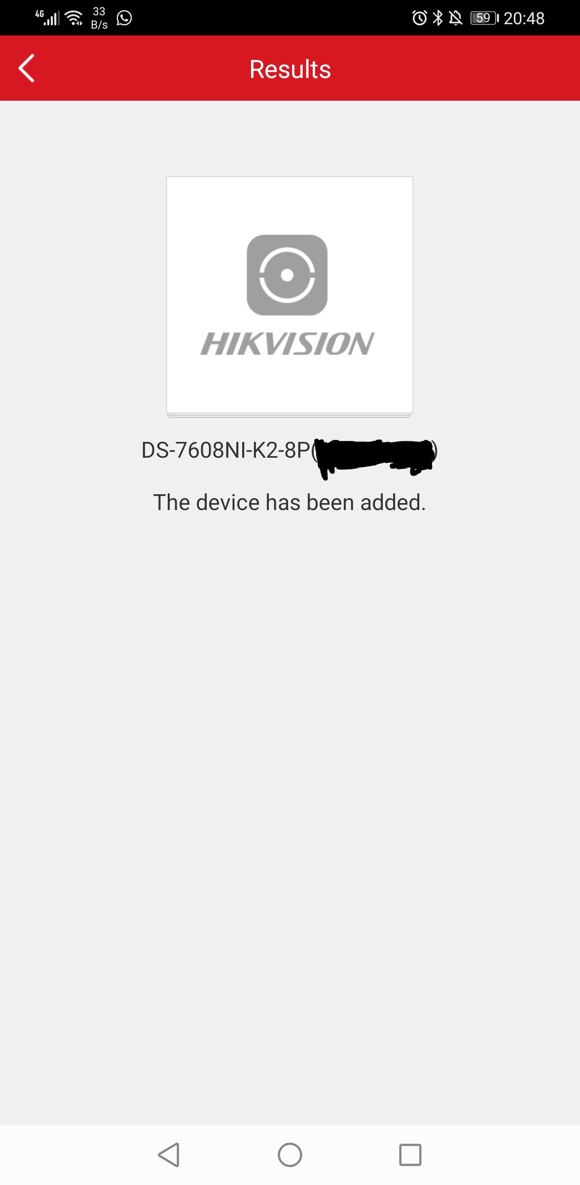

It was working perfectly fine untill yday when I decided to update the latest firmware (V3.4.107 build 190927) I hope that's the latest one. At first I couldn't get the cameras working as it showed incorrect username or password error which I managed to sort out and change password, now it's all shows connected. I can see stream on the batch configuration software all cameras shows connected and does give me live feed. However when I try and connect it on my hik connect app on my phone it adds the NVR but doesn't do anything no error just says device added and it stays grey no option to asking verification code and can't see any streams remotely. I have attached a pic. If I close the app and restart again it only shows refresh button and add device button. Its like I'm in a loop. I have rebooted device many times, I've u installed app and installed it back again its not seem to work.
P.S. I can view my NVR and stream on hik-connect via add by online device method but when I add by qr code or serial number it don't work
