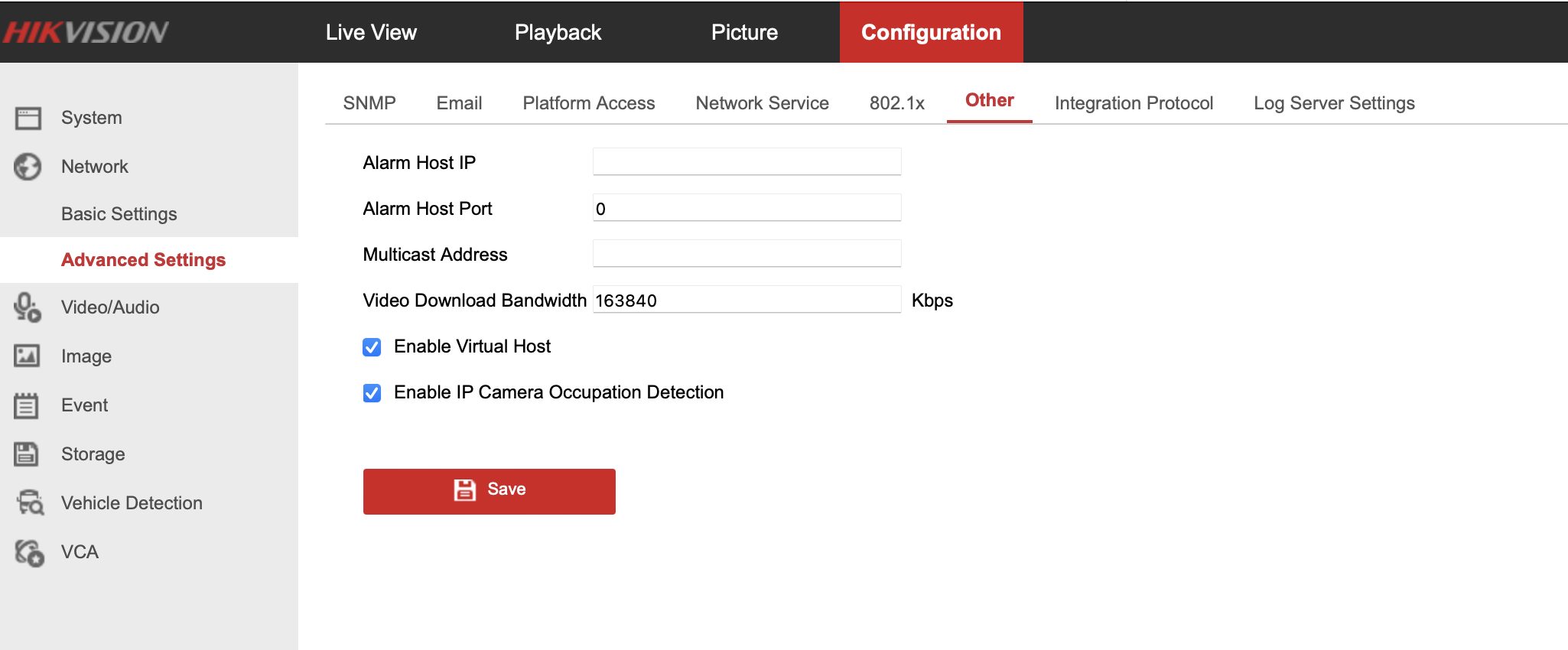

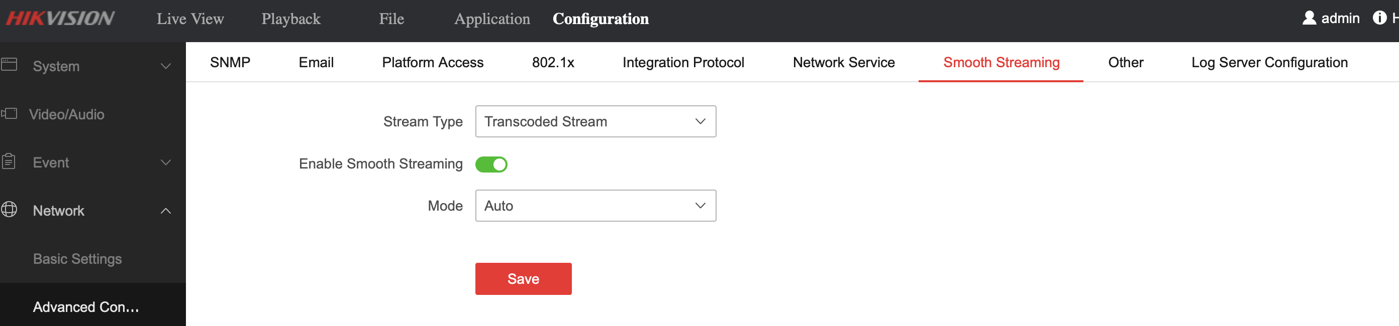

As you can see below - first image is from a K series and the second from my M series. The K series cannot transcode as it does not have the 'smooth streaming' feature. This has nothing to do with streaming bandwidth:
  • The incoming bandwidth relates to how much data the NVR can handle simultaneously from the connected cameras
  • The outgoing bandwidth relates to how much data the NVR can serve out simultaneously to connected clients
  • Transcoding is the ability of a recorder to take the main stream and re encode it on the fly, as it serves it out to a connected client. I imagine that recompiling multiple 25FPS 4K streams in real time is incredibly process intensive.
Transcoding is enabled by default but probably unnecessary in your circumstances so I'd just switch it off. It would be useful for someone who needed to see a main stream on a client remotely but didn't have sufficient bandwidth due to poor network conditions. That's similar in use case to Channel Zero - which recompiles multiple camera streams into a single channel low bandwidth 'multiscreen' stream.

It seems as though 'Smooth Streaming' is something that is applied to the Transcoded stream. Disabling it does not change the selections available in the browser Live View (1 Main, 2 Sub, 3 Transcoded). So switching it off does not disable Transcoding.
