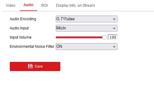

A word of warning, this codec will stop you from using 2-way audio if you have liveguard cameras

Me neither I noticed today when trying 2-way and Hik-Connect continually throws up errors
I haven't been able to find an audio code where the 2 way audio is working. Which audio codec do you use for 2-way audio please?
See below the default codec for liveguard cameras where 2-way works fine
