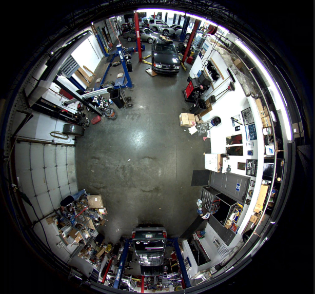

In the example image below you can see that although the fisheye is covering everything in the workshop, it's actually really difficult to identify anything specific because of how warped the image is. The only thing that would be in detail would perhaps be the top of someone's head as they passed under the camera! ;)
In this scenario I would instead recommend using a couple of 2.8mm/4mm cameras pointed towards areas of interest as this would provide a maximum viewing angle of around 90° and be able to capture number plates and faces in high detail.
