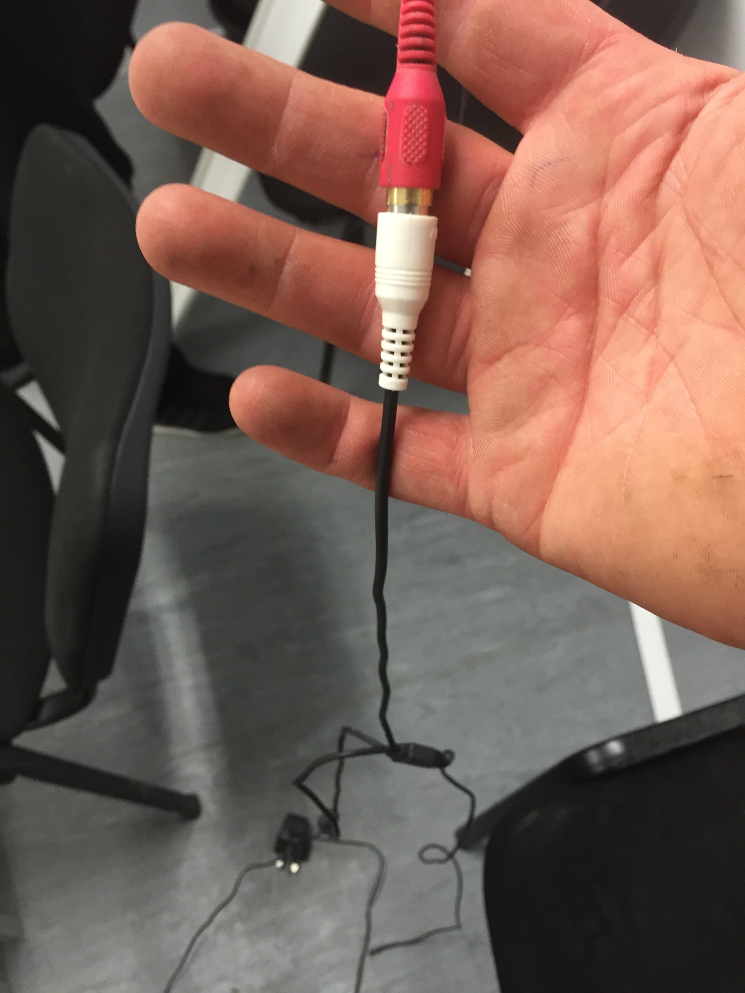

- The MP33865 was more complex, necessitating an extra step to the above in which you'd need to chop off a connector and strip a few wires before securing them in to the audio terminal block of the camera. Very simple stuff with some instructions, however!
- The externally powered microphone was the same as the above, but it does require an external power outlet (ie. a plug) to be within approximately 5m of the device's location which is definitely worth keeping in mind.
