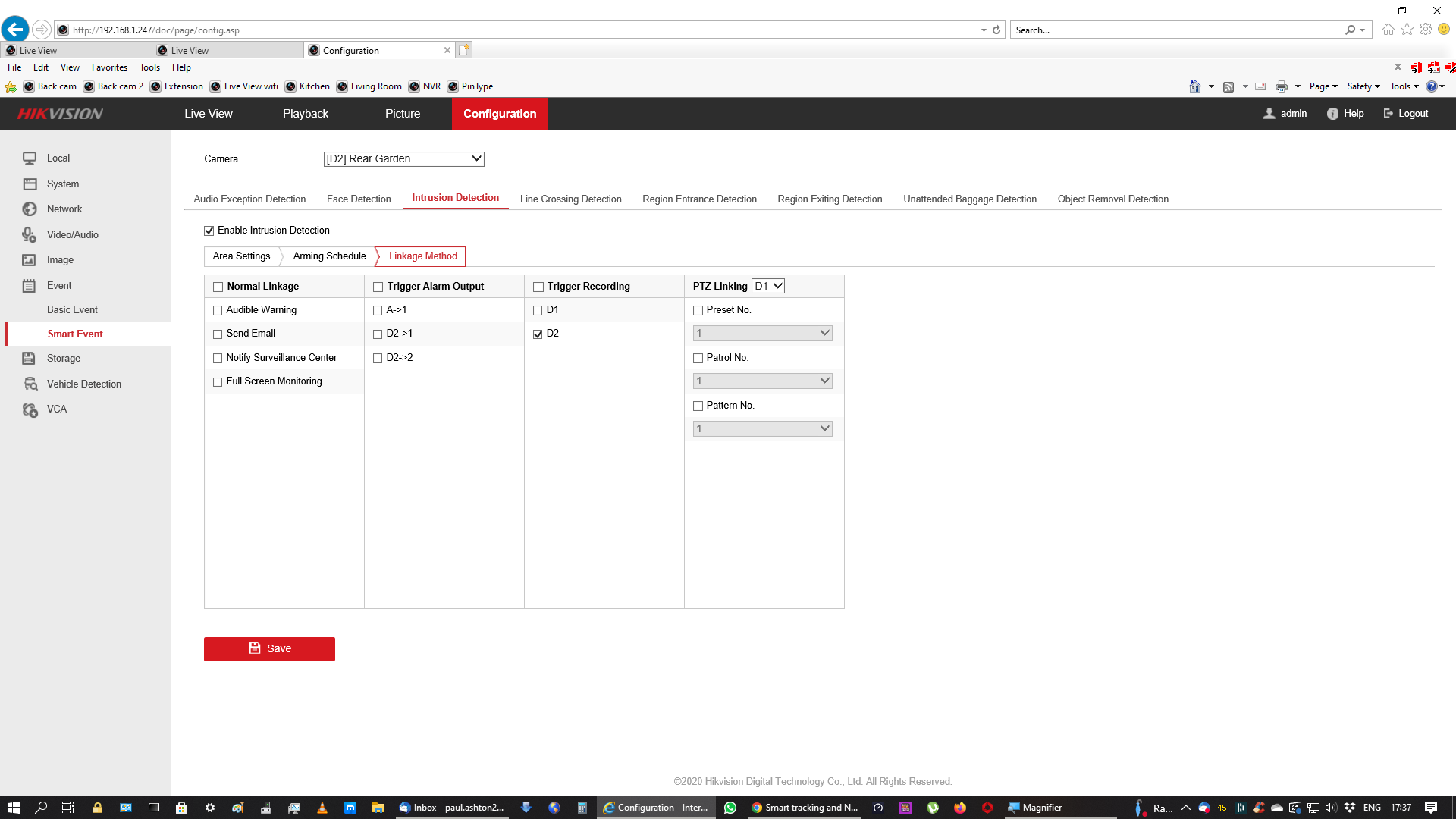

Sorry for the very late update. I have included a screen shot of the PTZ settings and there is nothing there to enable tracking. I am now using a far newer NVR which is the DS-7608NI-K2 / 8P on firmware version V4.30.011 build 200803. How Hikvision could say there the settings are there 2 years ago is beyond me as they are not there now, unless they removed them since? The screen shot is in the NVR settings not the camera, using internet explorer.

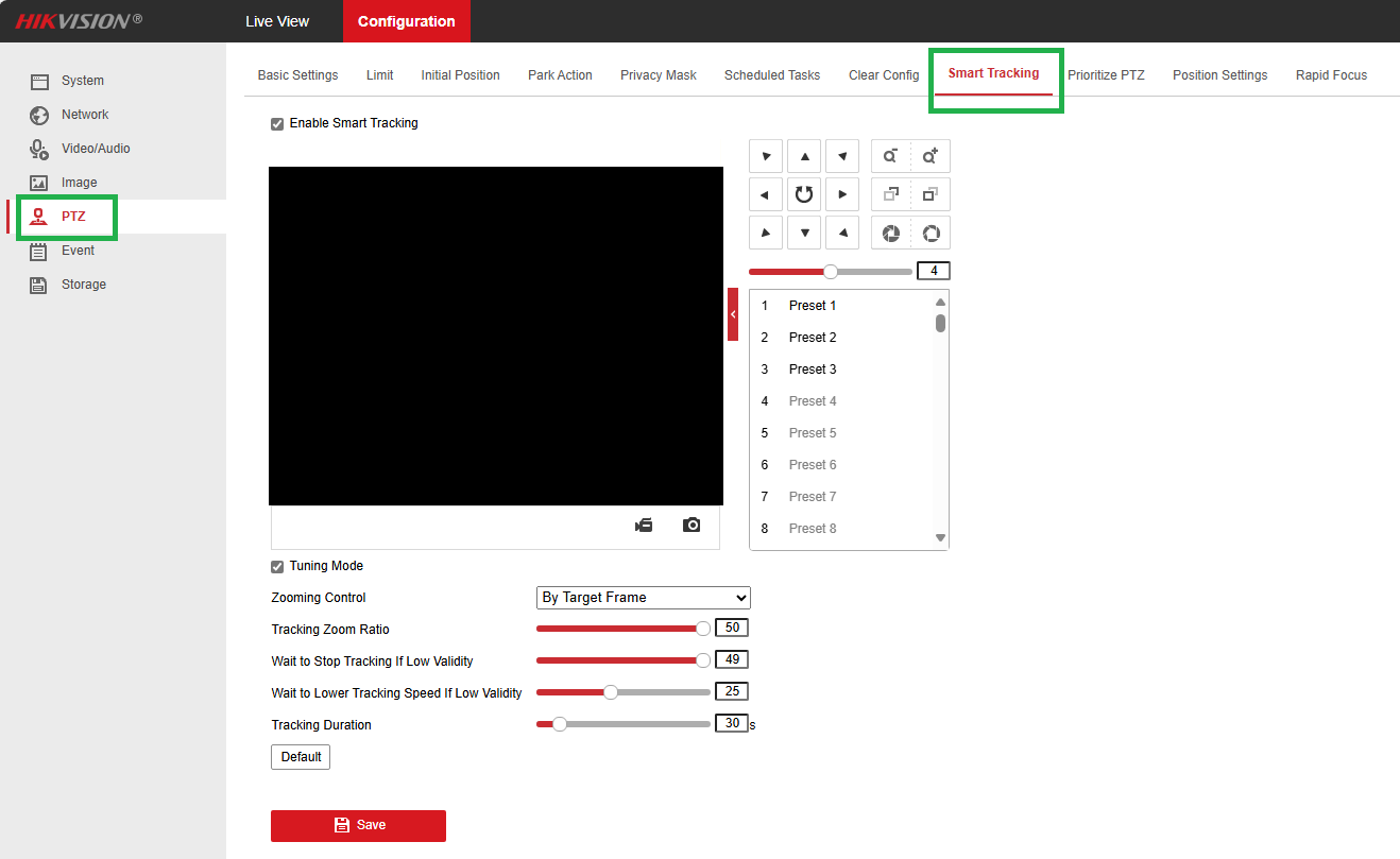

Good Day, I dont know if this issue has been resolved yet
You need to configure the Smart Tracking directly on the camera NOT via the NVR. Please see attached
