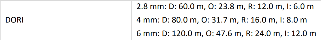

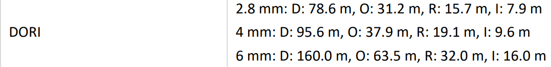

If you look at the DORI section on the attached datasheet for both cameras, this gives a good indication of the picture quality, as it stated the maximum distance that you should be able to detect (D), observe (O), recognise (R) and identify (Y) a person.
This webpage explains DORI nicely in detail:
For the DS-2CD2346G2-IU:
For the DS-2CD2366G2-I(U):
