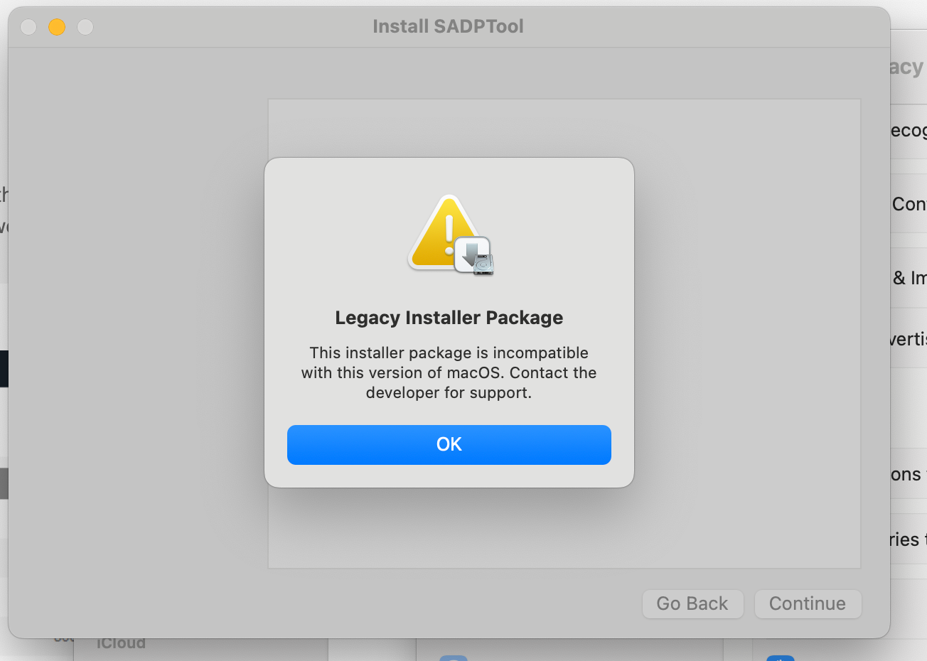

Hi. I'm having difficulty using SADP TOOL on my mac. The downloads don't work, does anyone have a solution? I'm on macOS Sequoia 15.1.1. Thanks.

Download should work fine. MacOS possibly blocking it. Just go into Settings > Security and Privacy and there’ll usually be a prompt that it’s been blocked where you can click ‘download anyway’

As far as we are aware, several of the Hikvision Mac Tools are no longer supported by Macs running MacOS Sonama or newer.
Hmm - that's a pain. I've just tried mine on MacBook running MacOS 15.3. As it was installed under an earlier version, the app starts but after a refresh does not see any devices. I also have Windows 11 running on the same MacBook in a Parallels VM and that works fine. I'll not hold much hope of seeing an updated SADP for Mac anytime soon from Hivision.
You might be better just registering for Hik-Partner Pro for your mobile device which has SADP built in. Theres also Hi Tools Delivery but I'm not aware of a Mac version
