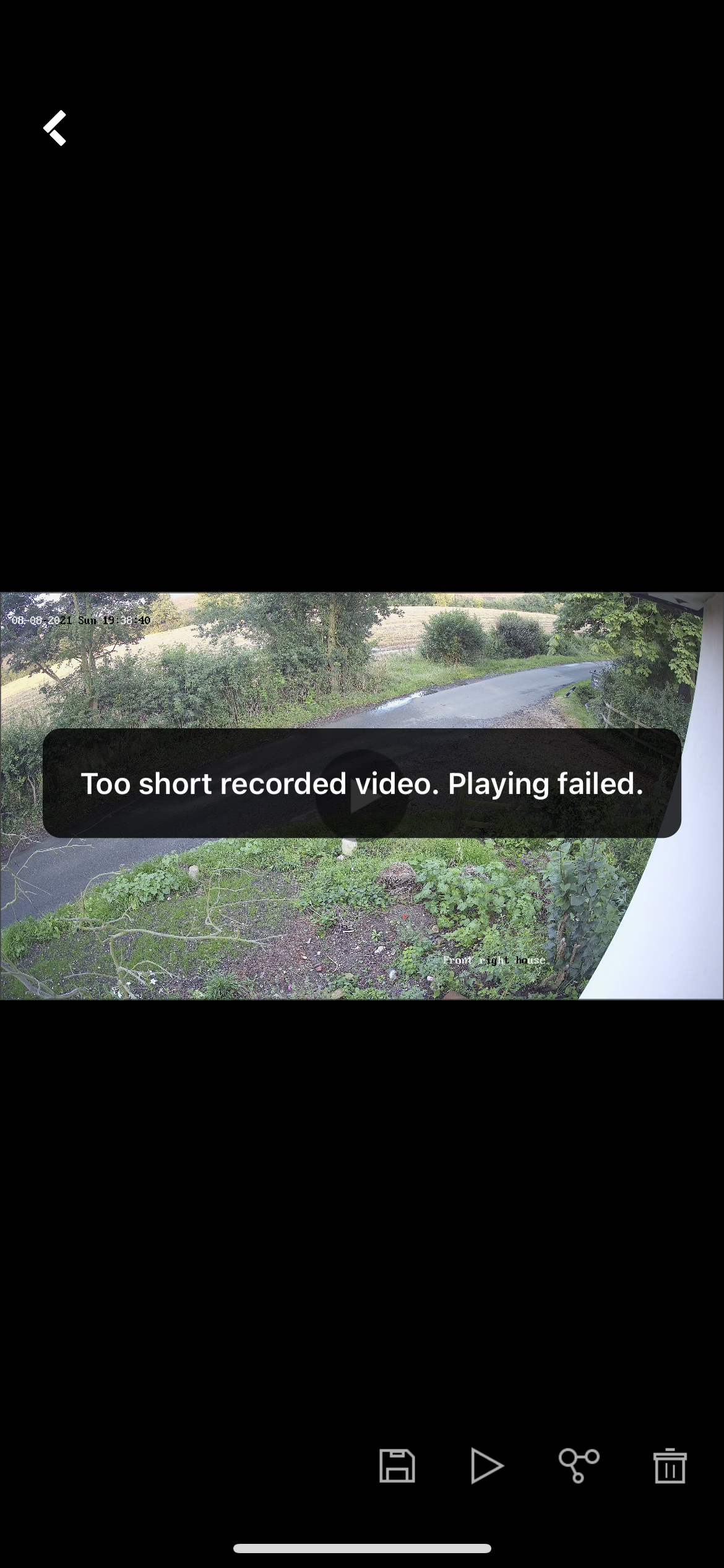

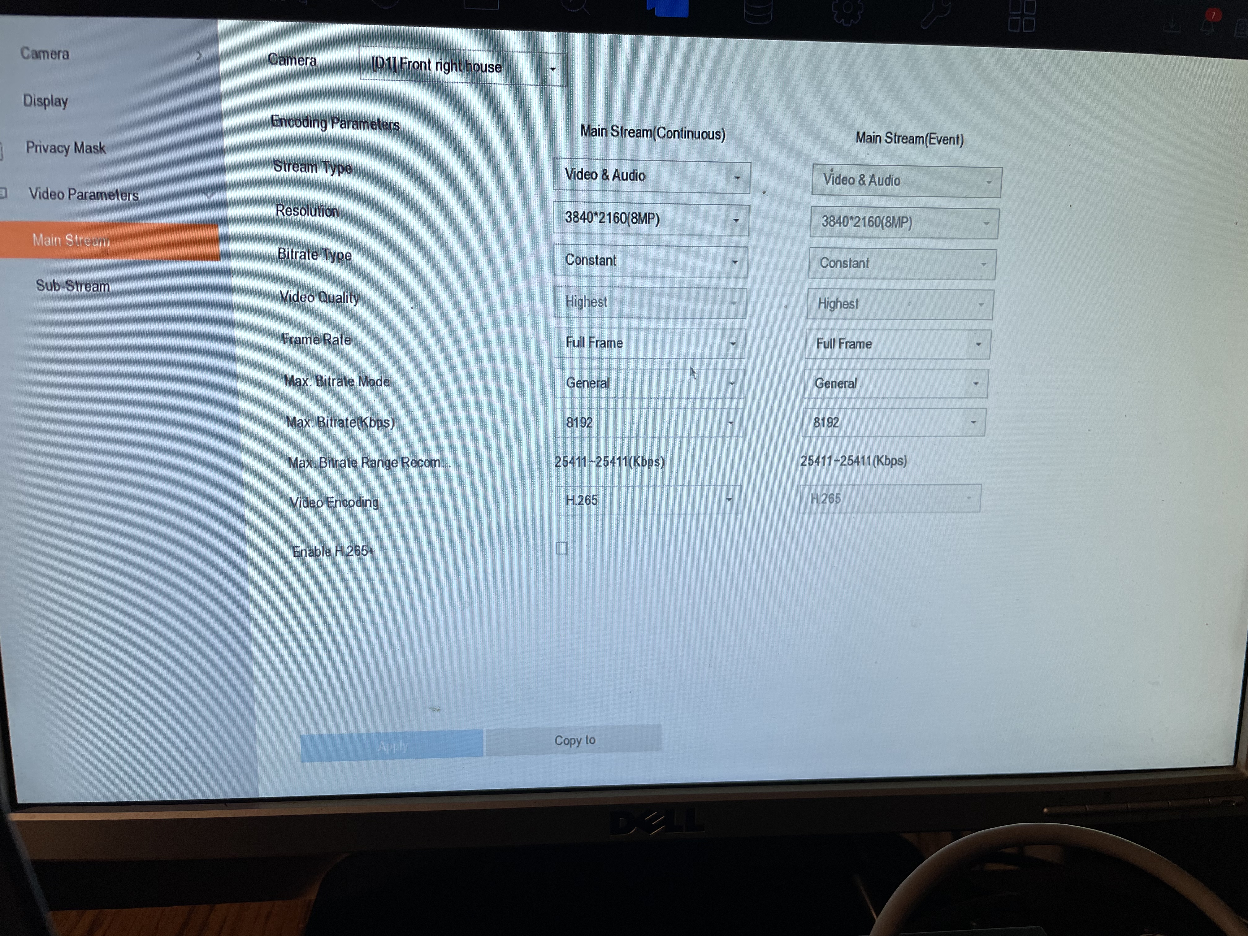

Thanks for your reply JB, sorry I haven’t been on here for a while.
I have been playing with the settings and it quickly became apparent the bitrate was far too high. I’ve knocked it down, but I’m still really unhappy with it. It used to work perfectly at night and that too has also stopped worked - close to ripping every piece Hik stuff out and go for another brand.
Issues currently are;
Audio; the camera mic seems to work in Hik-Connect on live stream, it appears not to be recording (saved a video from the NVR and no audio present). Audio isn’t playing when viewing back, or from an alert within Hik-Connect. The 2 way audio, again crap. The 2 way will work within the app for 5-10secs then drop, can only connect within Hik-Connect via the camera option, not the NVR.
The video quality for objects moving beyond 20mph becomes poor, and gets worse as passing cars get faster. The still images within the app are sometimes ok, other times rubbish. In addition, the quality of the video overall isn’t as I had expected for a 4K camera. Am I being unrealistic for this type of cameras? Do I need an ANPR to do this?
It used to work perfectly at night and that too has also stopped worked. I have tested this for both passing cars and me stood in front of it. I had to start shining a torch around for it to detect me. This literally occurred overnight with every passing car being spotted, and the following night and ever none at all at night. I hadn’t been near the NVR the day I noticed it wasn’t work at night. When I live view at night I can clearly be seen as too can passing cars.
I am so close to ripping every piece Hik stuff out and go for another brand. Any help you, or anyone can offer, before this stuff leaves this loft window first class, would be really appreciated. Please see images of core settings attached.

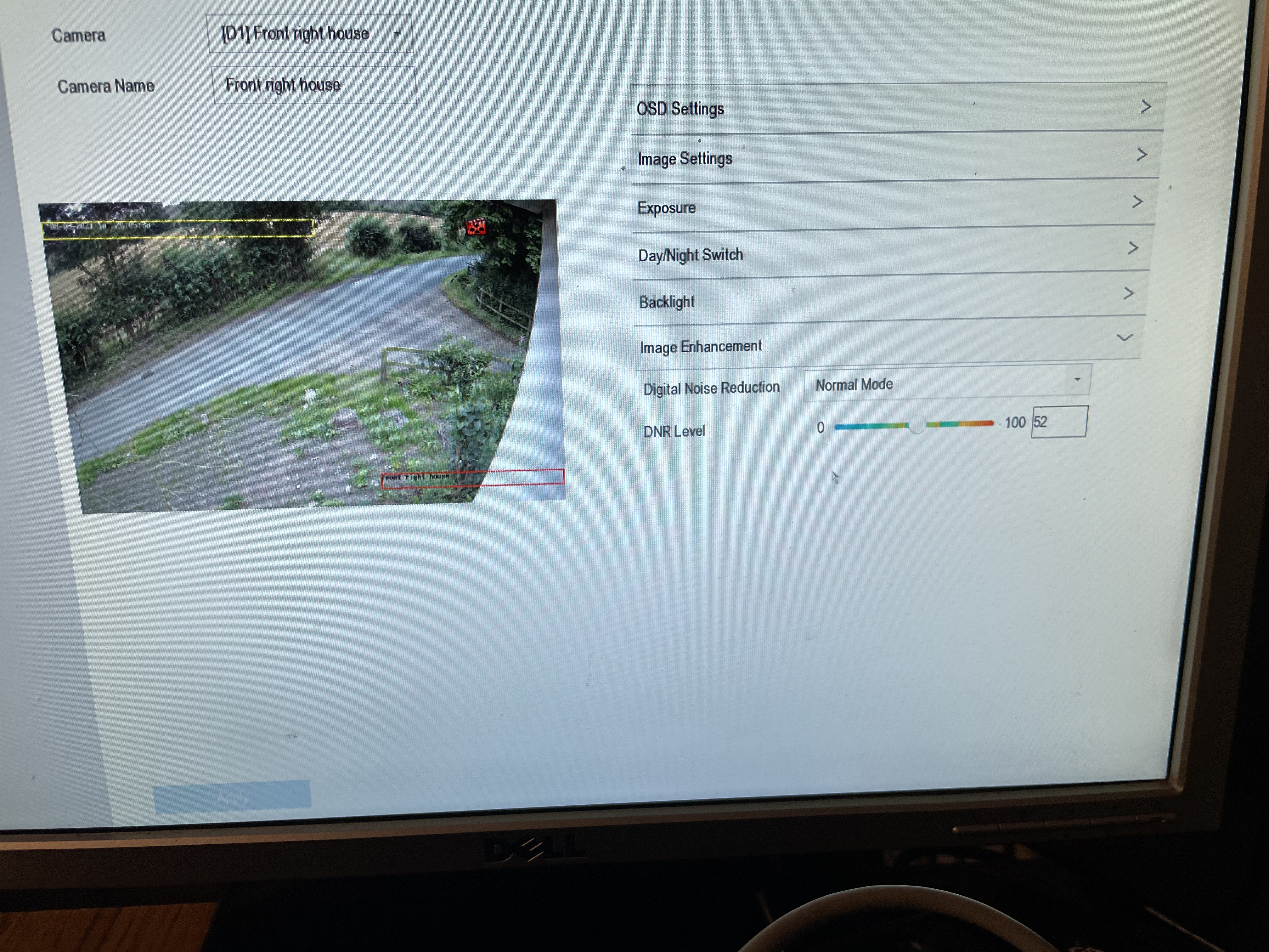

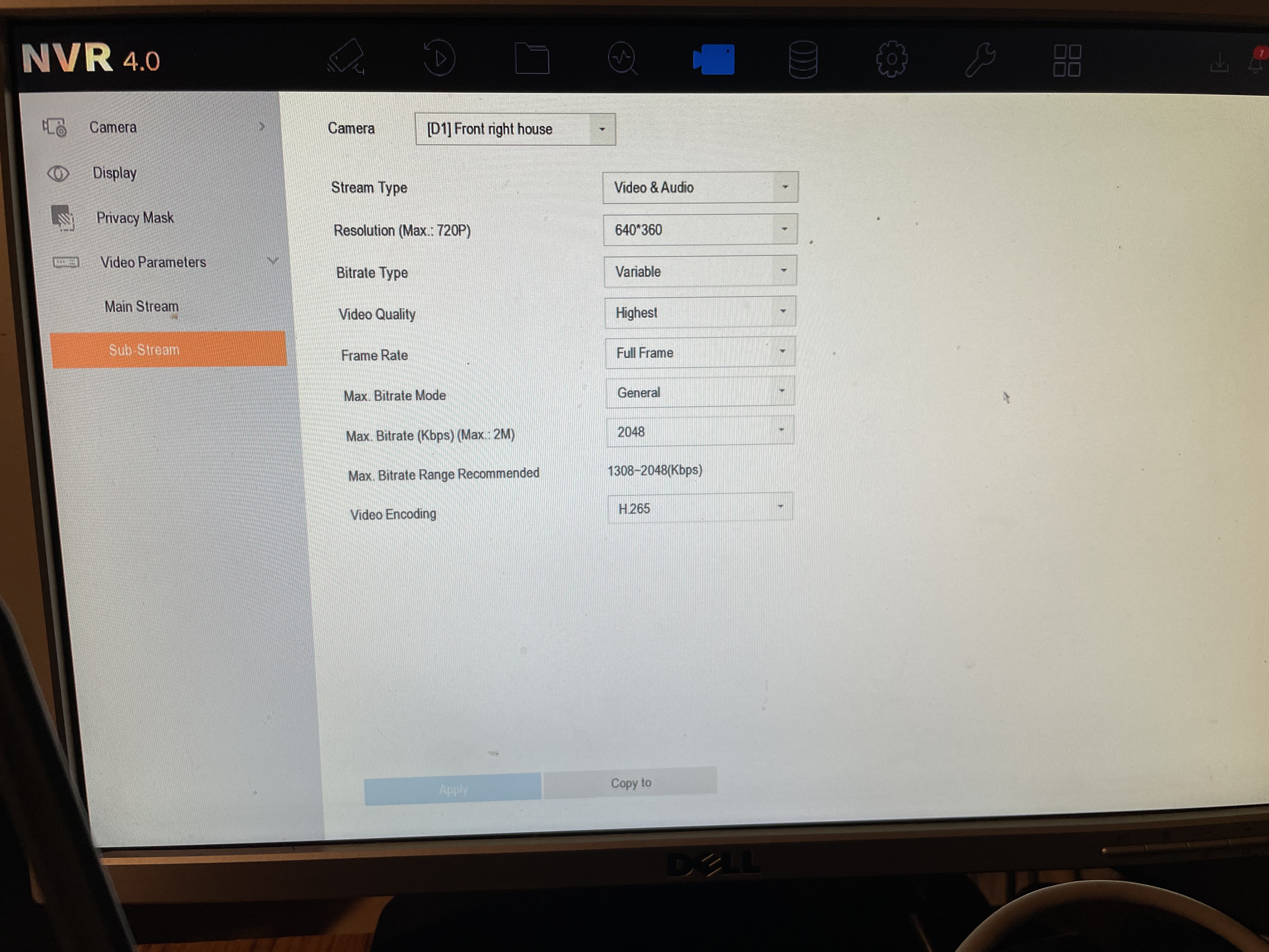

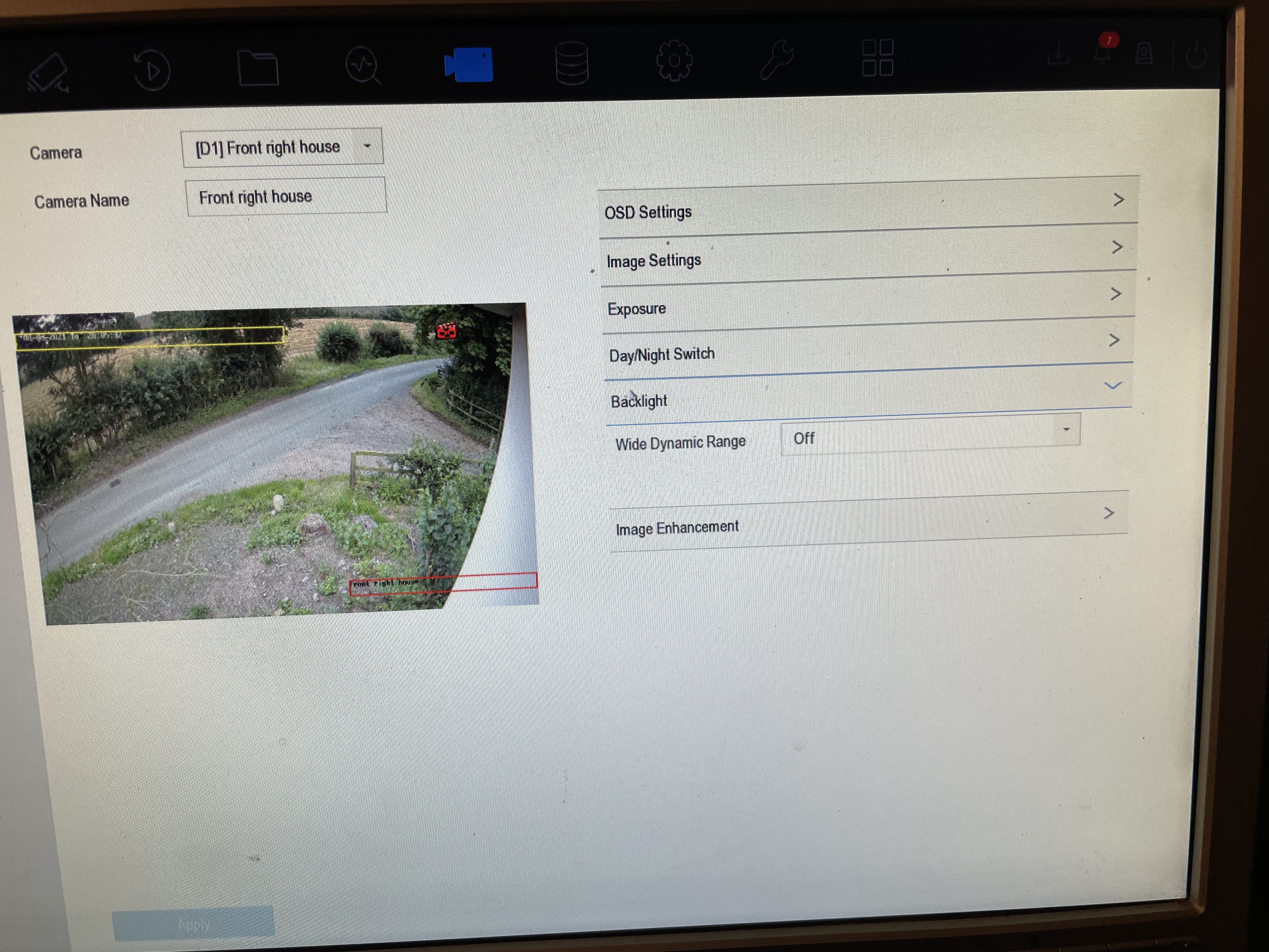

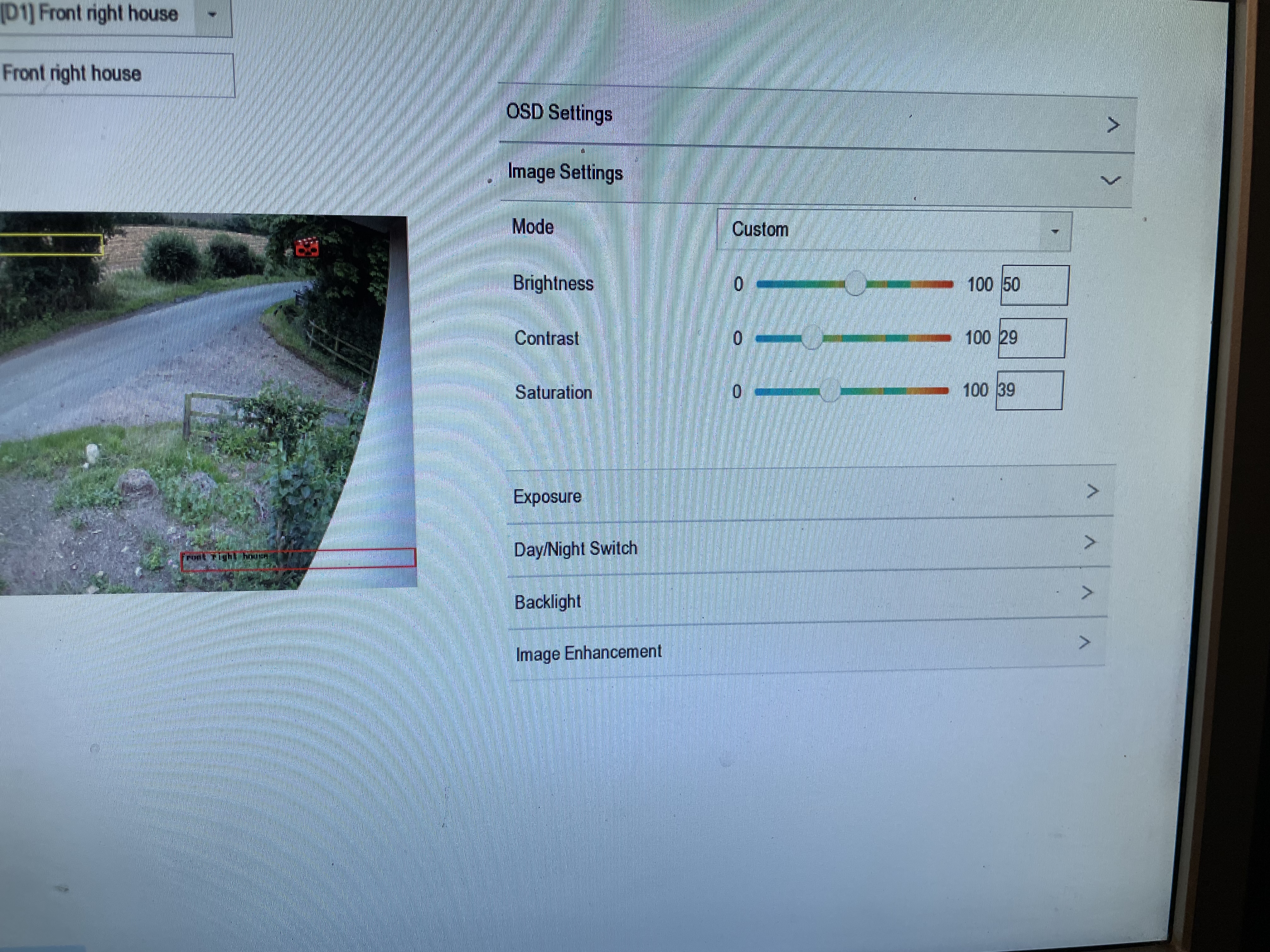

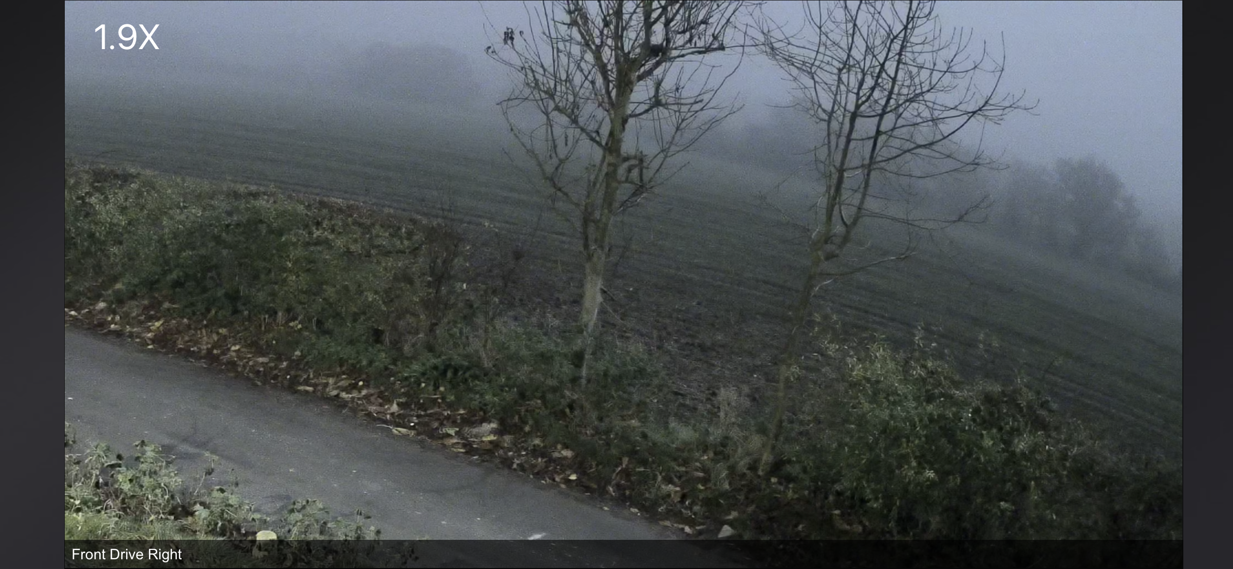

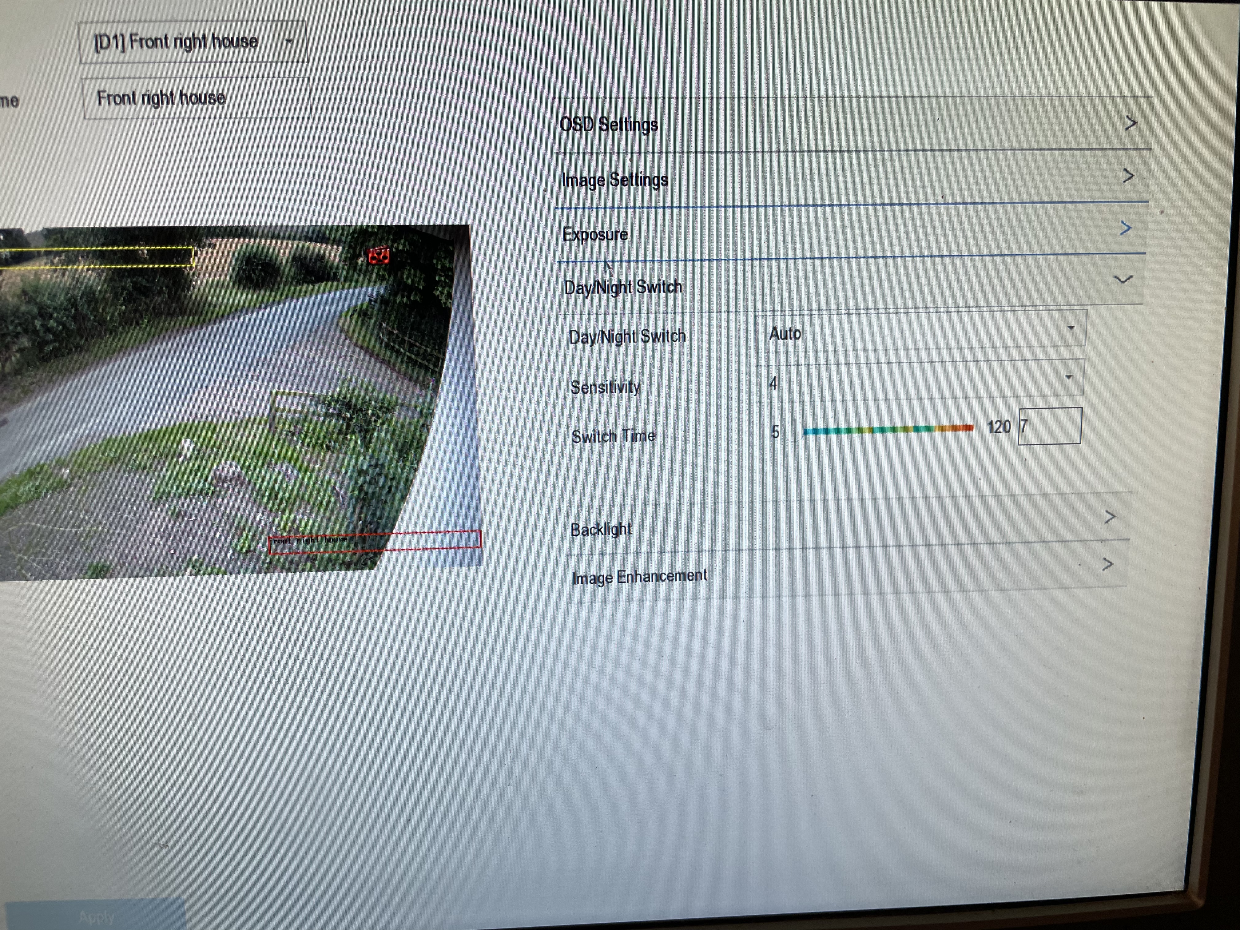

(Quite) A few suggestions as there are a few things that are immediately apparent looking at your settings etc:
Prove it is recording the main stream audio by using playback on the NVR directly. It may be that when playing back the clip that you've exported from the NVR that the audio is not being decoded by the player. I need to experiment with that myself, as I had similar issue some time ago with audio being missing on exported footage when played back.
That is the correct operation. It is a bit annoying as there's additional clicks/touches required in the app to start the audio but it is correct. Audio via the NVR is just that - it's for using a microphone/speaker connected directly to the NVR audio input/output as opposed to from an audio capable IP camera.
Your exposure time of 1/25 sec is too slow to freeze motion. It is a capped minimum, so it will only go as slow as 1/25 sec if needed but it certainly will use that in lower light. You can adjust that to 1/50 sec or 1/100 sec but then you will also affect the image in low light. Each time you halve the exposure time, you halve the amount of light reaching the sensor. ANPR shouldn't be necessary - why do you have a need to capture a passing cars numberplate.
Settings that you've shown:
Sub stream - use H264 for that stream and constant bit rate (less processing). I'd keep the frame rate down to 12 frames per second, medium for quality rather than highest and the bit rate down to 512 or 768 maximum. The sub stream is used for remote viewing only, most probably on your small phone screen rather than a 75" TV!. Keeping it at H264 with a lower frame rate and bit rate and set to constant, medium quality, you'll get a far better connection while on mobile data, as there's less to process. The settings you have are just going to bog down the mobile connection and the first thing that will drop is your audio.
Main stream - you have it set to constant bit rate, it should be on variable (opposite of sub stream). Variable will use the bit rate according to the amount of motion in the image. You'll see with constant that the picture quality will degrade when there's more activity in the image. Do you need full frame? If not, drop it down so that the available bit rate is used more effectively across less frames. 15 or even 12 frames per second should be plenty. Drop the quality from highest to higher. The bit rate will otherwise burst above the settings considerably in normal use.
Exposure - as mentioned further up. If you need to be able to get a reasonable still of someone at walking pace, this will need to be at 1/50 sec or even 1/100 sec

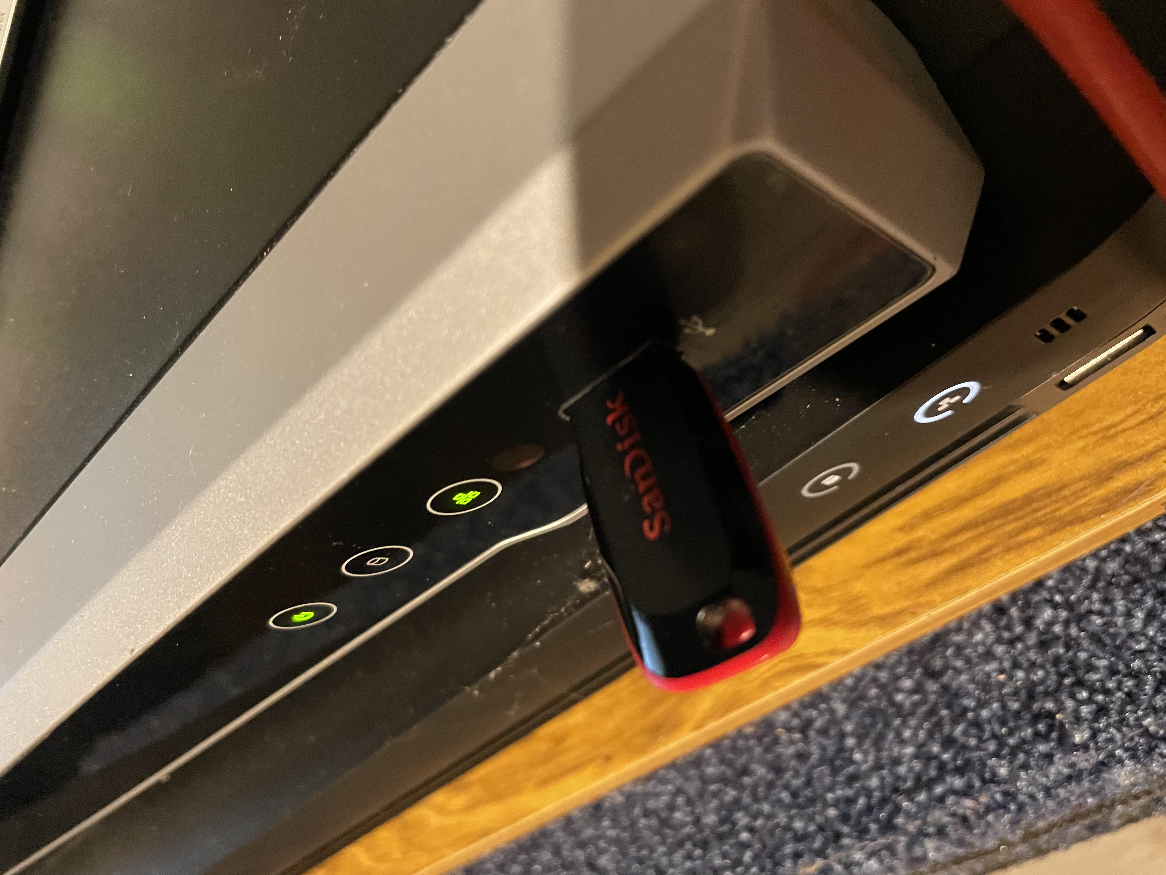

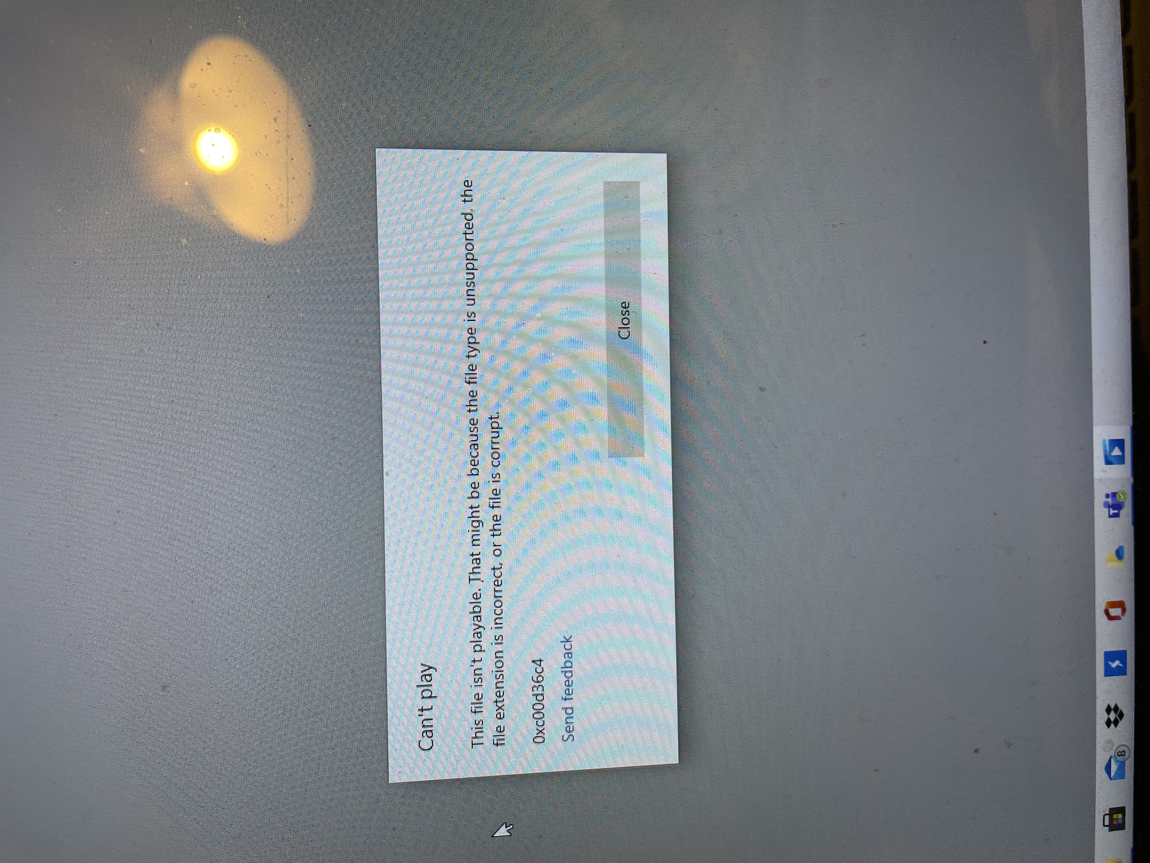

So today I had more travellers passing by, they had been all over land at a neighbours again.
I've spent best part of an hour trying to pull the footage from the DVR, to a stick. It hasn’t worked. How on earth guys who fit this stuff for living put up with constant problems with this stuff I don’t know. There’s no consistency, Wednesday I pulled footage from the same NVR to the same memory stick and got it playing on the same laptop. This evening doing exactly the same I can’t!
I’m getting to the point where I’m gonna pay someone to come in and sanity check the settings, before I start going hammer and tong at Hik for selling stuff with gapping errors, not being able to quickly pull down footage on to a USB is fundamental for a CCTV system.
We don't! I've not had problems exporting to USB before. I'd usually export to USB for short clips only. I find it easier to to just use a web browser to connect with and record a clip directly from playback, or export a larger chunk directly to PC/Mac. From your image you're maybe trying to play back the file with an application that doesn't have the required Codec to playback the Hikvision file. It will work with Hikvisions own VS Player or VLC. You can export the player with the video clip to USB.

So an update. Down to just one POC camera now, all the others have been replaced for 4K IP. I’ve finally got my hands on the 4K colourvu turrets, the image is amazing! The night view over fields in front of my house through the cameras is clear as day, at well over 200m. The attached image is just low moonlight at midnight last night on a slight zoom
Following 2hours with a paid pro looking at the system remotely I’ve had some real progress made in terms of sorting out the audio, image quality and playback (most of the time). The UI on the web browser looks great. I have the button enabled to speed up playback in HikConnect, which I didn’t have before. A lot to be happy about, and money well spent.
However, when I got my first acusense cam 6months ago, it worked perfectly. Only triggered notifications when a car, or person came in to anywhere with the cams view. I started screwing about with image setting and it never worked right thereafter.
I asked the guy yesterday to config it the way it was from new, which he did. Unfortunately it still doesn’t work properly. Sends out notifications at random times, no consistency now. Missed multiple cars and people passing it all day, but got a limited number. All I want the thing to do, is notify me everytime a car, or person comes past it 24/7, like it did when new.
In addition, ahead of his remote log in, I fitted 3 additional 4K IPs. One on the front, I asked for an area to be marked and set for people entering. This seems to work fairly well so far.
I’ve 2 more cams covering side and rear, wanted them detecting people only anywhere in shot, and sod all from either in terms of notifications. These haven’t had me mess about with them either, fitted and let the guy config them.

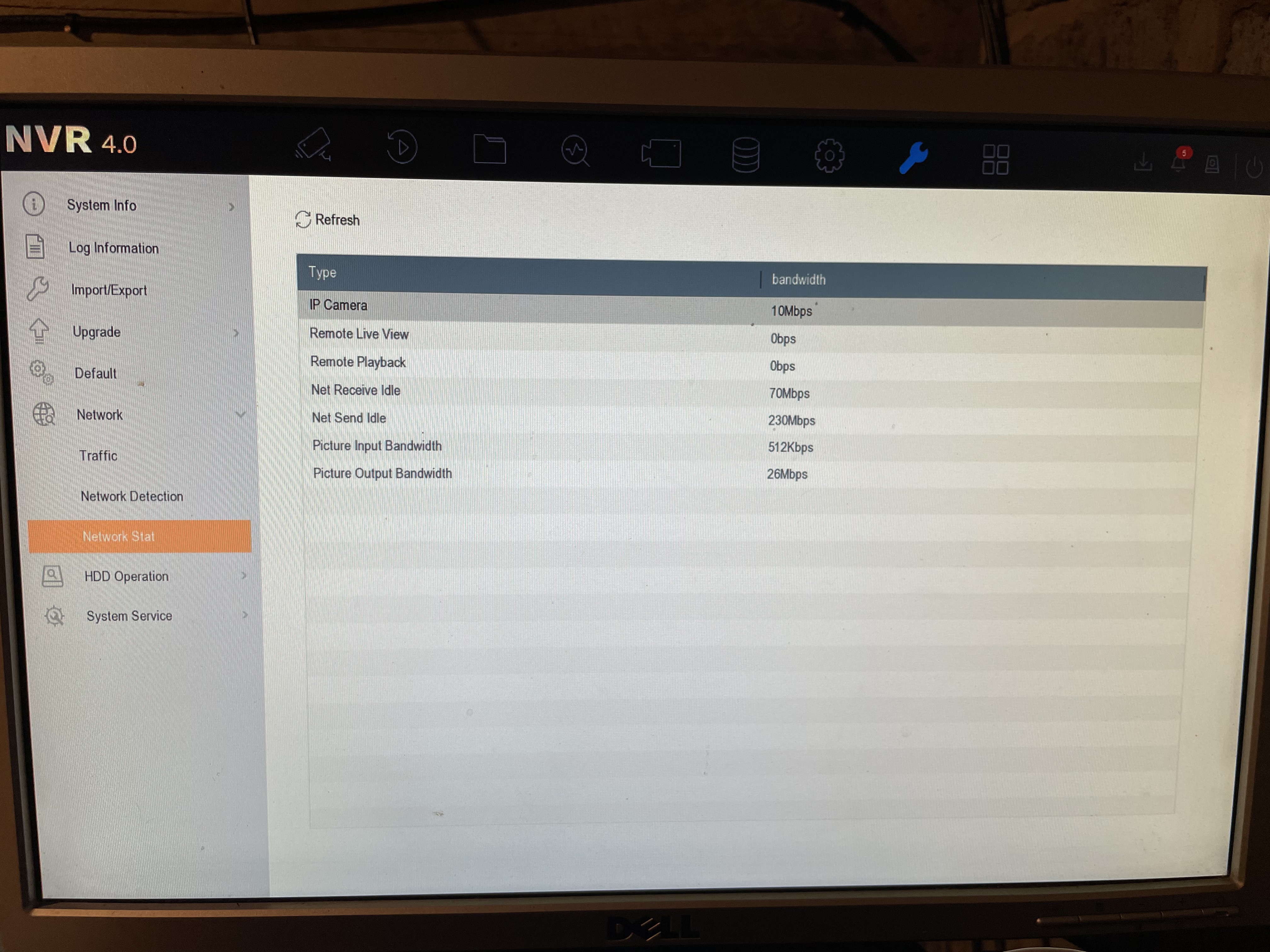

Having taking the worthwhile advise and getting a pro to look at it, I’m now somewhat at a loss as to where I should go next. It was noted the EE 4G network on the DLink DWR921 router could be causing some issues. There were conflicts in a couple of the boxes in the network section on the NVR
I don’t wanna keep chucking money at trying to set the Hik stuff, if this router or network isn’t right.
The fact there were port conflicts it would stand to reason that it would cause some issues. But to the same degree my POC system(being phased out for IP), which sits on the same router literally sends them out for fun. Surely I’d have same issues with that if router was that wack?
I have crap wired internet, and EE are the only 4g network who can offer stable coverage so have little choice for remote viewing. Any ideas where I go from here
