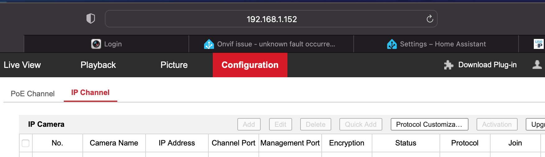

My ip for my system is 192.168.1.152 on the basis thats how i log in to it (screen shot)

I can get to this but assume this is not right
Hi @mbarnes - that's right, you need to turn off encryption for the RTSP stream to work.
It's not as clear as it should be, but untick the "verification code" box in your screenshot, which will turn it off and hopefully get things working.
