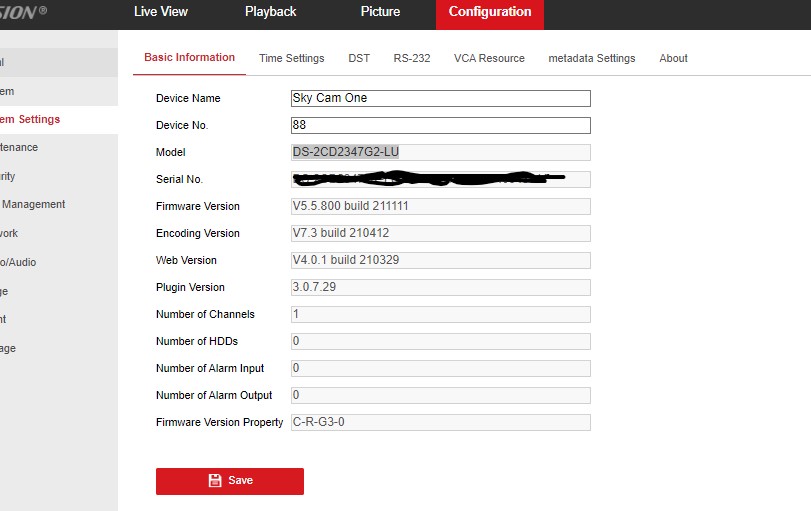

I have two Hikvision DS-2CD2347G2-LU cameras, Last year I upgraded my first one with RTMP firmware from the Uk Hikvision Portal

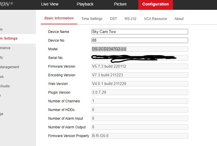

Today I bought a second camera, When trying to upgrade with the same firmware it fails.
Please see screenshot from cam one and cam two (attached)
I have downloaded the latest firmaware for the second cam direclty from Hikvision but still fails to upgrade. Any help would be great.

Hi @Paul2021
Since you purchased your first camera Hikvision has released a new version of many of the AcuSense/ColorVu cameras, these new models are labelled with a (C) and support a different firmware to the original generation of cameras.
You will see in your above screenshots that the Firmware Version Property is G3 for your old model and G5 for your newer model, this signifies the firmware that the camera uses and so your new model will use the G5 RTMP firmware which is v5.7.1

What firmware version is your camera currently running? Can you confirm the 'Firmware Version Property' of your camera? (like the screenshots above, you'll find this information under System > Basic Information)
@Dan
Currently the camera is running the V5.7.12 build 230131. The Firmware Version Property is B-R-G5-0. We downloaded the latest firmware, but it doesn't support RTMP.
Hi @osolares
Unfortunately, the RTMP feature is only supported on the custom v5.7.1 firmware and recently Hikvision has made it clear to us that their latest releases of the baseline firmware (e.g. v5.7.12) cannot be downgraded to this custom firmware.
Basically, they are saying that RTMP is no longer supported by the G5 cameras.
We are as frustrated as you probably are with this development because Hikvision had been heavily promoting this RTMP solution and then without any warning to us or customers they have stopped supporting it.
The only solution they have given me is that they can offer to RMA the camera back to their technical team for them to perform a serial degrading on the camera to allow the custom firmware to be installed, but you would need to do this via the authorised Hikvision seller you bought the cameras from.
