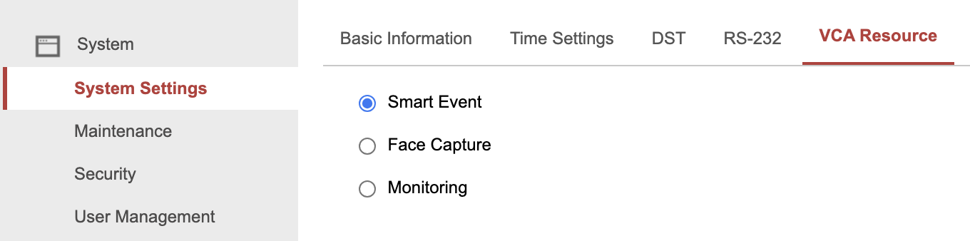

We have minimal experience with the consumer HiLook products, but can you access the below menu when logged into your HiLook camera?
If you can see this menu, is the camera set to Smart Event or Monitoring? The camera needs to be set to monitoring for you to be able to enable the rotate/corridor mode.
If you can't see this menu on your camera, then that probably means that these entry-level HiLook cameras don't support rotate/corridor mode (maybe speak to the supplier you bought them from as they've probably got more experience with HiLook products).
Hi Dan, thank you for the reply.
Unfortunately the VCA Resource option is not present in my system settings.

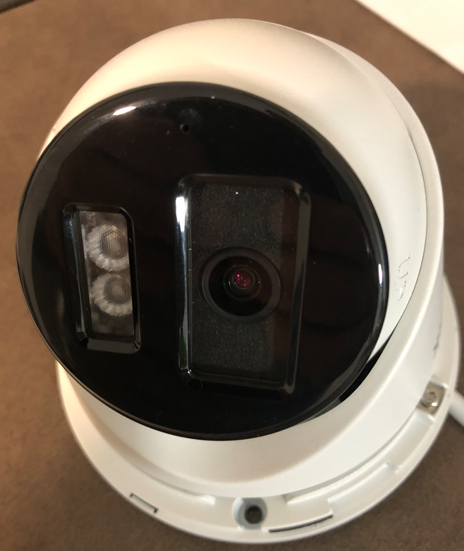

Hi @JB1970 ,
I unmounted my camera and opened up the housing so I could flip the lens to portrait.
Unfortunately the internal hardware of the camera does not allow this. (I think because the HilookIPC-T283H-MU is a budget camera)
So as an alternative I just rotated the entire ball itself as seen in my attached picture.
My question is, by doing what I did, will this mess up the camera performance such as the IR because those 2 little lights are next to the lens as opposed to underneath it?
I have since viewed the image with the NVR and it seems to be ok during night/day.
That should be fine and is what I meant when I said to rotate the camera.
