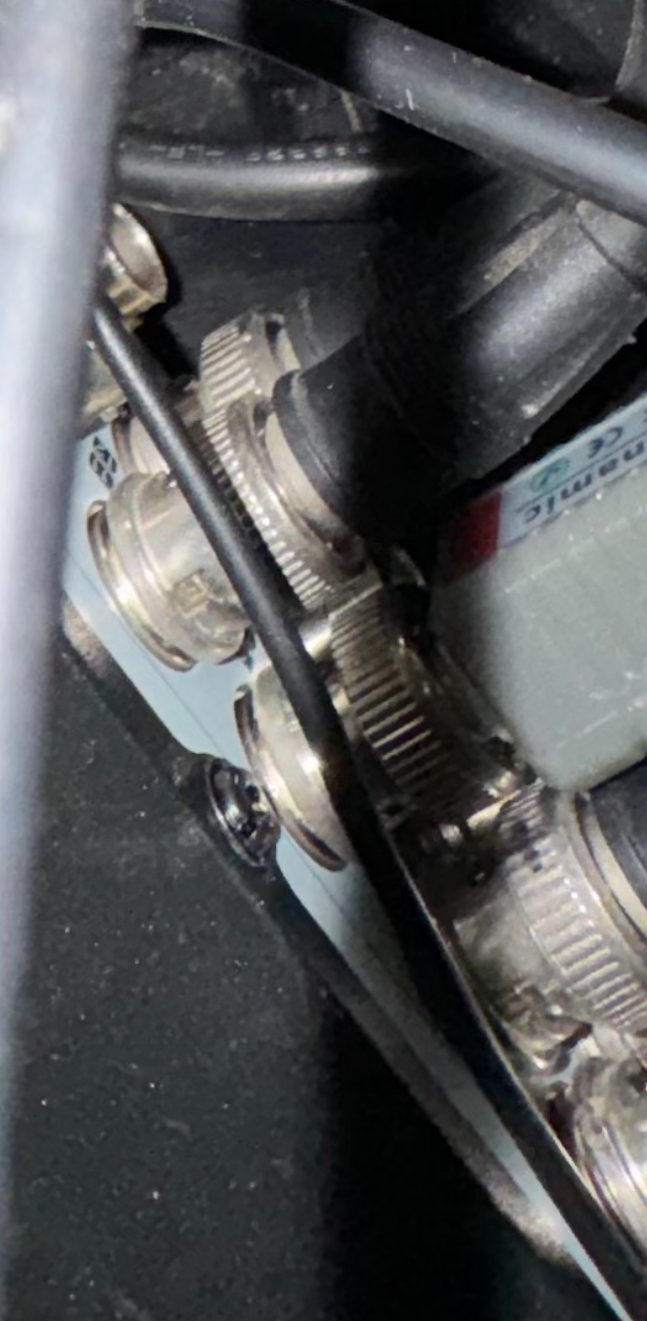

That’s disappointing, how easy is it to remove all the feeds? They don’t just pull out?
I could get a tipex pen and label so they don’t get mixed up? Does that even matter when putting it back?
Hi @Sarah
Those cables are using standard Coaxial connectors so you just need to twist the connector from its locked to unlocked position and then you should be able to pull the connectors out.
We have minimal hands-on experience with analog/COAX cameras & DVRs so I'm not sure whether a cable going to a specific port is important or not, to be safe we would recommend labelling the cables as you remove them so you can reconnect them to the same ports.
