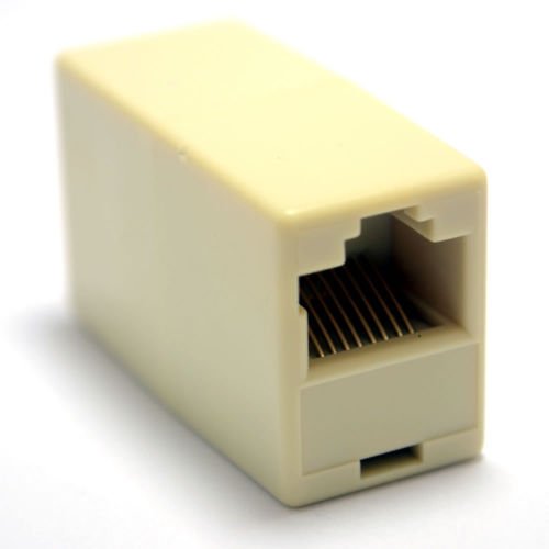

I did mine slightly differently and put a standard RJ45 plug on the camera end and used a cheap coupler I had knocking about similar to the one below.

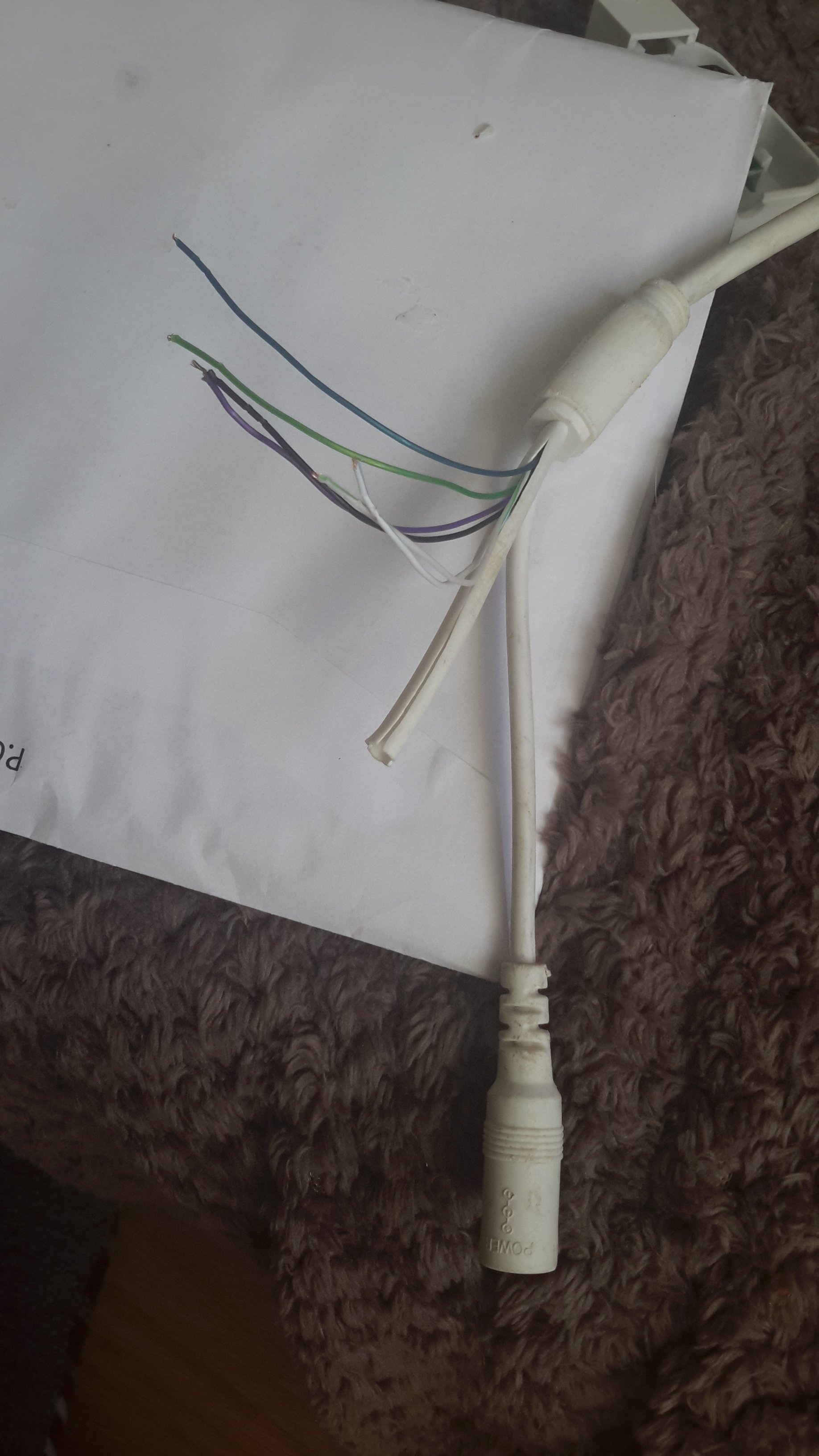

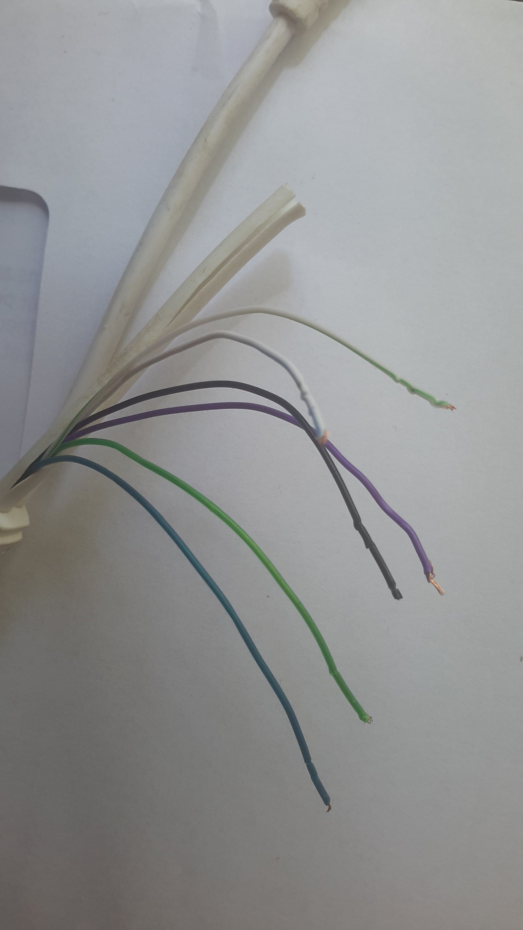

Hi , could someone please help I have a FreddI cctv and I have cut through the cable I bought a new ethernet box but the colours are different with no reference on line , the colours are purple ,black , green, blue, green/white and blue/white,
Thank you Tim

Sorry, you'd need to contact the manufacturer for their colour code.
I did and they said I need to contact a electronic expert :D
If you still have the part with the plug attached, you could find someone who owns a multi-meter & knows how to use it.
They would be able to easily trace the 8 pins to their colours.
Phil.

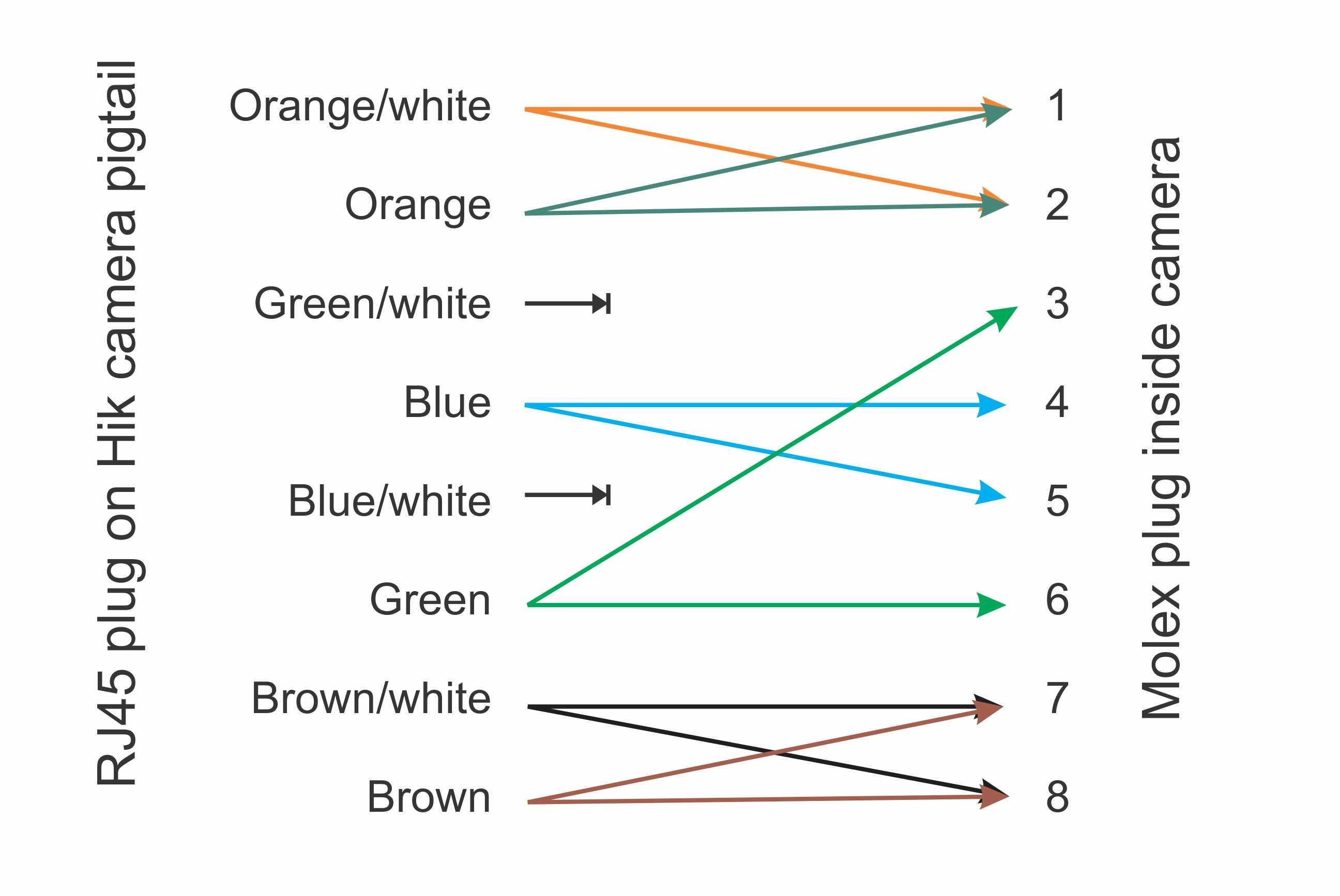

I have a Hik dome (Chinese version, I am in the Philippines) DS-2CD3335-i, mfg in 2016, that does not play well with our system. It works a bit and then goes off and sometimes the Cisco POE switch disables the port (for some obscure reason)
The wiring of the pigtail seems really weird to me. Here's a drawing of the connection from the RJ45 end and the molex plug end.
Does this wiring seem right, Green/white & Blue/white are not connected to anything on the molex? I tested it twice to be sure and this is the way it rolls.

Hi MadDogDean,
That does look odd from the point of view of the data connections. A quick thought, does the camera also have a power jack for an external power supply? It might be worth trying that and connecting the camera to a non-PoE switch, just in case the power requirements are different (or faulty).

Hey Ian, thanks for the advice, but I managed to sort it yesterday.
Our camera has a pigtail with an RJ45 and a 12v plug, and it does support PoE. The problem though, as it showed in my drawing was a disconnect on the green/white and blue/white wires. In the molded wire split, there was a bad connect on those two wires. They would only work once in a while when the wire was wiggled "just right".
Long story short, I cut the wire, put a new RJ45 socket and all works like a charm!

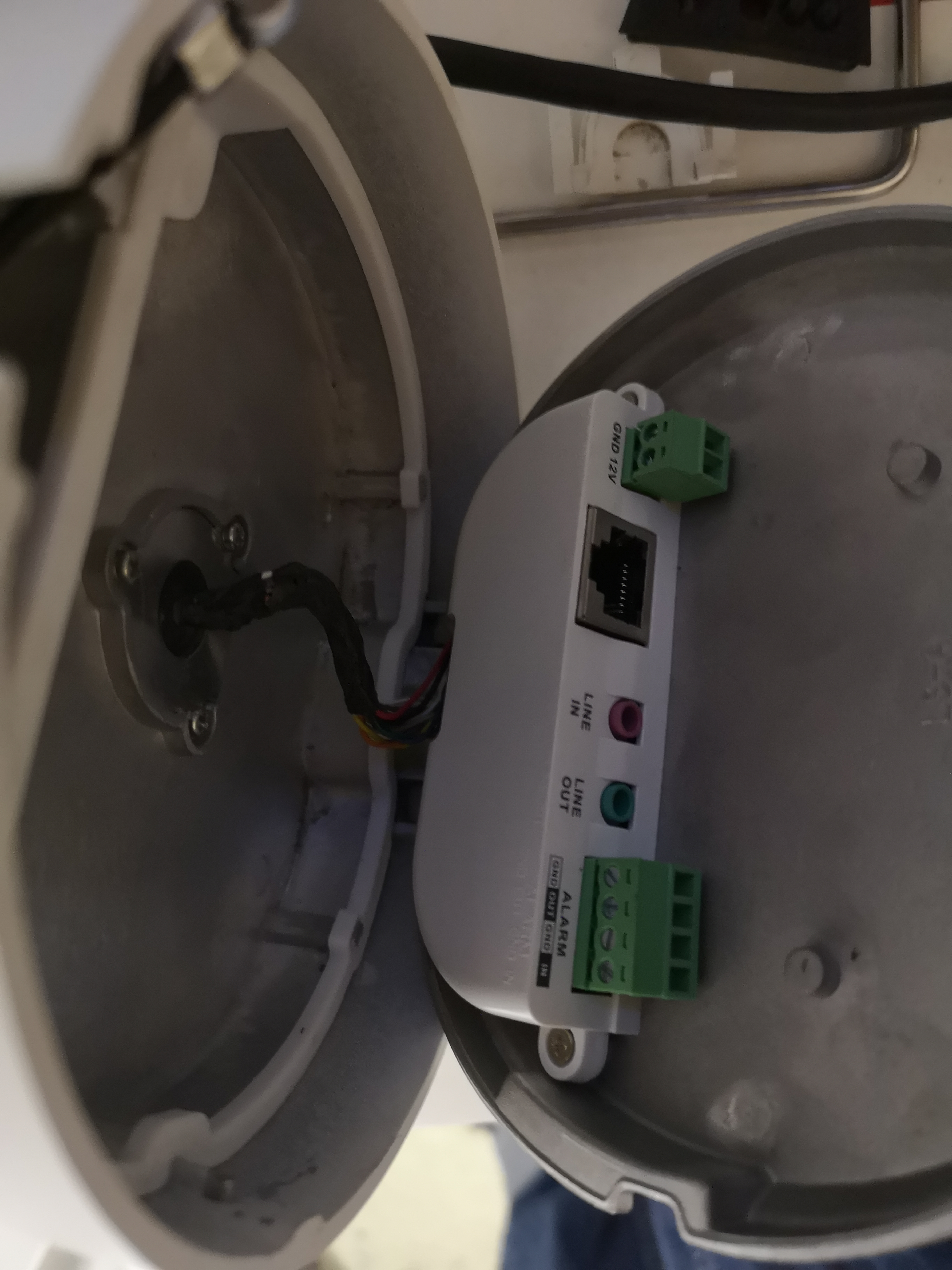

Hi All,
Installed a DS-2CD2H85FWD 4K varifocal turret camera last week, it worked for a day then stopped, seemed a bit damp in the RJ45 socket when I took it down, this camera doesn't have the little pigtail extension cable though, it has a little connector module screwed into the inside of the hinged lid. Has anyone tried to fix one of these or is it possible to buy the connector module anywhere and swap it myself?
Photo attached.

In principle it should be similar. Try removing the two screws holding the ports to the hinge, and see if you can wiggle free the ethernet jack. See what it looks like.
