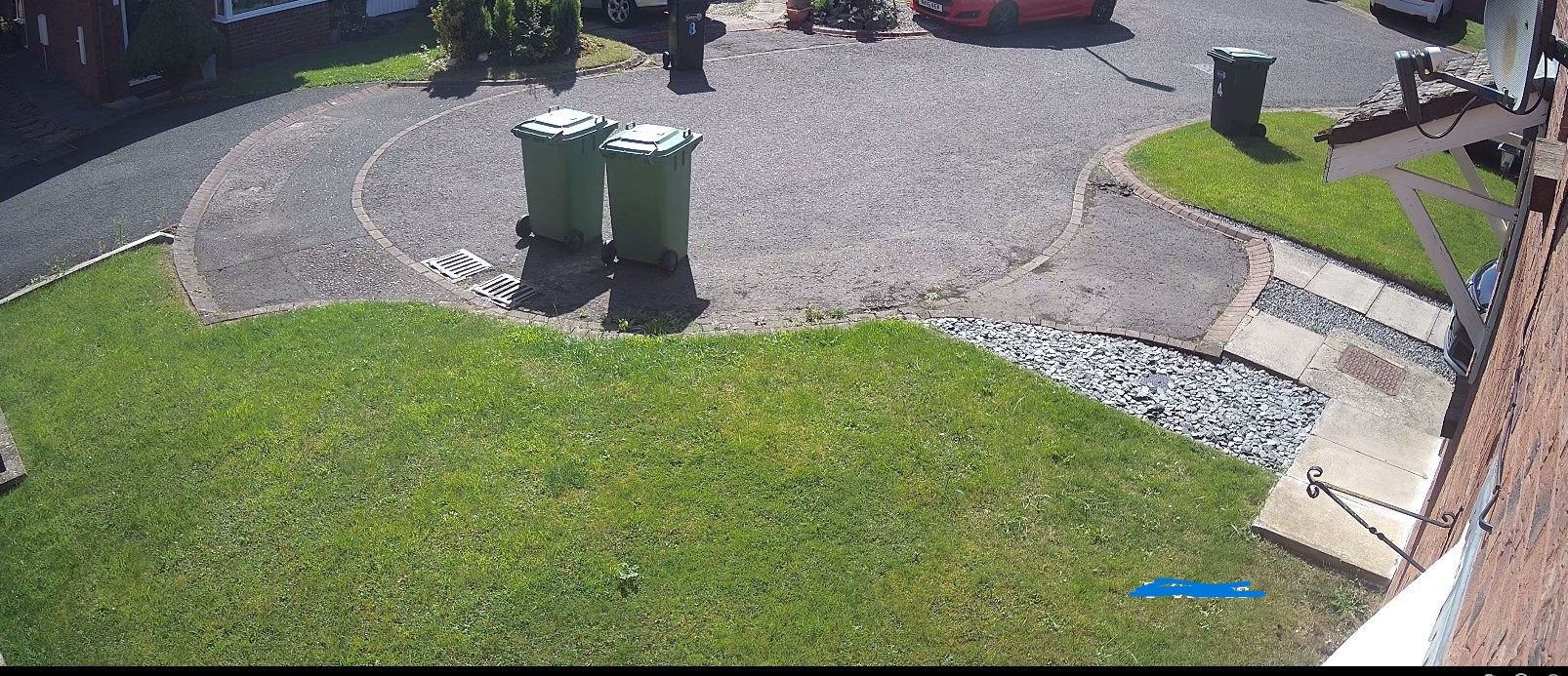

I currently have a DS-2CD2385G1-I 4mm camera with a memory card installed.
It's connected to a PoE switch which we use throughout the home.
It's been very reliable for our court and I share the camera with neighbours via the app share option.
If I were to replace the camera, what HiKvision would you recommend?
I have cut the top from the image for privacy reasons.

Hi @Teasy1980
The direct replacement for the model you currently have would be the DS-2CD2386G2-IU 8MP AcuSense Turret
If you have ambient light illuminating the street (e.g. street lights, security lights on the properties, etc...) you could also consider the DS-2CD2387G2H-LIU 8MP Hybrid Light Turret which can achieve a colour image at night using either its built-in white light or the ambient light in the scene, this model also supports a 'Smart Light' mode where the camera can switch from B&W/IR image to colour/white light image based on smart event triggers.
