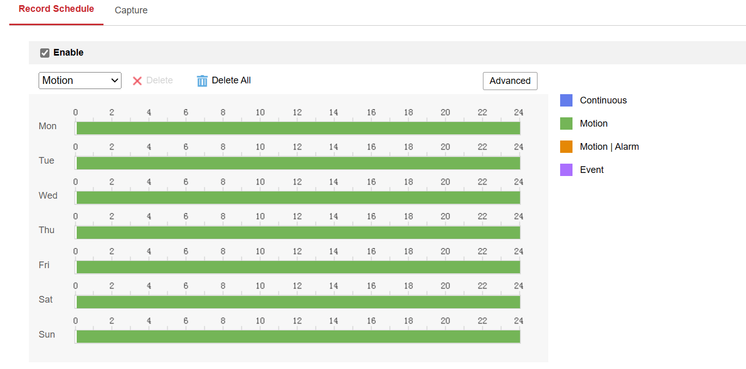

Thanks for testing that - there may be another event enabled that is causing footage to be saved for all types of movement.
Make sure you only have motion detection enabled, as well as one smart event (line crossing or intrusion detection).
Then, in Storage>Schedule Settings>Record Schedule, set the schedule to "motion" for the whole week (so that every day is filled in green), like below:
