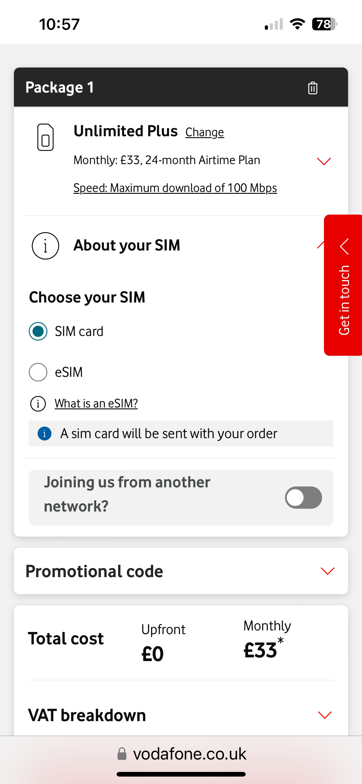

Currently they have an unlimited data sim with a max download of 100mbps at £33 a month inclusive. If it’s a private customer deals can be had via cashback sites to improve the offer further.
