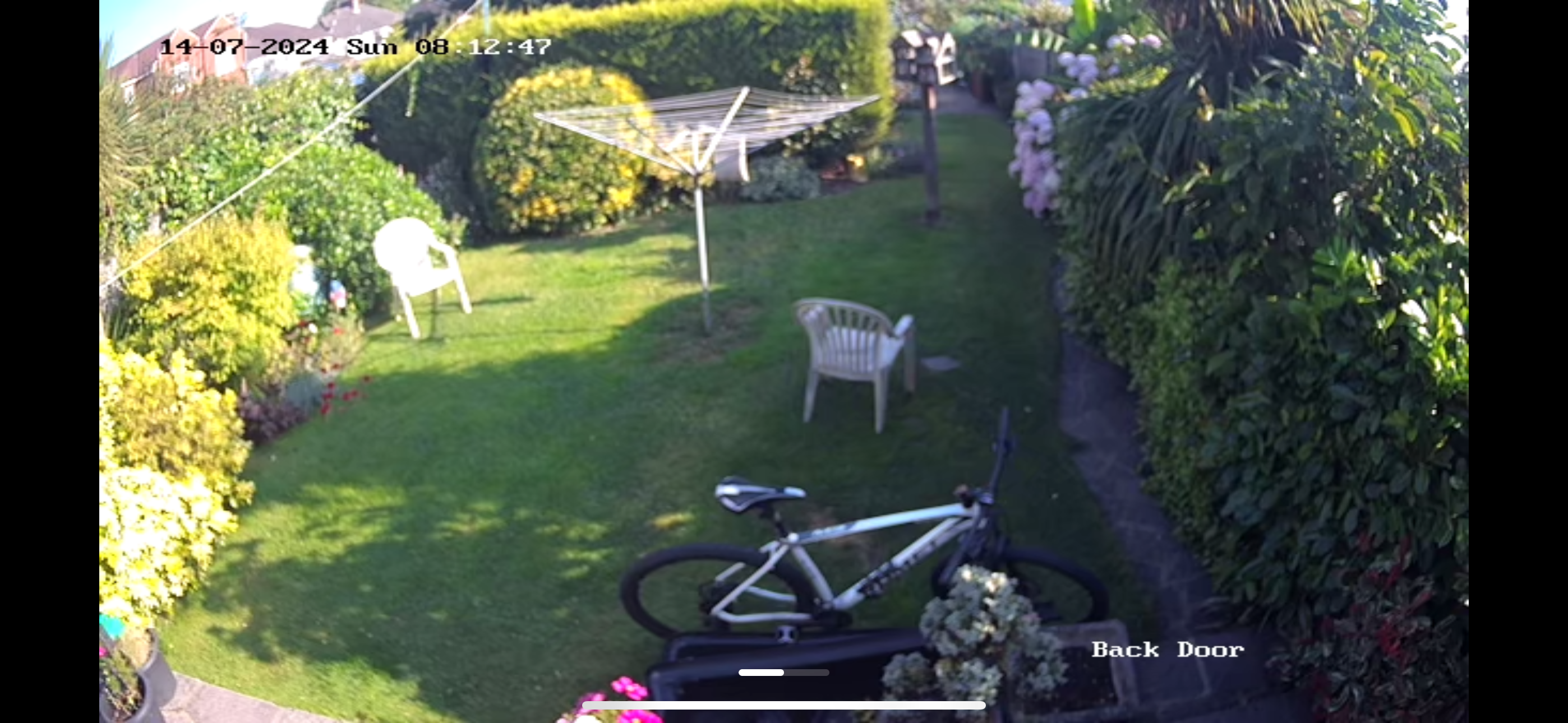

It’s blurry and really not as crisp as it was. The camera is about 7 years old so it’s done its work. Just seems I’ve been having a few problems with the setup over the last couple of years. Had a knock on the door from my next door neighbour that some lowlife at 3:45 was trying his front door so not only did I find one of the cameras blurry but also the NVR hadn’t recorded lots of footage across all the cameras.

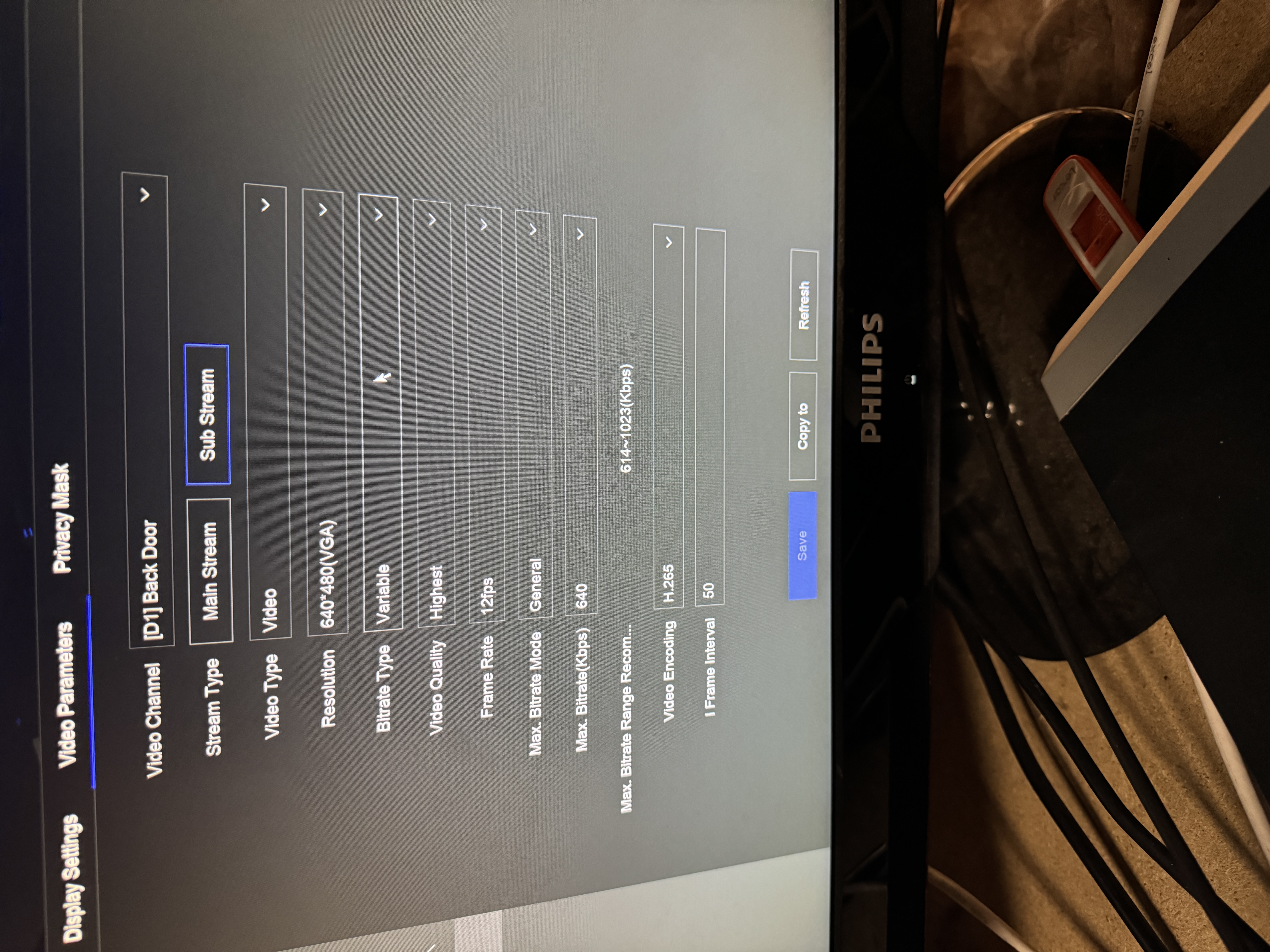

Post a screenshot of your video settings from the NVR (main stream normal, mani stream event and sub stream) for that camera as it looks as though it could be settings related - too low a bit rate for the resolution and frame rate. It does look very poor as though it's the sub stream being viewed.
I thought it was a setting problem but it was ok with the current setting when first put in. So I copied the settings from another camera (have two cameras the same ) and makes no difference. I will pop the settings on later in case I done something stupid

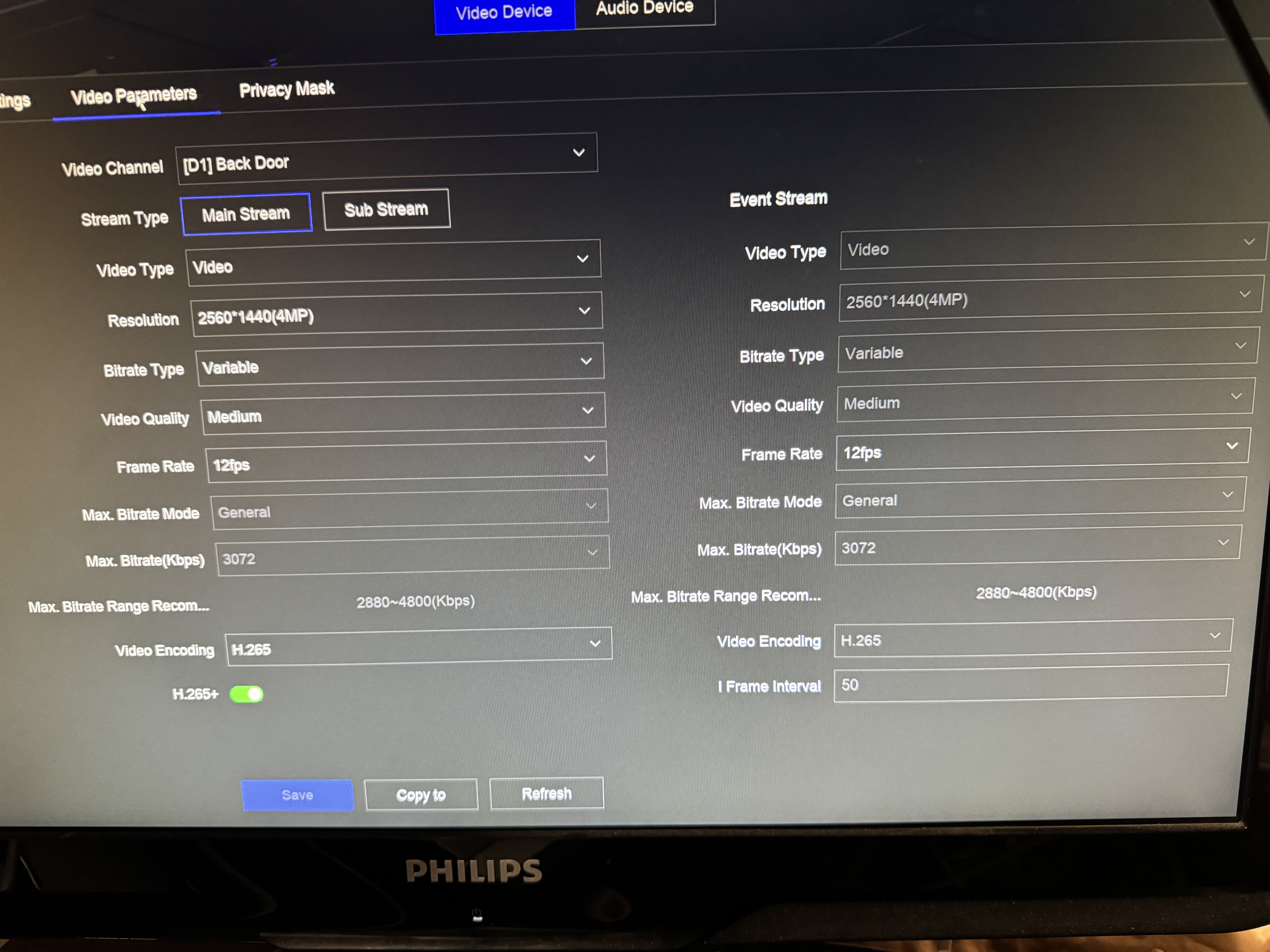

Attached camera setting a
For the main stream (normal and event)
  • Turn off 'plus' for H265
  • Change Quality from Medium to Higher
  • Lower the I Frame to 12
The bit rate can be left at 3072 which is fine for 12FPS H265. The I frame is usually set to refresh every 1 or 2 seconds. At a value of 50 you're only getting a full frame refresh every 4 seconds. Depending on the amount of movement in the scene, the image may appear to deteriorate before clearing every 4 secs. On many versions of NVR/Firmware the I Frame cannot be seen or altered without logging into the camera directly (so often gets overlooked)
Edit: Keep in mind the above settings are for a 4MP camera...your original post says it's a 2385 8MP model and you (appear to) have lowered the resolution. If it is a 2385 and you want to run it at 8MP:
  • Plus turned off
  • Resolution to 3840 x 2160
  • Quality to Higher
  • I Frame to 24 initially (you may be able to lower it to 12 without issue)
  • Bit rate to 6144
Lastly. It's unlikely to be incorrect but go into Storage Schedule > Advanced and ensure that your actually recording the main stream and not the sub stream.
