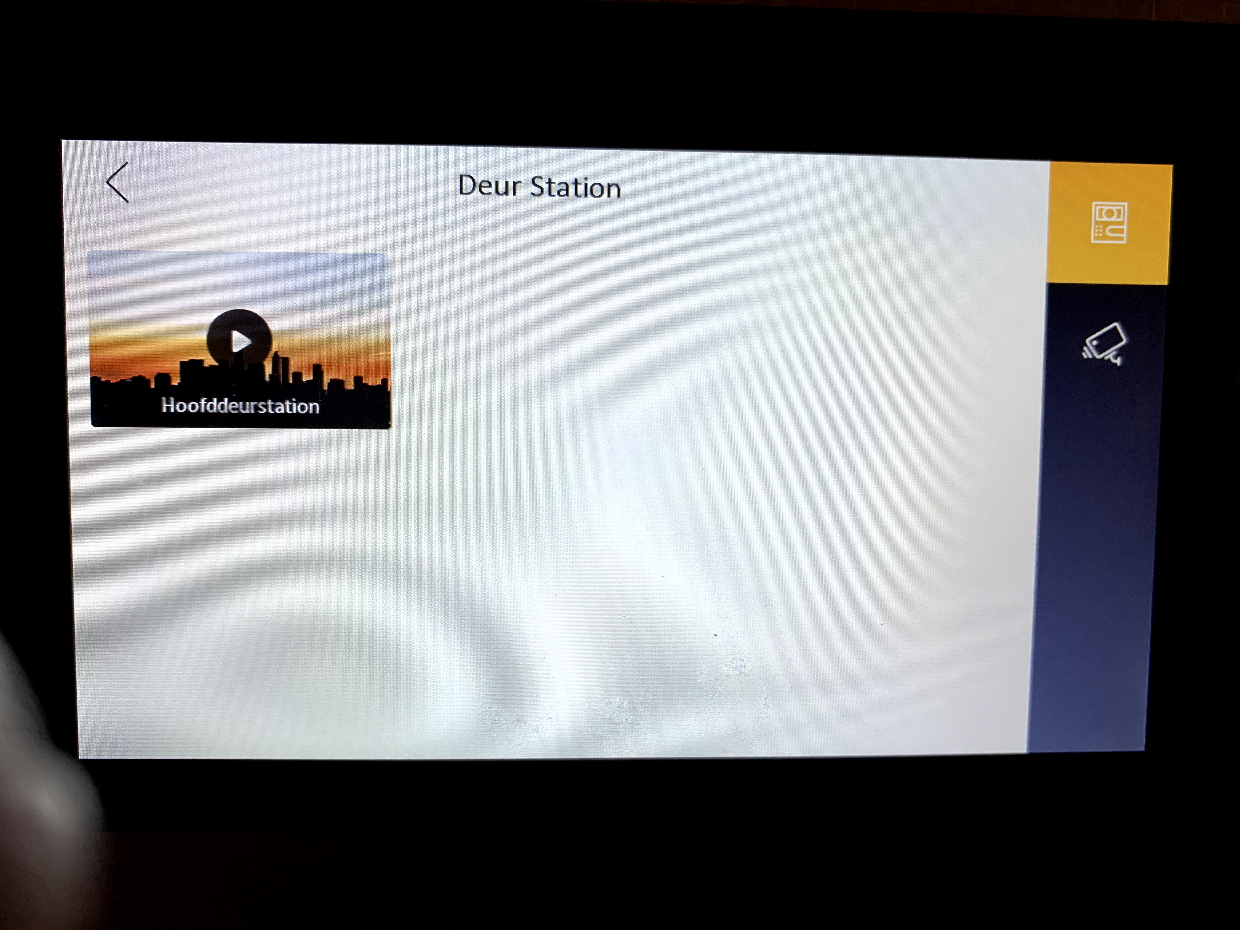

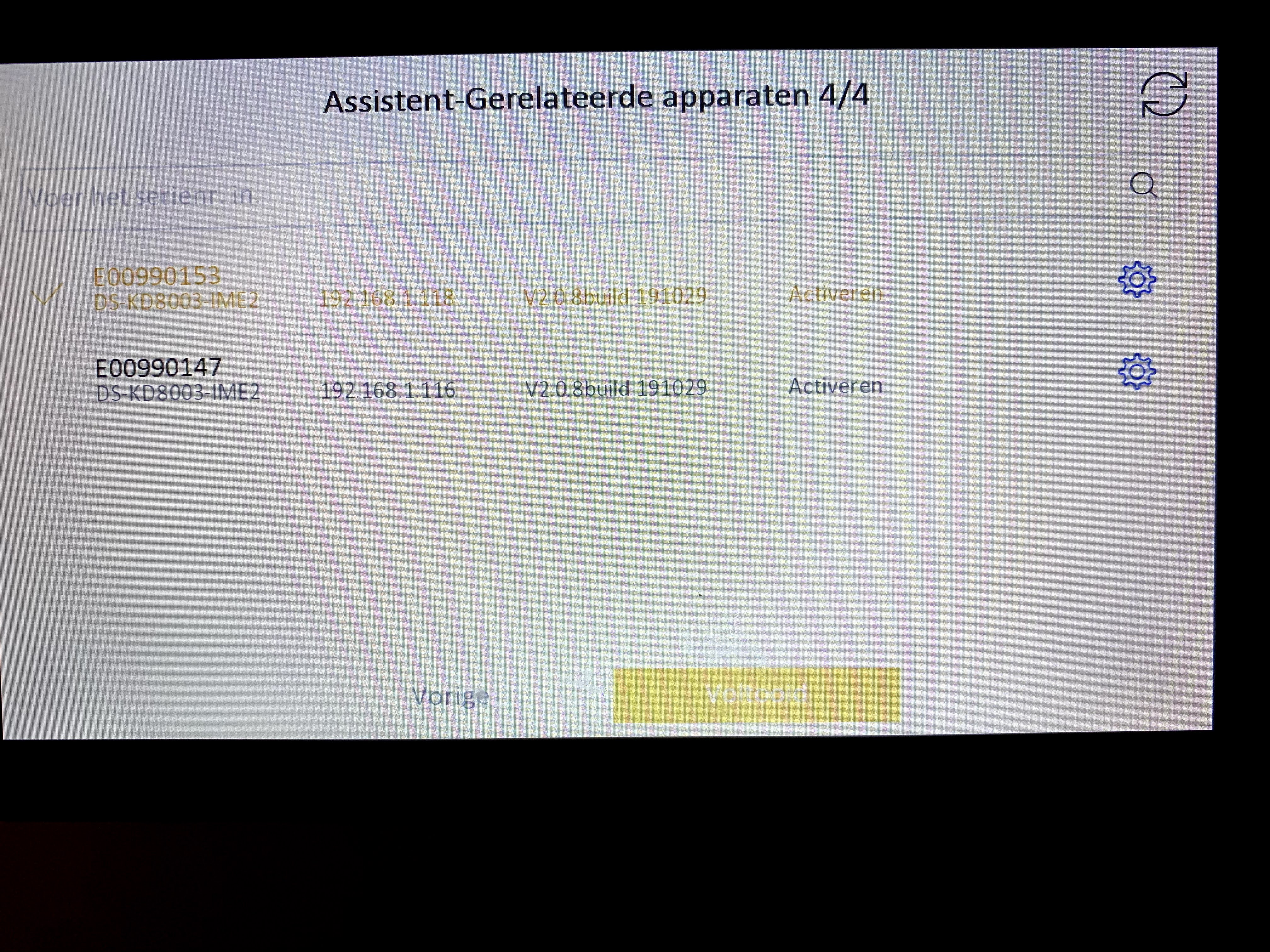

When I start with 1 IS, and connect the first DS, i'm able to activate the DS, can view it on the IS and everything works fine. But when I connect the second OS and I run the configuration setup on the IS again I see two DS which I can activate (
) But I can oly activate one. And when I have done this the result is that I only see one DS on the IS. (When I connected the other two IS, the display only one DS
When someone rings on the first DS, the (two of the IS rings, and you can answer the call) When someone ring on the second DS you'll here 'calling failed).
So even when I connect the third one I get the same problems, only 1 DS will work.

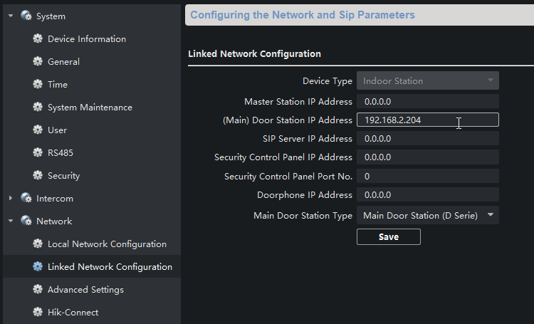

It doesn't matter, KAD706 is just like regular network switch. You congifure what outdoor calls which indoor using and programming IP adress.
On every indoor unit under " (Main) Door station IP address" you enter IP address of outdoor unit you want to receive call from.
Only important thing is that outdoor unit needs to be connected to port 6 ( and additional one on one of free ports).

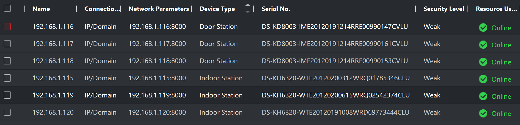

First KAD is connected to network. Alle devices are visible in IVMS:

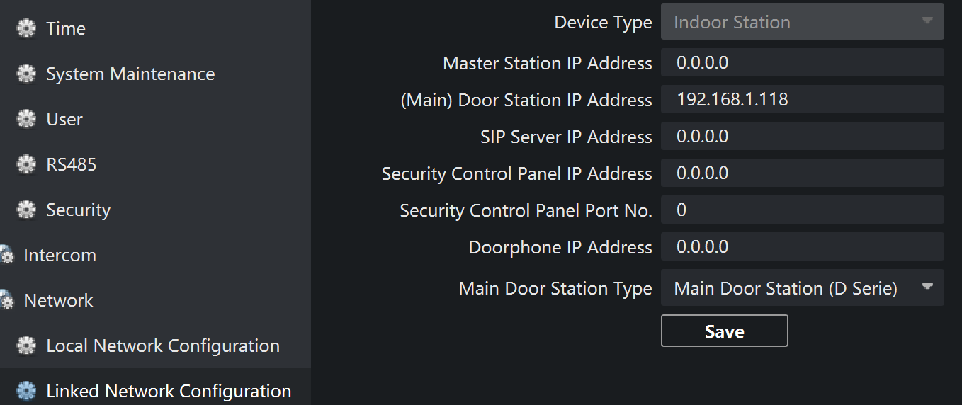

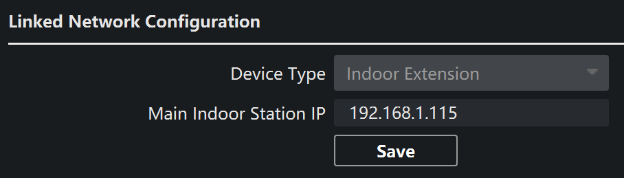

Programmed 192.168.1.115 as main indoor station, and the other two .120 and .119 as indoor extension and let them point to 192.168.1.115
When I configure 192.168.1.119 also as a main indoor station, i'm able to configure another outdoor station (.118)
When I ring this door station, only this indoor station rings...
On the main indoor I only see one camera (the main outdoorcamera)

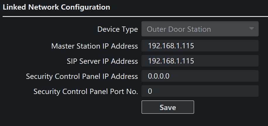

Tried to configure .118 as
outer door station. Butt nothing seems to work...
Do you see something what i'm doing wrong??? I can't create the 'link' in the system.

I found the attached Instruction regarding Door Station & Door Phone Configuration that appears to be on the lines of what you are attempting to achieve, however i can't tell you if it is 2-Wire or IP based or if the settings shown are available with your set up. None-The-Less no harm in trying....
Tonyhaa
Thank you very much! I believe this is working.
