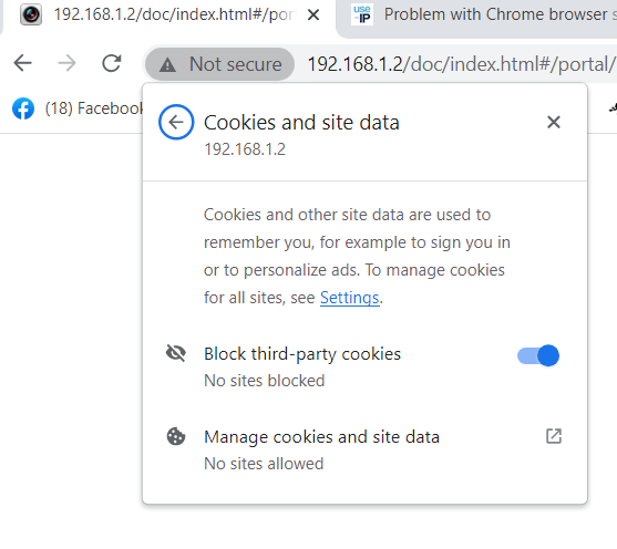

I tried this already. I now have the warning triangle and "Not secure". There is no cookies or data for this site.

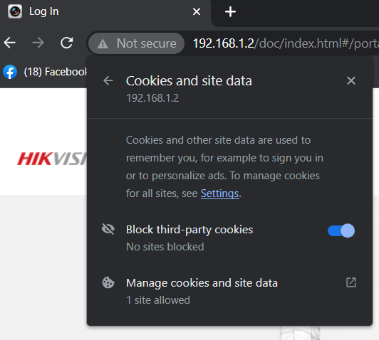

Here are screenshots from Chrome and then Incognito mode Chrome.
The frrst says No sites allowed.

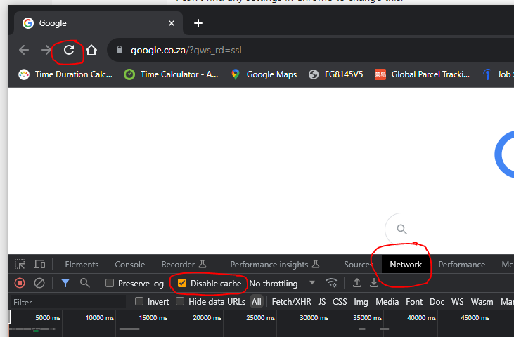

I also had that issue when upgrading the firmware of my NVR. What solved it for me was to open that webpage, then click F12 (on windows, don't know how to do it on Mac) > Go to the network tab > you should a checkbox that says "Disable cache", check it then click the reload button on the top and that solved it.
After doing that, you won't have to do it again. Hope that helps!
Thanks for this tip, this seem to have solved another small issue I have been having too with a message saying "Failed to stop playback...". Before I had to restart the whole computer to get rid of it and to continue watching playbacks, now I could just reload the webpage in chrome and it was gone!
