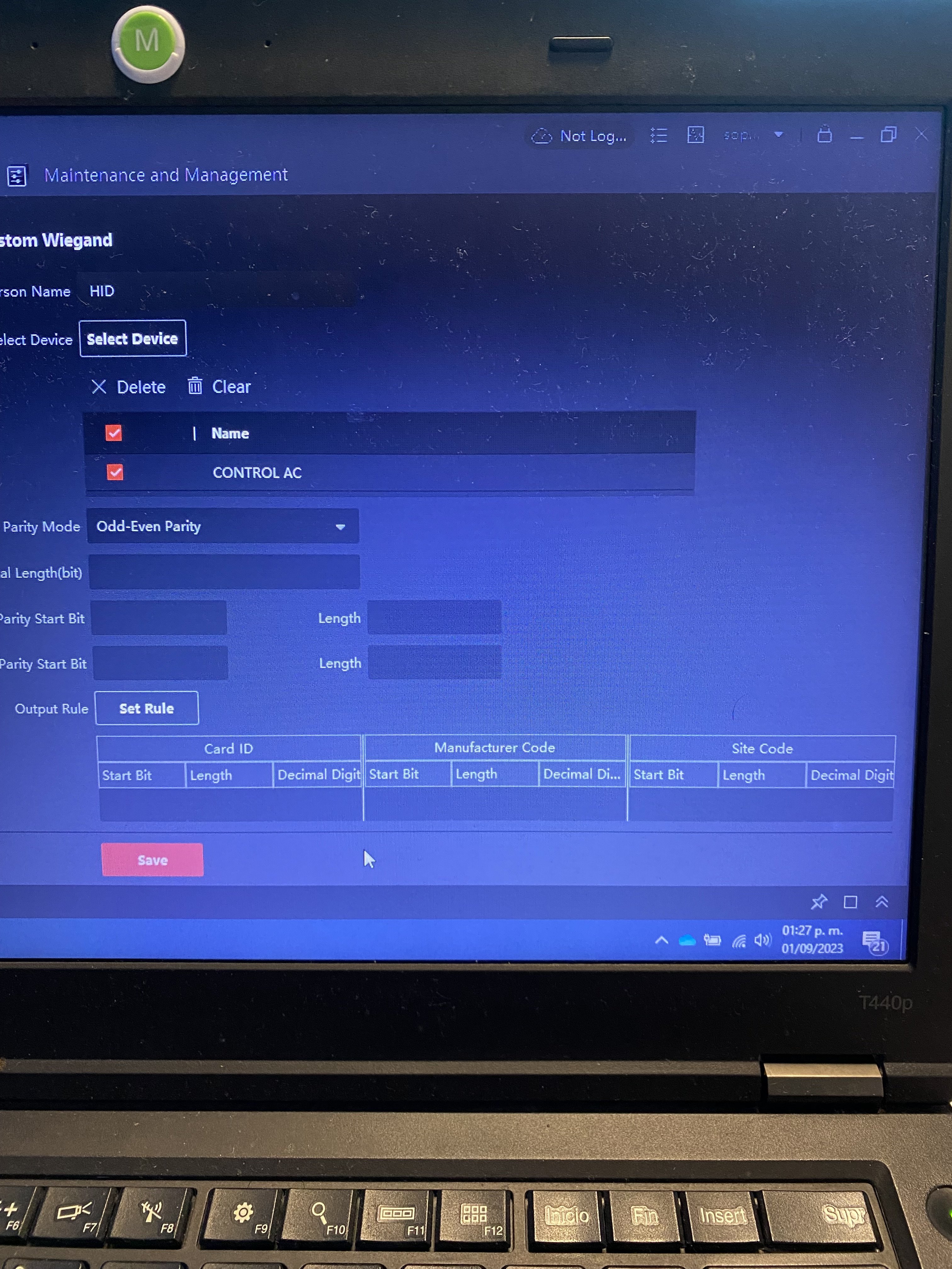

Hi, you set wiegand correctly? Wiegand 26/34 in controller is correctly set? It will beep because it has power and you use right card frequency. But it doesn't mean it commnunicate with controller.
I am uncertain about this matter. Hikvision AC does offer the functionality to establish a custom Wiegand configuration; however, I am unsure which parameters should be set for 26-bit 009P cards.
