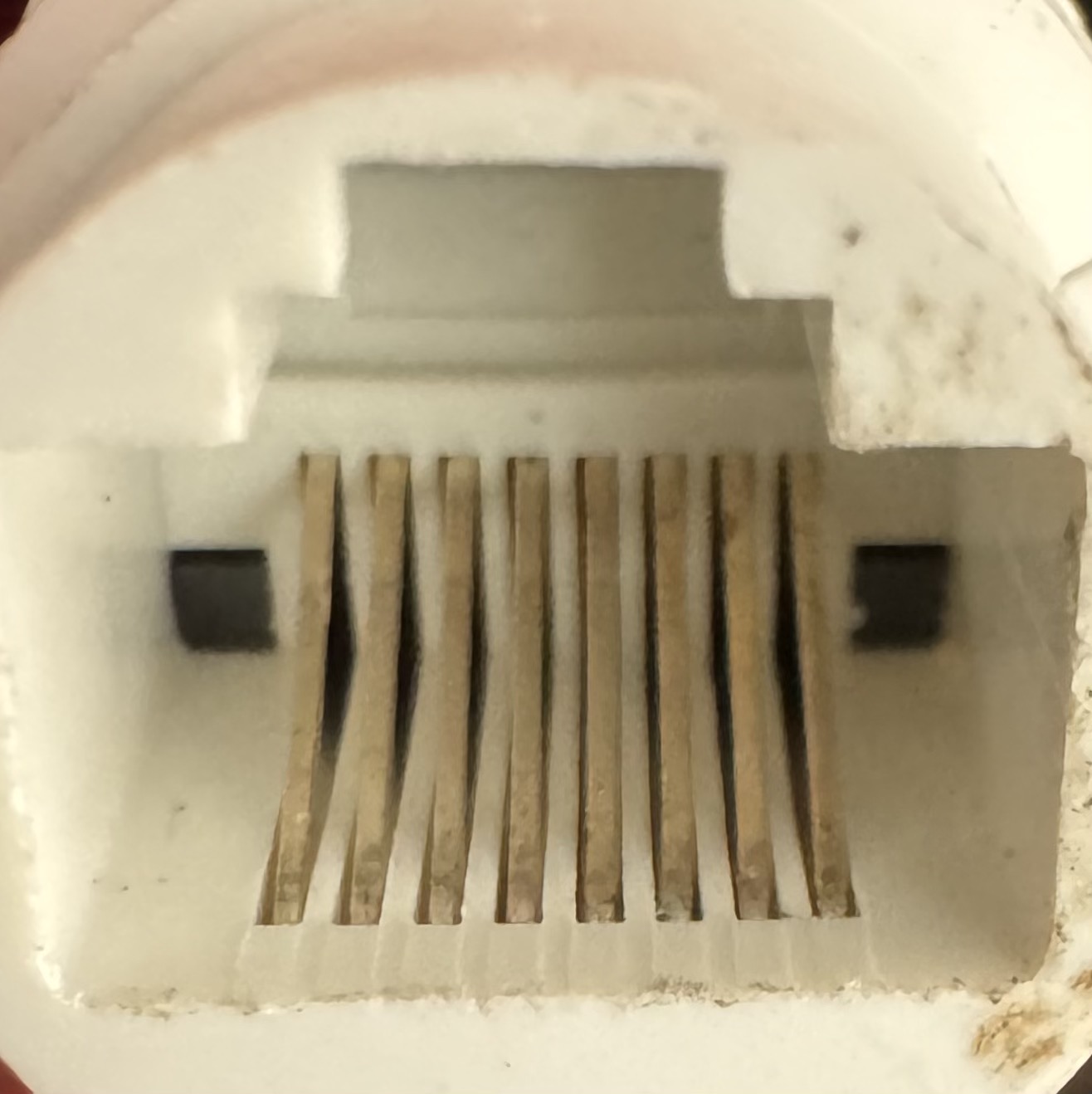

Take a look in the RJ45 socket where the cable connects to; are the pins free of corrosion? A common issue when the connection is not correctly weatherproofed is that moisture damages the pins. It only takes a tiny amount to short the power pins and cause damage. If there's no visible damage the camera may be faulty. I have had one similar failure where the camera would work normally but only while connected to 12V DC and the camera was replaced by my supplier.
Hi... the utp socket pins has no corrosion on them. At least they look that they are in nearly perfect condition... so do you think is camera issue? I forgot to tell you that was operative for about 3 years. It's not a new camera that it may have manufacture failure.
That connection looks fine. Power it up using 12V and connect it to the network switch. You’ll possibly find that it works normally. There is (or used to be) a tiny voltage converter sealed inside the cable harness where the cable splits into network and 12V. Perhaps that failed. There’s not much you can do other than use it with a separate 12V DC supply if that works.

At the end it was just the utp female clip that causing the issue. We cut and replace it with a new one and is working.
