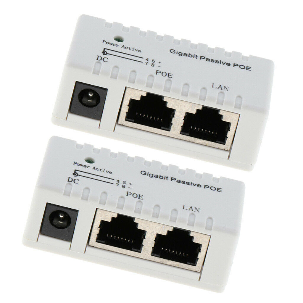

I will install a 12v solar panel with a battery and controller. ok passive poe as in the picture for hikvision ip cam? so I go direct from the regulator to the poe with plug?

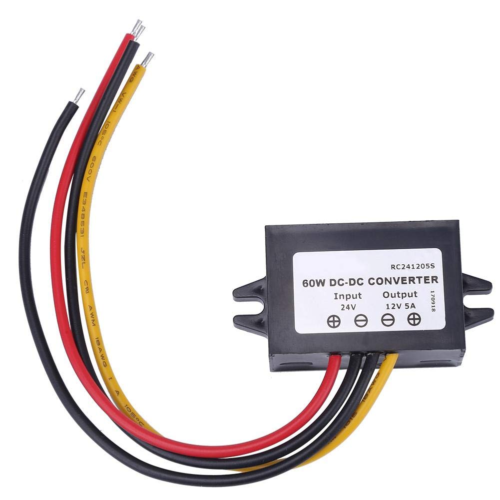

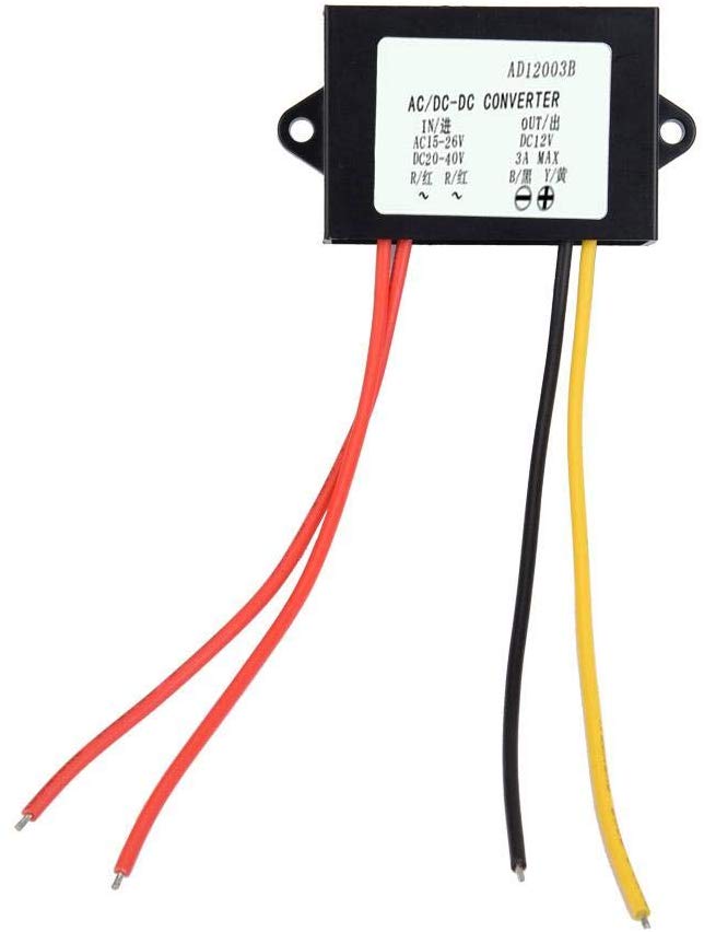

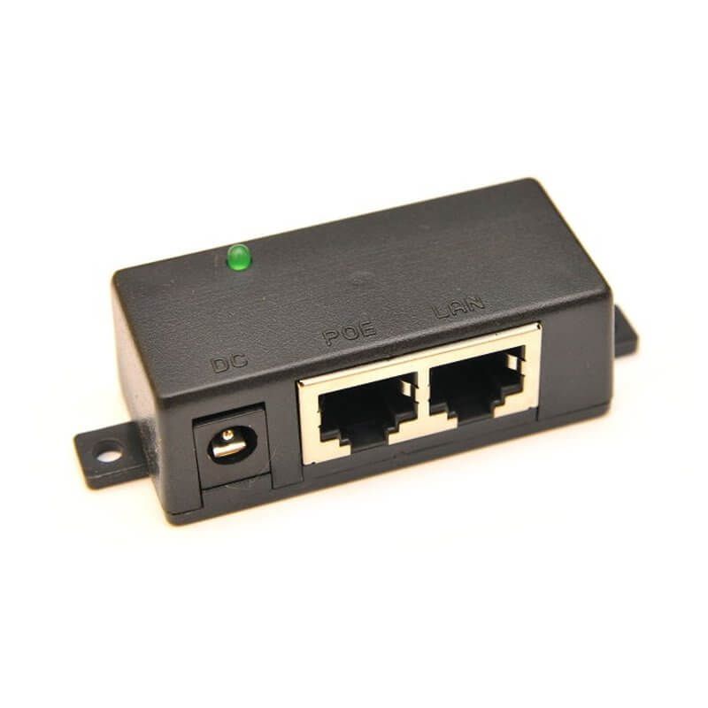

do you think if I use an injector like the one in the picture, and I feed the hikvision camera via the 24v poe of the regulator, does it work or do i damage? or I can put a 24v to 12v stepdown converter as in the picture and I have to solder a connector that I connect to the poe injector to the 12v output

can anyone tell me if it works by feeding the camera via injector as above?
You will need to use a POE injector which conforms to the IEEE 802.3af/at standard.
Due to this, the cameras expect the POE carrier voltage to be 35-57 volts.
This higher voltage is used so that longer cables can be used without devices suffering due to volt drop i.e. POE can run up to 100m.
The camera will receive a POE supply at that higher level and its internal electronics will reduce it to the 12 volts that it needs.
I hope you are right I think I use 24 cc to 12 cc module. I tried to power the camera from the 2 batteries of 12v in series then 24v but it does not turn on. or use an 802 af 12v switch maybe it might work
