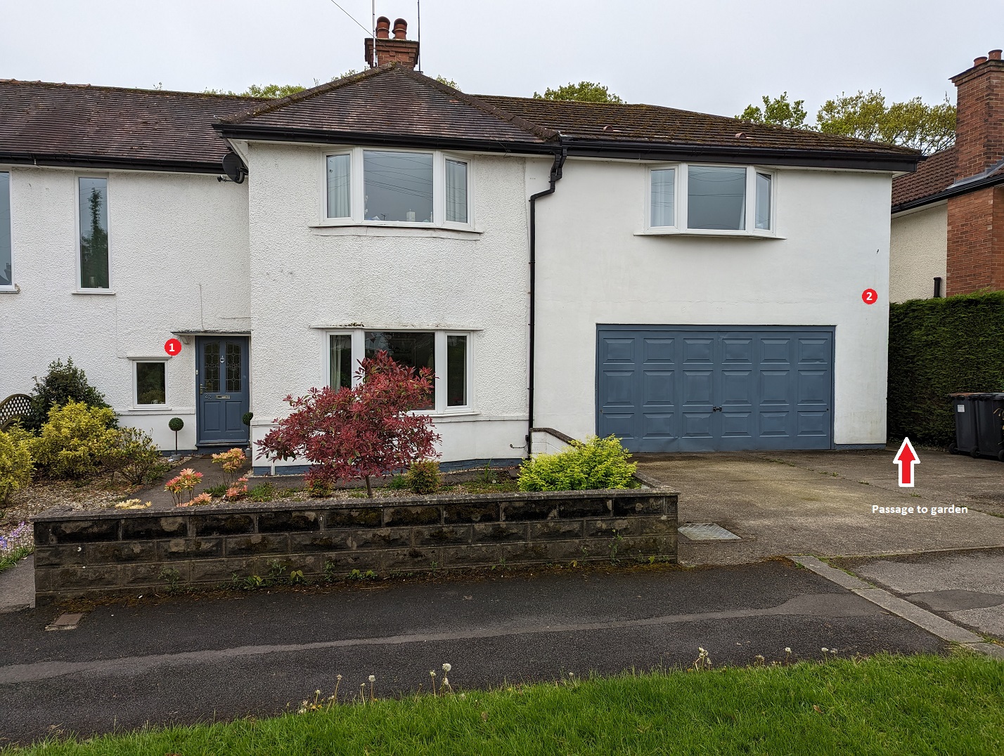

Camera 1 - Front door - DS-2CD2347G2-LSU/SL (I hope there is enough ambient light for ColorVu!) and assume 2.8mm?
Camera 2 - Car parking (in front of garage) - DS-2CD2347G2-LSU/SL and 2.8mm? Or is 2.8mm going to be too wide?

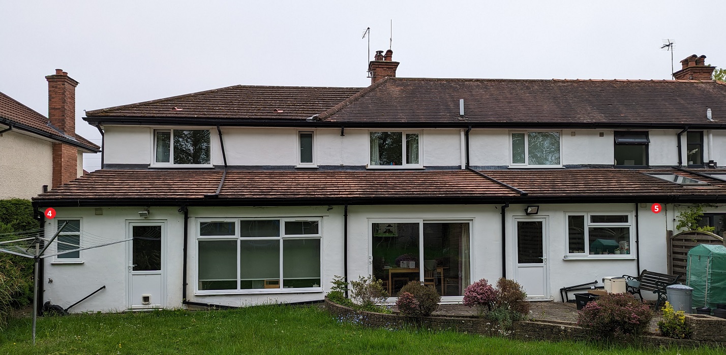

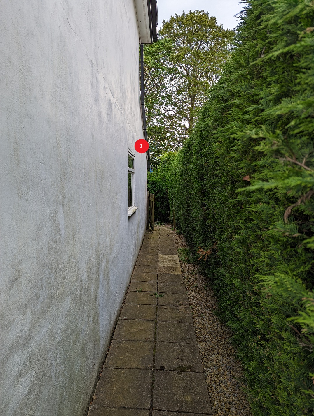

Camera 3 - Side Alley - DS-2CD2346G2-ISU/SL for the infra red. 4mm maybe instead of 2.5mm? But would I be better with a bullet as I need to be tight into the wall to cover this narrow space?
Cameras 4 & 5 - DS-2CD2346G2-ISU/SL for the infra red. Mounted under soffit covering both sides of the ground floor plus a section of the garden. 2.8mm or 4mm?

Hi @montydon
Your plan makes sense, 2.8mm will be a good choice for covering the large open areas in front & behind the property, the narrower 4mm option will work better down the side of the property.
The areas you need to cover are not massive so I think you will get enough detail from 4MP and so 8MP is not absolutely required.
We would recommend buying one AcuSense model and one ColorVu model and then try them out in some of the above positions to see if they work for what you want.

How high up the wall do you recommend I mount the cameras at (1 - front door), (2 - drive) and (3 - alley)?
From reading other posts on the forum it sounds like around 2m might be good for face capture, but want to check with the expert!
Hi @montydon
the positions you have marked on your images look okay to me, for positions 1 & 3 we would recommend around head height (2m/2.5m) because these areas are where people will be close to the camera and if you go too high you will start missing facial detail and just capture the top of peoples heads.
For position 3 you would probably be best off going a little bit higher (3m) to avoid any reflection/glare of the shiny roof of cars parked underneath the camera on the drive.
