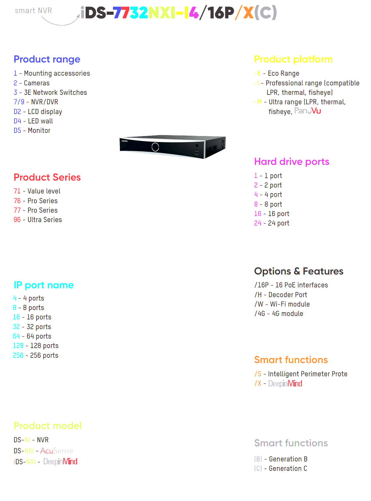

Thank you. What would the 's" mean in DS-7732NXI-I4/16P/S?
I have worked out the 77 is the later model, 32 is number of cameras it can take, NXI os the acusense body recognition and IP cams, I4 is 4 SATA drives, 16P is 16 x POE slots, but S remains a mystery.
It's not necessarily a later model but the 77 have a higher specification over the 76 models. All 77 (I, K, M, Q) models seem use the deeper chassis with 4 SATA ports.
I'm not sure. S in the camera models often refers to alarm inputs. I don't pay too much attention to the model codes and will always look at the specs in the data sheets for differences between models.
The '/S' stands for "Intelligent Perimeter Prote", according to Hikvision's latest Product Quick Guide.
I have attached the page which shows you what each part of the NVRs product code means so you can have a look at it.
It's not massively clear what it means but our understanding is that the '/S' has to do with the NVR having AcuSense built in and is just Hikvision doubling up on it being shown in the product code.
Hikvision also does this with the number of hard drives you can have in the NVR with the difference between the '76' and '77' being that the 76 can hold 2 hard drives and the 77 can hold 4.
