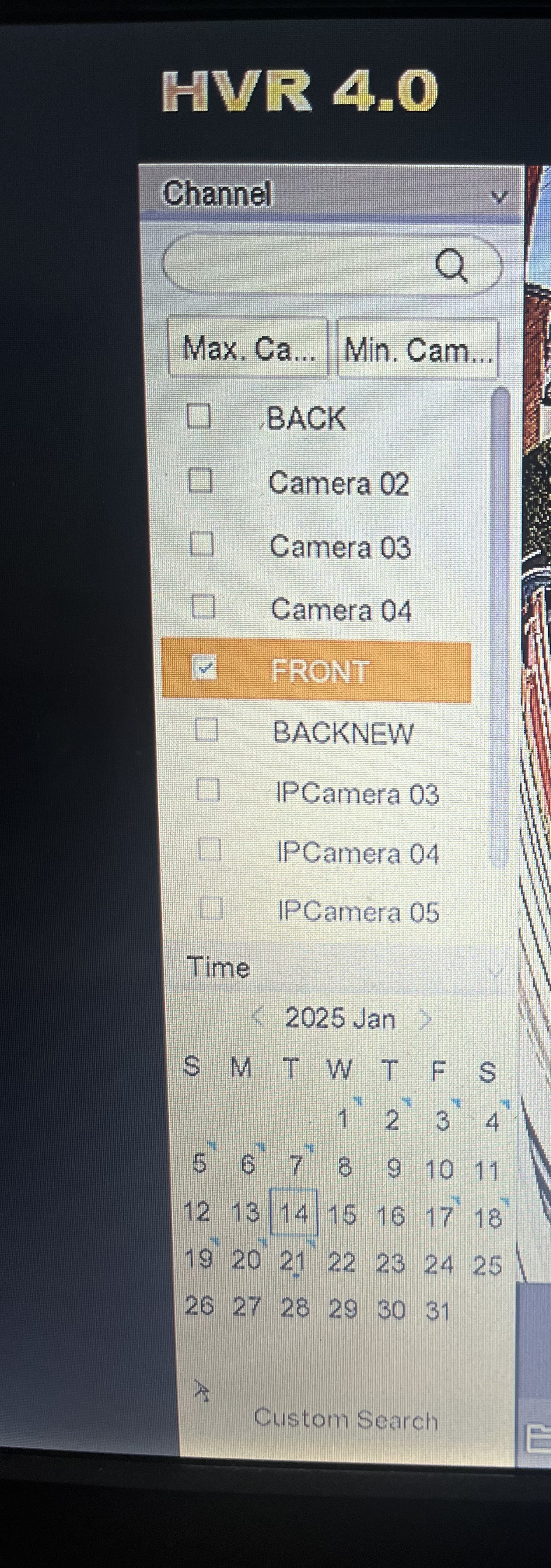

My issue is I can’t seem to playback from certain days from the DVR? Either directly on the console or via the web portal.

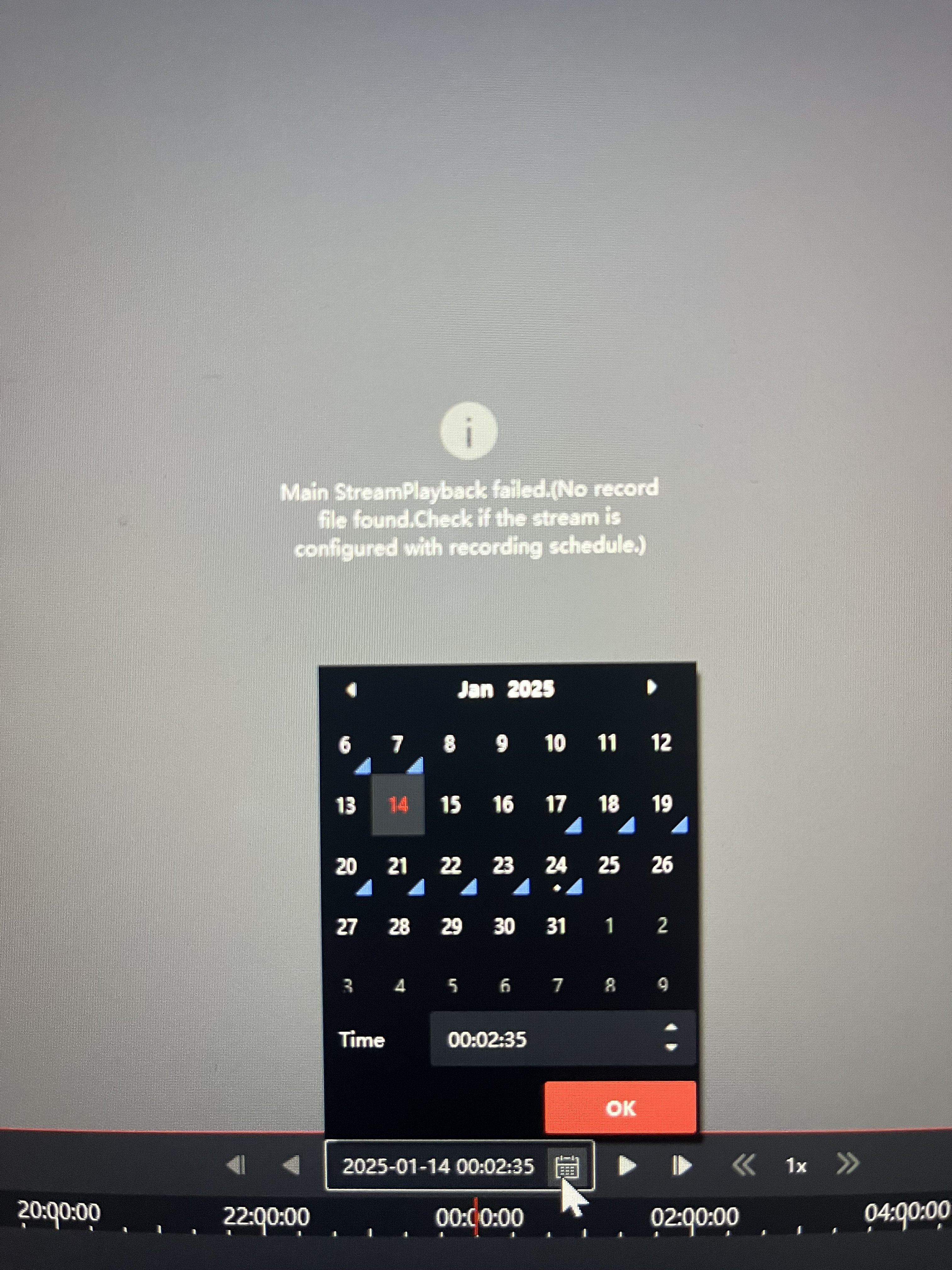

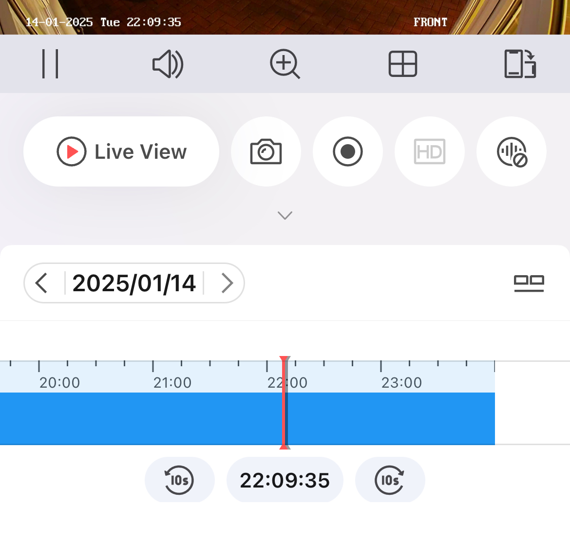

So I go to the DVR and playback then select the 14th Jan and it says no file found? Some days have like a little blue triangle in the corner but others don’t including the 14th?
I go to the 14th on the hik-connect app but no way of speeding the footage up?

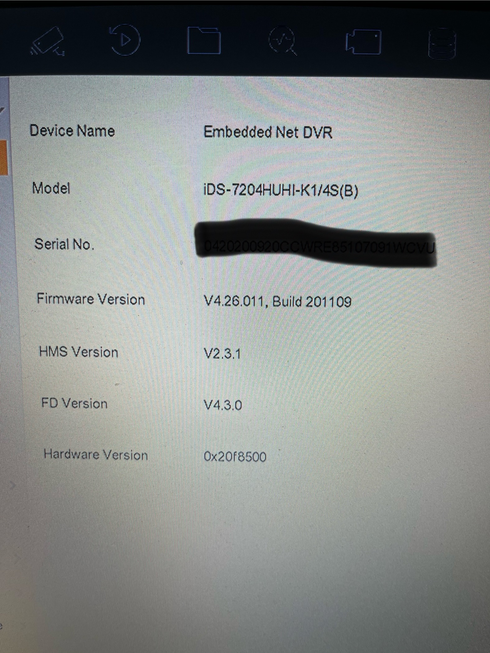

Hi @Jfd7000 - if the time settings on the cameras don't match the NVR, then that can cause playback issues, so it's worth checking those by logging into the cameras and checking under the system settings:
Also, make sure that the camera firmware is up to date - what are the models of your cameras and the firmware installed on them?

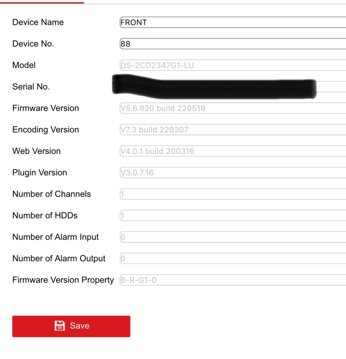

I have attached the screenshots for DVR and camera for the firmware.

Thanks, it looks like the camera firmware is up-to-date, so I'd check that their time is in sync with the NVR too.

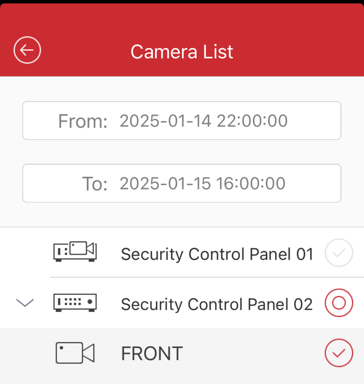

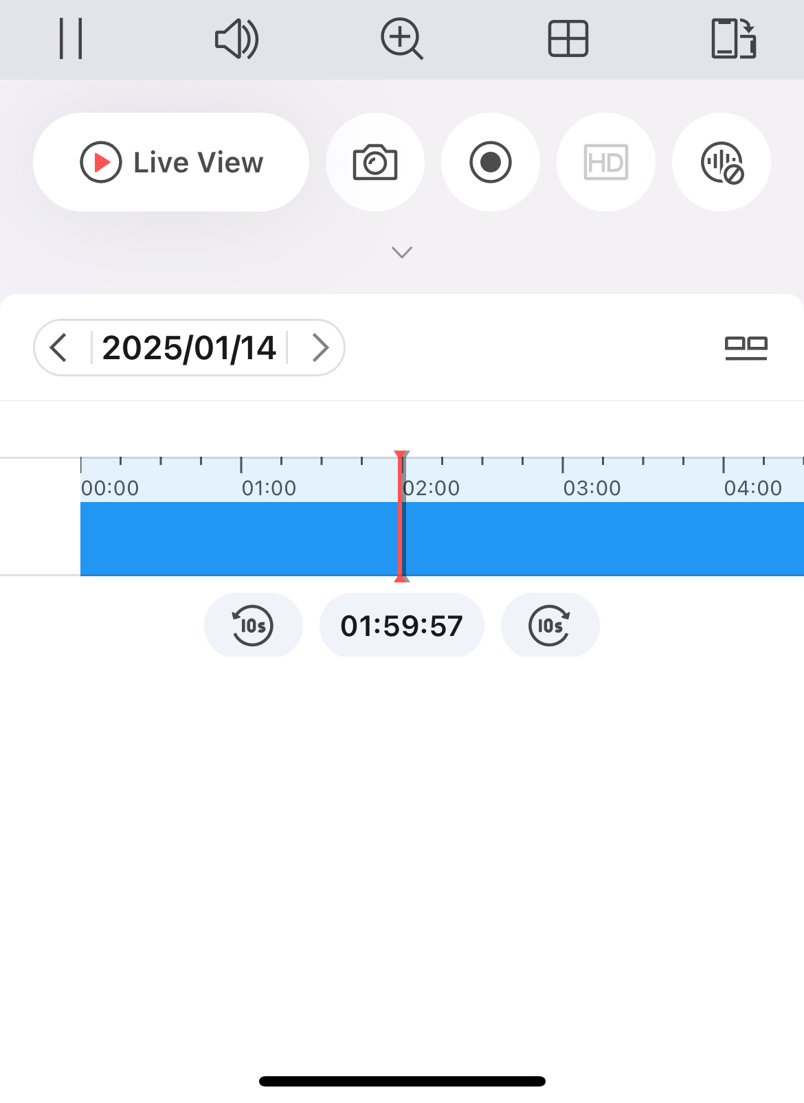

So from iVMS I get the same behaviour where the file cannot be found? I will attach screenshots of both. iVMS and Hik-connect. A separate question but should I not see an extra button in hik-connect for speeding up and slowing down footage?

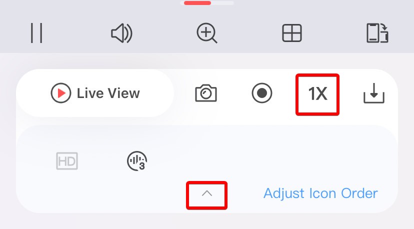

Yes, you should be able to adjust the playback speed in Hik-Connect by pressing the "1X" button - you may need to use the arrow to expand the icon menu:

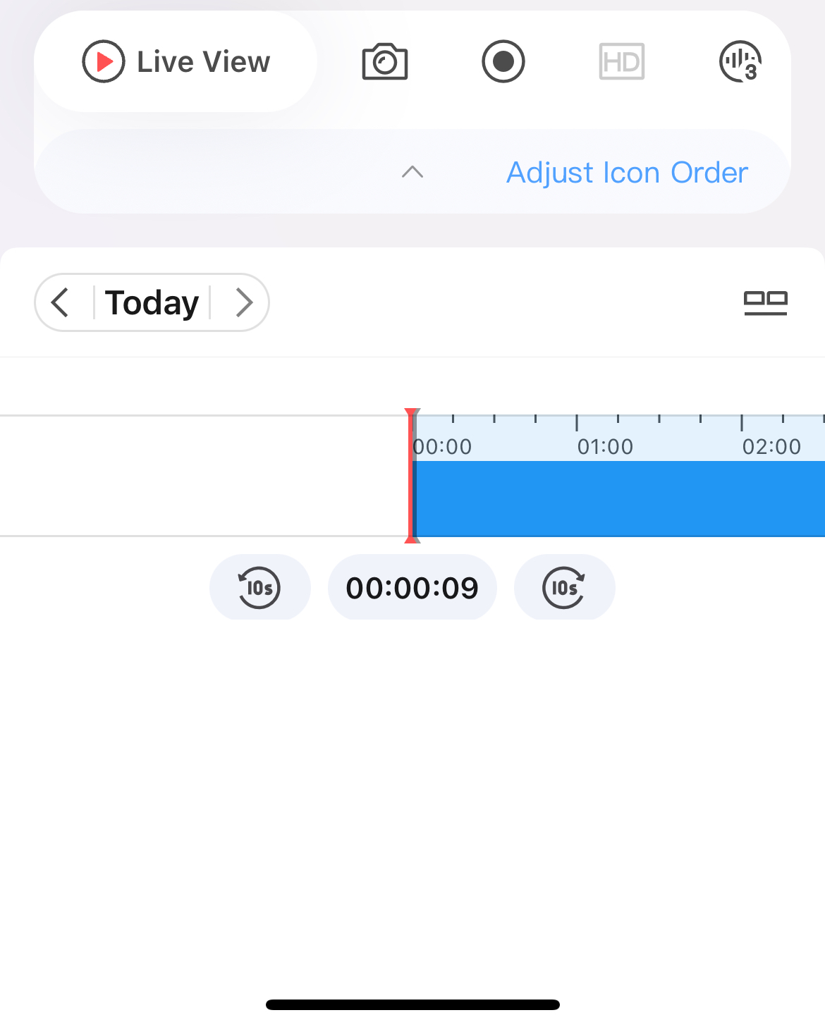

Thanks. I have looked at the time and all the same. The hik-connect app is missing the playback speed button? I am on an iPhone with the latest iOS and the app is upto date.
I have installed the windows app iVMS 4200 but it is still the same with no file found?

OK, unfortunately, I guess not having the option to adjust the playback speed in the app is a limitation of your DVR. We've seen similar cases where cameras and NVRs have different options in Hik-Connect.
