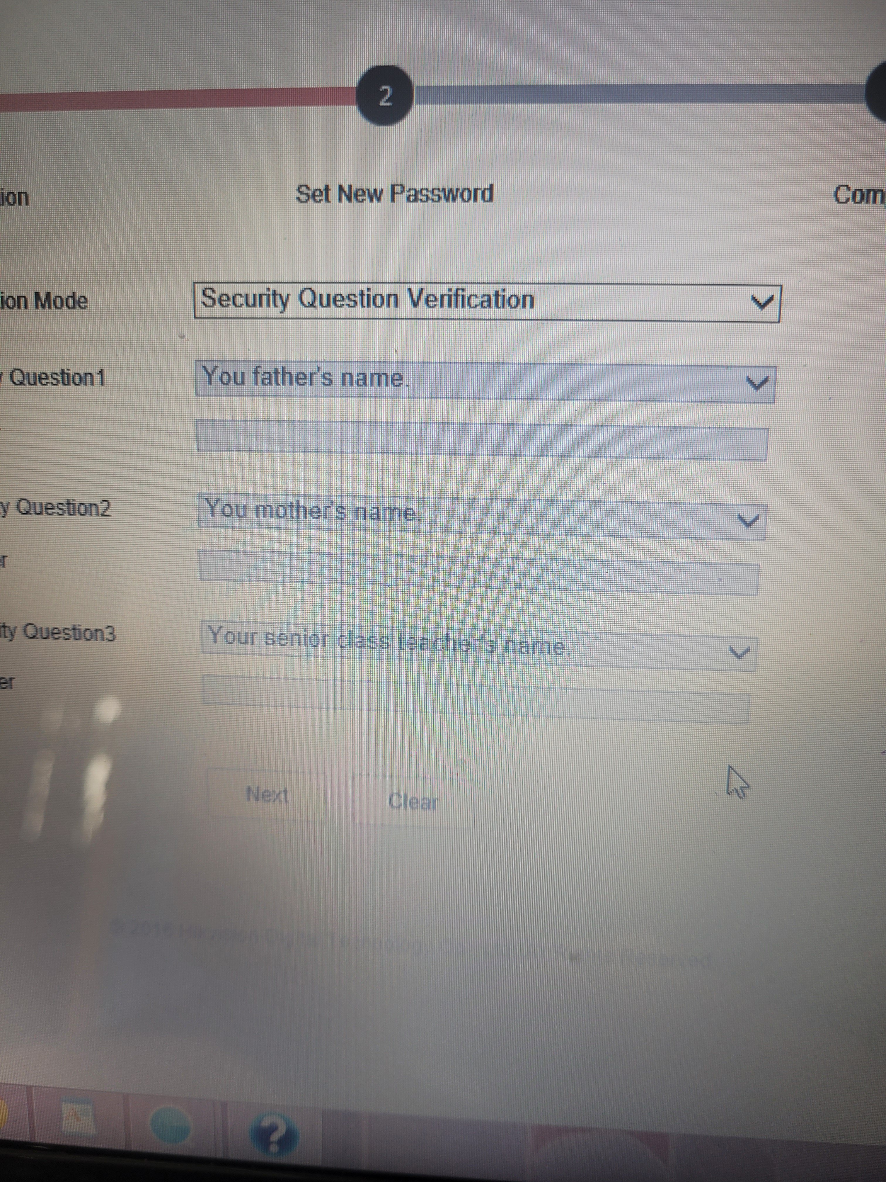

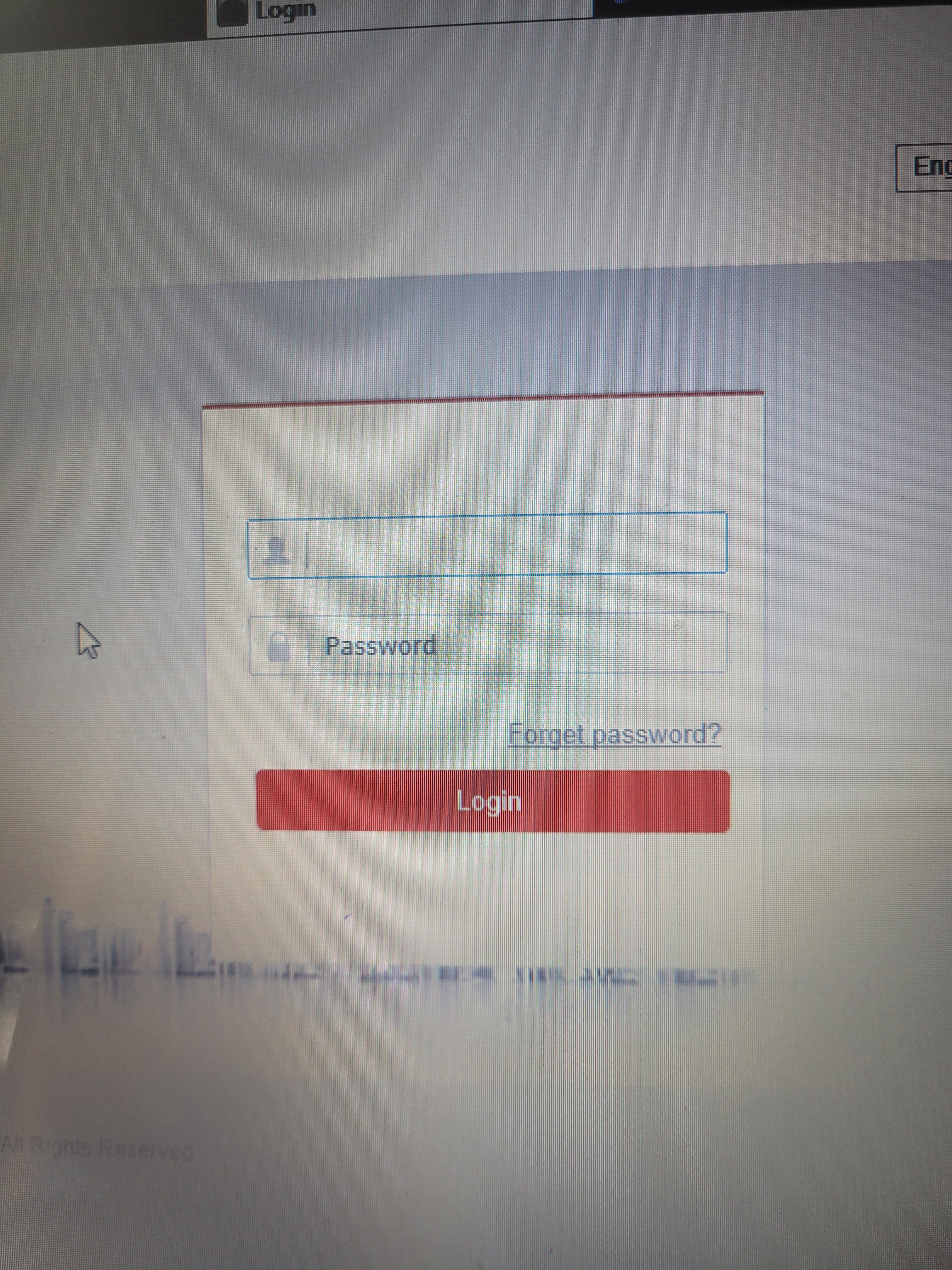

Hi so I am trying to alter the settings on my colourvu camera
So I put my nvr ip address in the search it diverts me to hik site asks for a password I can't remember so I hit forgotten password it then takes me to recovery page it wants answers to security questions but won't let me put any answers in so I'm a bit stuck

Hi @Pike25lb
If the security questions are greyed out this would suggest you haven't set security questions when you first configured the cameras.
This means that your only way to reset the password is to export the password reset file using SADP and send it to your original supplier/seller, if this is not an option the only remaining thing you can do is hard reset the camera back to inactive so you can set a new password.

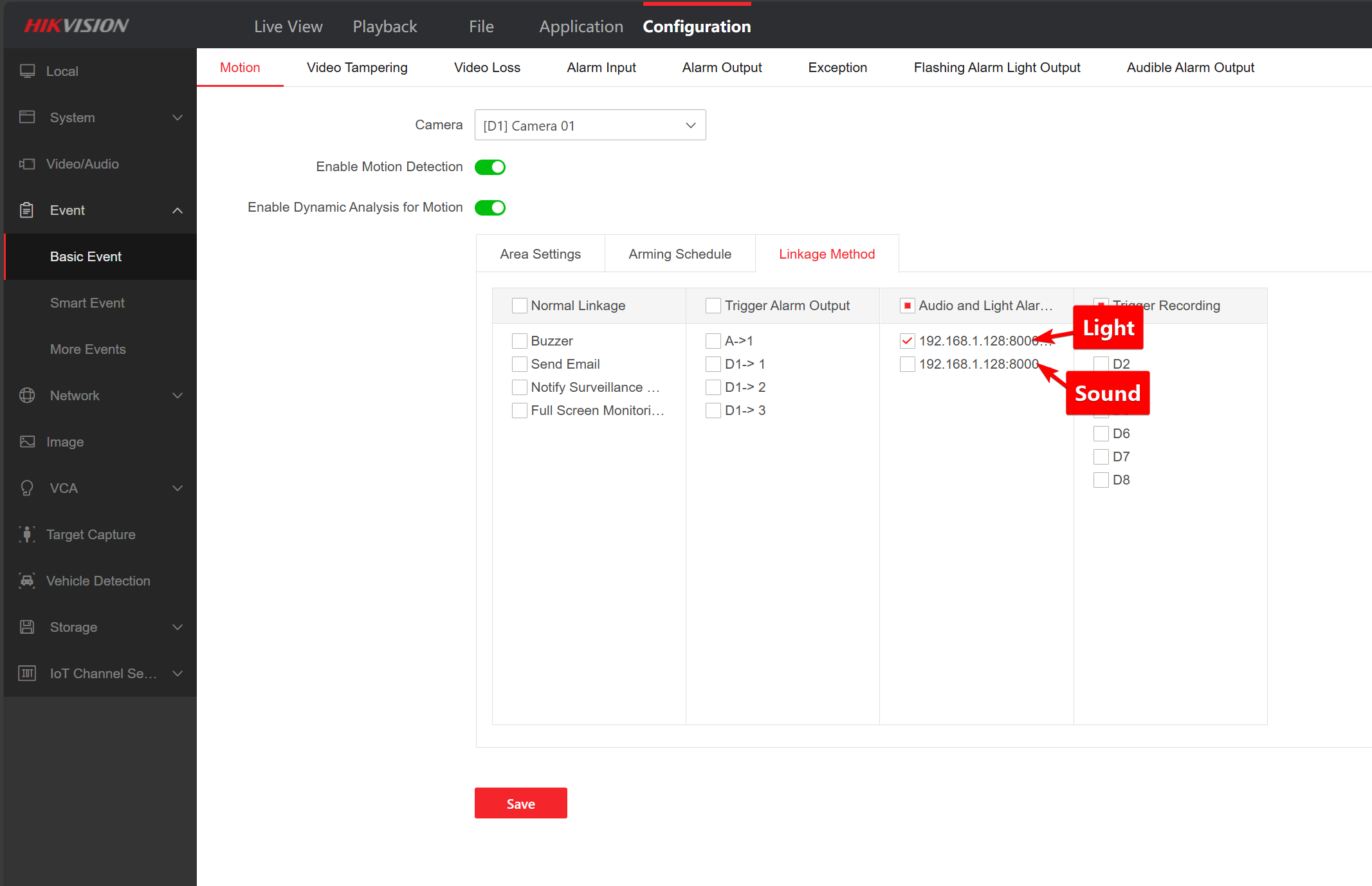

Do you mean the flashing light that's triggered by movement?
If so, you need to go to the NVR's event settings for the motion event you would like to trigger it, then go the Linkage Method settings for it, and enable it in the Audio and Alarm Linkage column, e.g:
To change the behaviour of the light (e.g. whether it flashes, just stays on, and for how long), then click on the Flashing Alarm Light Output tab at the top of the above screenshot, and select your camera from the dropdown.

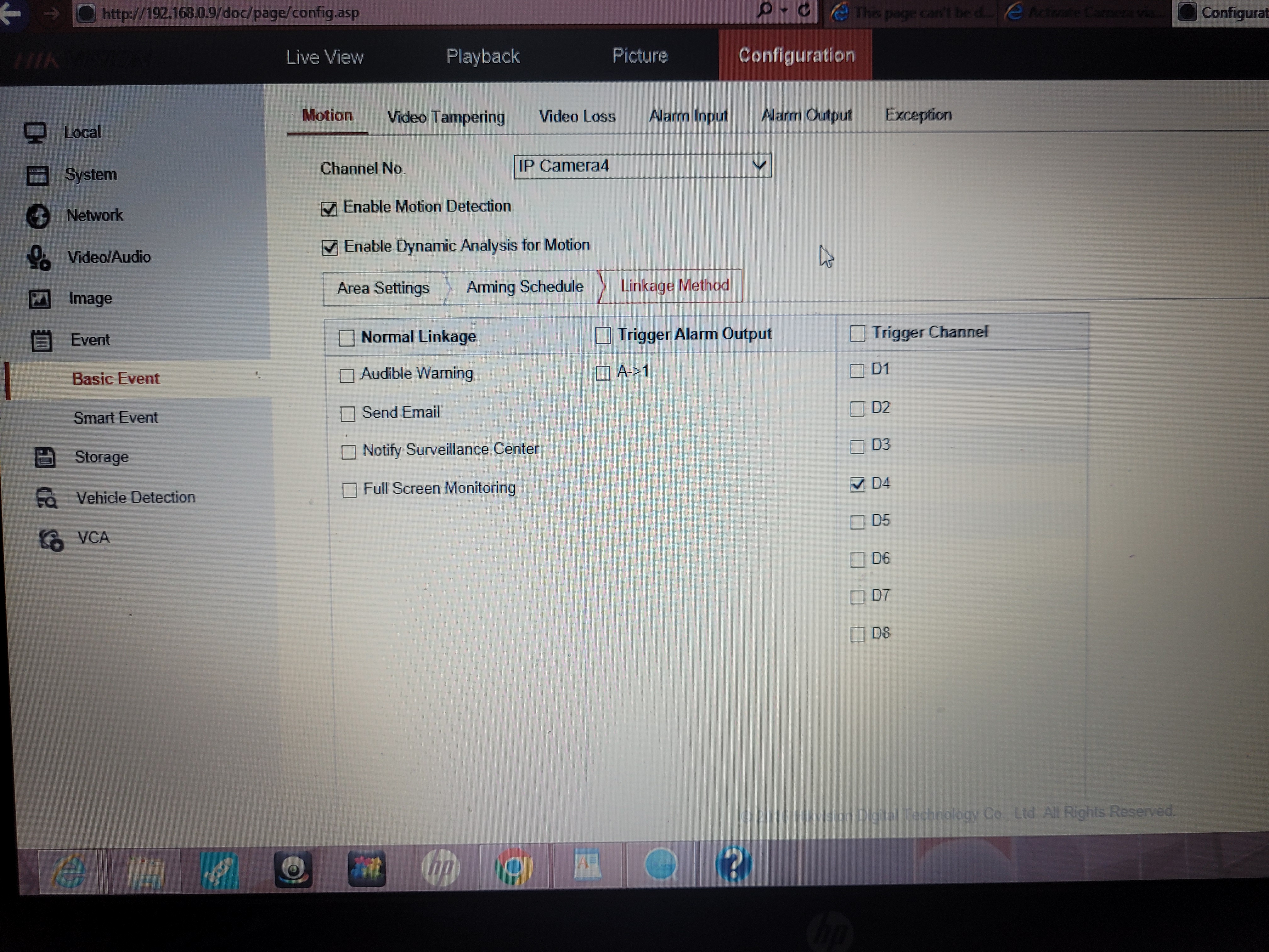

Hi thanks for that but mine does not have that bit on
You haven't said what model numbers and firmware versions your cameras are. However:
  • to have the strobe light feature the model number must end either ISU/SL ( for the Darkfighter) or LSU/SL (for the ColorVu)
  • If when you said 'Smart Light' you mean that the light comes on when there's motion, that feature only applies to ColorVu cameras (only certain models and firmware version support it) or ColorVu Hybrid models where the camera can switch between infra red and white light LED.

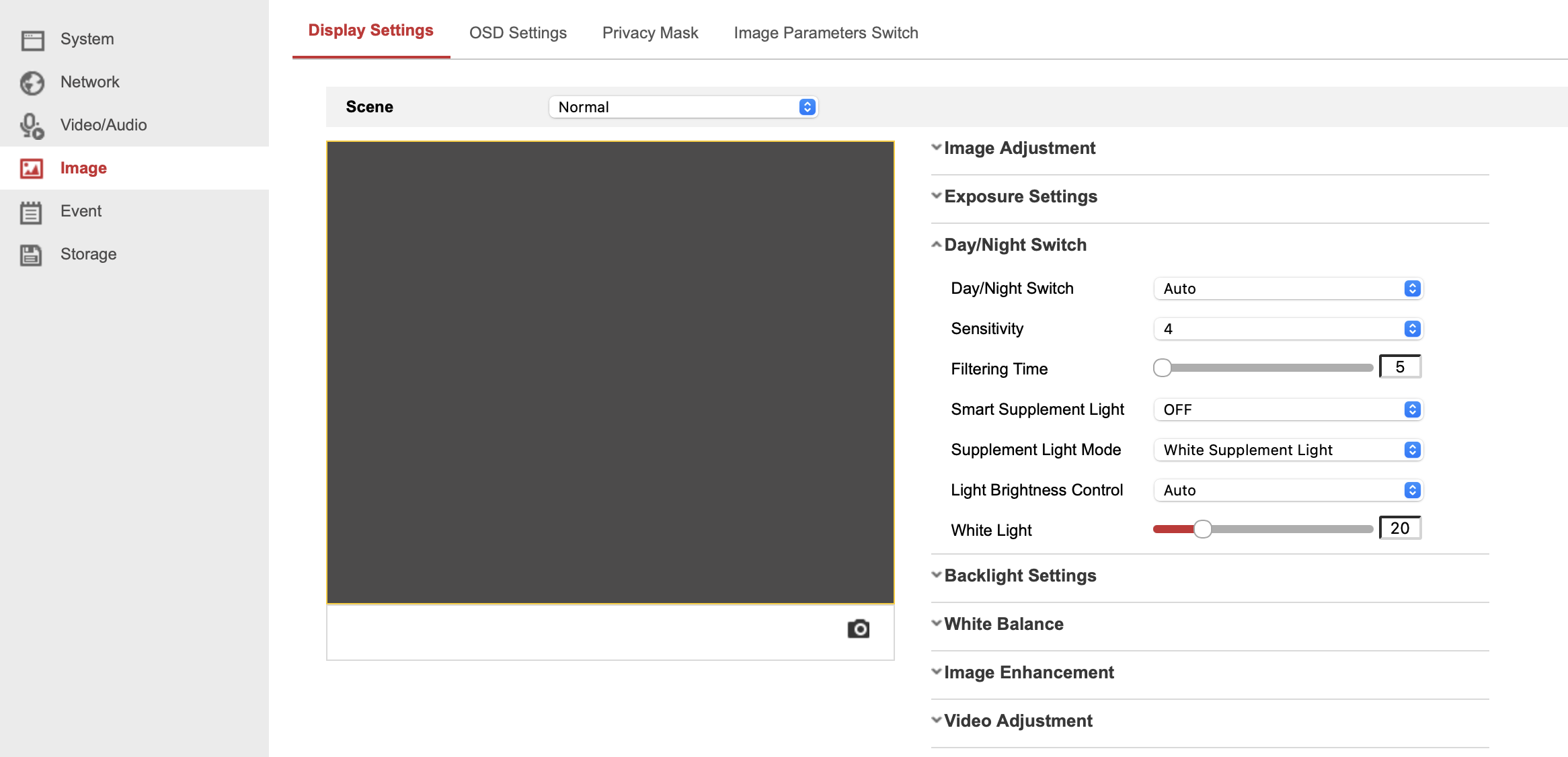

The ColorVu camera I did manage to turn the lights off when I first got it now i have moved it I would like to turn the lights on but can't remember how
Hi 1 is acusense dark fighter ds 2CD2386G2-IU
The colorvu is ds 2cd2347g2
In most cases you'll need to log in to the camera directly not the NVR but you can check to see if it's available in your NVR menu on the monitor or using the web browser. I assume if you switched them off previously, it's likely that you already have 'Virtual Host' enabled in the NVR. In a web browser go to your NVRs IP address but add :6500x to the end where 'x' is the single digit camera number. So if your NVR is at 192.168.0.100 and your ColorVu is camera 3, you'll go to http://192.168.0.100:65003. Then login with the admin password. Go to Configuration > Image > Display Settings > Day/Night Switch and set it as shown in the image below. You can set the white light to whatever level you want as it's a maximum and the light control being set to 'Auto' will adjust it accordingly:
