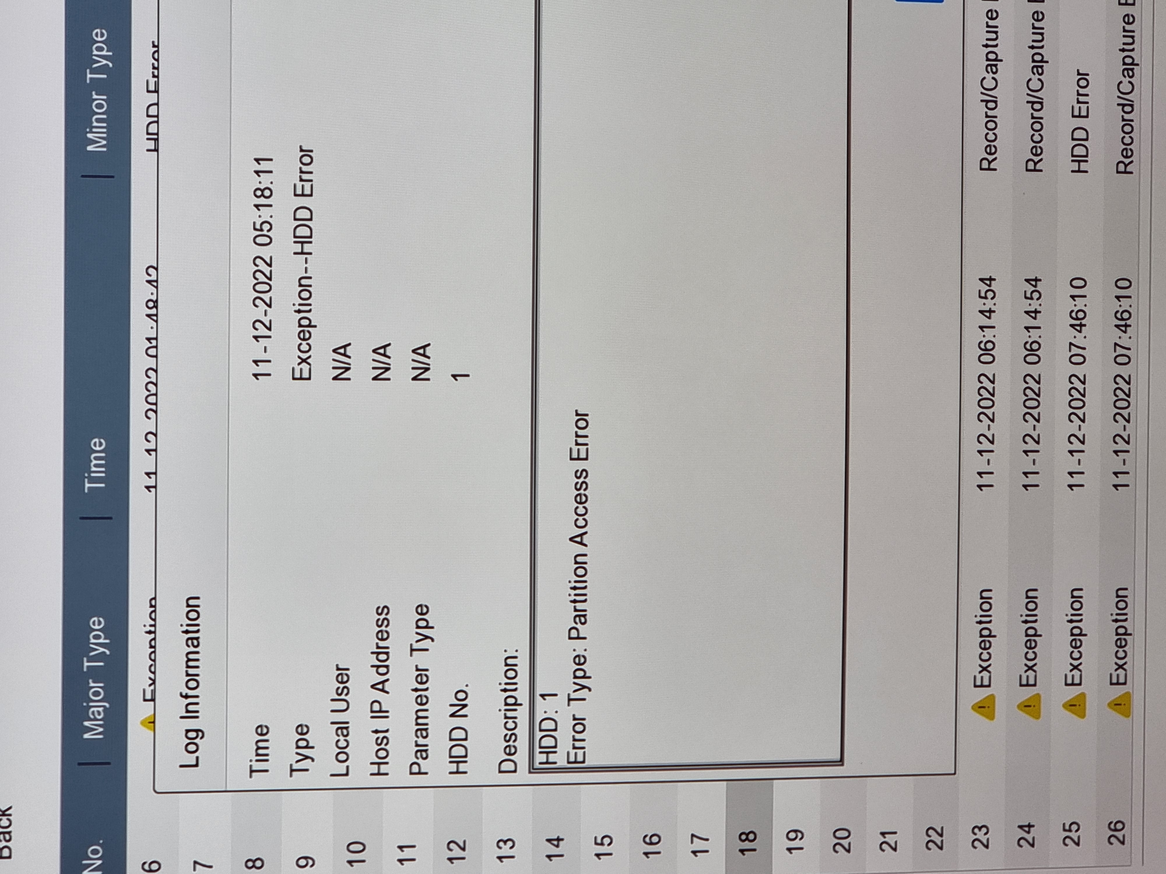

I have a problem with my DeepinMind NVR "Hikvision NVR iDS-7608NXI-I2_8P_X(C)".
The recorder is configured for continuous recording. Also Intrusion detection and Line Crossing is activated.
After a certain time, however, the recording stops and a HDD error "Partition Access error" occurs.
There are 2 WD Purple 18TB disks installed.
The latest firmware "4.61.025_220826" is installed on the NVR.
After that, the hard drive where the error occurred is no longer usable. It has to be formatted again.
After a init of the hard disks the system works again. But the error comes back after a certain time.
I have also tried two other hard drives (also 18TB) without success.
All hard drives are new and error-free. i could not
Could this be a firmware problem? Anybody else with same problems?
Here are two screenshots.
Seems like the recorder could only write 730 GB to the 18TB drive and then runs into this partition error.
After the error occurred recording stops. The recording could not startet again. Repairing the database did't fix the problem.
Only formatting the HDD's fix it.

Yes, but have a look here. In this arcticle also the 18TB WD Purple is mentioned.

Hi MI19
I think you're right in saying that the 18TB drives are not fully compatible with these NVRs.
Normally, you can use a larger drive than stated as being compatible on the NVR datasheet without any problems, but we've not tested 18TB.
I asked Hikvision support about the error, and they replied confirming that it's due to the size of the HDD, here's the full response:
"It is correct, the issue occurs as the size of the drive.
Currently, the NVR does not support an 18TB hard drive, the capacity of the drive is beyond the limit.
It is recommended to replace a suitable drive to solve this problem."
Thank you very much for this information.
I replaced the drives with 2 WD Red 6TB drives. No Problems so far.
Hopefully there will be a firmware update soon that will also support the larger hard drives.
