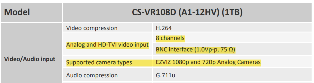

Phil, thank you for this. I am an engineer but not experienced in this field, though I am learning. I don’t suppose you know if the EZVIZ dvr can be repurposed for other cameras? It’s 8 channel and 1 TB so it seems a shame to waste it!. I have been looking at your range and there seems to be some good choices there. I want it hard wired, 12v powered and feeding a dvr or nas I suppose, still a lot to learn! Thanks. John
Hi @Oaktree11 - I've attached the datasheet for what I think is the EZVIS analogue kit you have, which covers the specs of the CS-VR108D(A1-12HV)(1TB) - could this be the model number of your DVR?
If so, it states you can use a third-party HD-TVI camera provided it is 1MP/720p or less in resolution or any 2MP/1080p EZVIS camera:
So, if your current cameras are 2MP, I don't think you'll be able to find a compatible third-party camera that will offer better performance without replacing the NVR too, I'm afraid.
I've actually misread the datasheet - any 2MP camera should probably be fine, even third-party models :)
It only states EZVIS cameras are supported, but generally with analogue, you can use any HD-TVI camera with a DVR.
