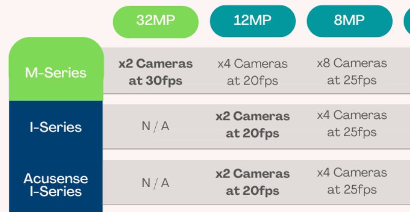

What is your meaning, if i get liveview on 4x 8Mp cam's @ 20fps per screen, i should be ok right?
That is the decoding capability

Regarding specifications and what differs between models, you're best off downloading the Hikvision pdf data sheets to compare features in greater detail. you can get those straight from the Hikvision website product page.
Decoding capability is more important for playback than live view.
Live View - When you're in a multi screen view, you're unlikely to view all cameras at their full 8MP resolution as there's no need due to the image size on screen. Depending on the screen layout, the NVR will show the lower resolution sub stream for multi screen live view. When you double click one of the images to show that camera full screen, it will automatically switch to show you the main stream. On the 8MP cameras, you can now run the sub stream up to 720P resolution so multi screen image quality won't be compromised.
Playback - This is where decoding capability matters if you want to playback multiple channels simultaneously, as you'll be viewing the main stream. Again it's rarely necessary to view every camera at once - if you're viewing footage of someone breaking into your car at the front of the house, there's no need to be simultaneously viewing the back garden. Also 'smart playback' (when you're filtering to show alerts on the timeline) is only available for single camera playback regardless of model. If you go over the decoding capability, one or more screen segments will show 'no resource'
So to expand on this, JP Colin is correct about the NXI’s only supporting 4 8mp’s cameras at 25fps. After this if you add any more cameras then the cameras in streamed playback will become choppy as hell and appear to freeze for upto 5-6 seconds at a time especially when streaming to hik connect.
As for referring to HIK data sheets I would have recommended this till about a month ago, however hikvision have been very devious and REMOVED the specifics about decoding on the data sheets if you look closely as it was affecting their sales of older recorders…
They no longer show the amount of each camera type a recorder will support
