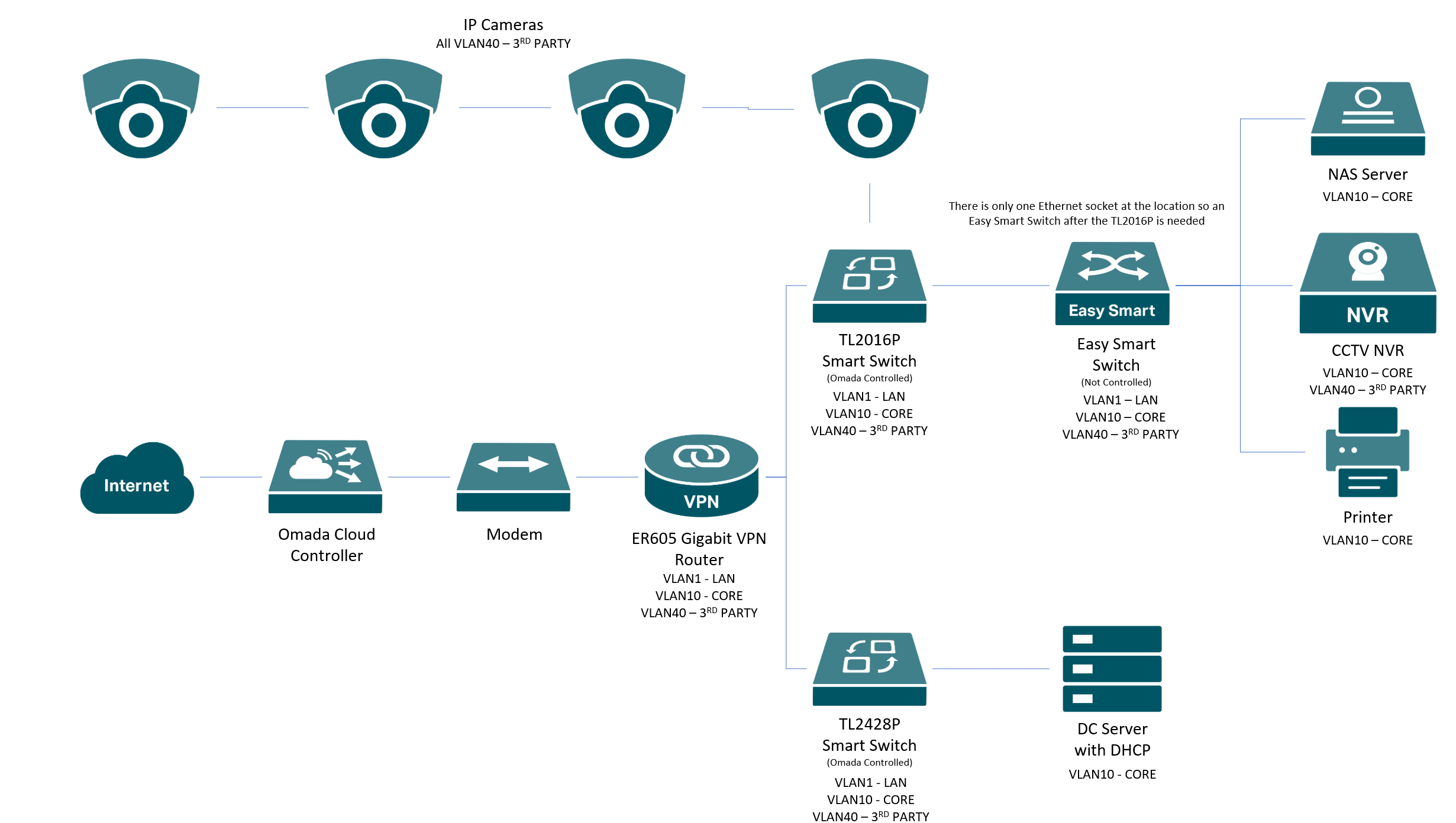

I have made a simple network diagram with the hope of it being clear to understand. As you would see that I prefer to have the cameras on a different VLAN but I will be putting a rule in place to allow the cameras to communicate with the NVR which would be on VLAN10, hence VLAN40 is being added from the Smart Switches to the NVR.

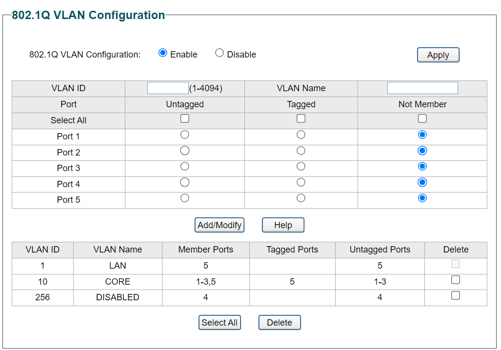

On the TL-SG105PE switch, I have made the following configuration but it isn't giving an IP address when the switch itself is on VLAN1. My NAS and printer also does not get an IP address as the single Ethernet port connected from SG2016P switch when it is set as VLAN1, so clearly there is something I am unsure what I'm doing here.

Some observations, in no particular order, that may help (or not):
  • TP-Link may have a lot of capabilities I've not familiar with, so be sure to do your own research to ensure you're configuring your network using best practices. aka some of my thinking may be wrong.
  • Assumption..... all your switches are L2 switches. None are providing any L3 functions. In your network, L3 is done only at your router.
  • The NVR, with a single interface, can't be privy to "BOTH" VLAN10 & VLAN40 using traditional firmware from Hikvision. It's one VLAN or the other. Other vendors may provide Linux software that understands the VLAN tag in the IP header, but HIK does NOT.
  • Going forward, you might want to consider getting a newer NVR with 2 interfaces.... thus allowing one interface on VLAN10 & the other interface on VLAN40.
  • Port 5 looks like your TRUNK port. Port 5 MUST BE TAGGED for ALL intended VLANS. In your case, both VLAN1 and VLAN10. Modify your configuration to support VLAN1 "AND" VLAN10 tagging on Port 5.
  • VLAN40 traffic will never reach this (5) port switch. This is correct given your configuration. The bad news is ALL VLAN40 traffic will have to be routed thru your router. Your gateway router will need to copy VLAN40 frames over to VLAN10 and vice versa. That might become a bottleneck in your network..... time will tell.
  • The PVIDs for your switch are not shown. I guess the PVID was set to VLAN10 on Ports 1,2,3. And PVID = VLAN1 for Port 5.
  • VLAN1 traffic will reach this switch, but will be dropped from reaching Ports 1,2,3. This is fine.
  • A typical DHCP Server is limited to a single Broadcast Domain.... which equates to a single VLAN. A DHCP Server on VLAN10 can respond to ports on VLAN10 only. I assume you may need to move your DHCP Server over to VLAN10. Or add DHCP Servers as needed.... your router may be capable of providing a DHCP Server function on multiple VLANs... but I'm unaware of your router's full capabilities.

  • You are correct, Port 5 is the Uplink port (or Trunk) and I have tagged this on VLAN10 & VLAN40. Other ports I've tagged on VLAN40 were 1 & 3 when these were on VLAN10.
  • It'll be good have VLAN40 working correctly for the cameras (possibly NVR too) so they're all on the same subnet with DHCP coming from the router, so routing might help all VLAN40 traffic to the switch.
  • I have now included a picture of the PVIDs but given the difficulty of giving an IP address when it was on VLAN40, I've changed the PVID for Port 2 to 1. Now it's decided not to give an IP address even when it's on VLAN1.
