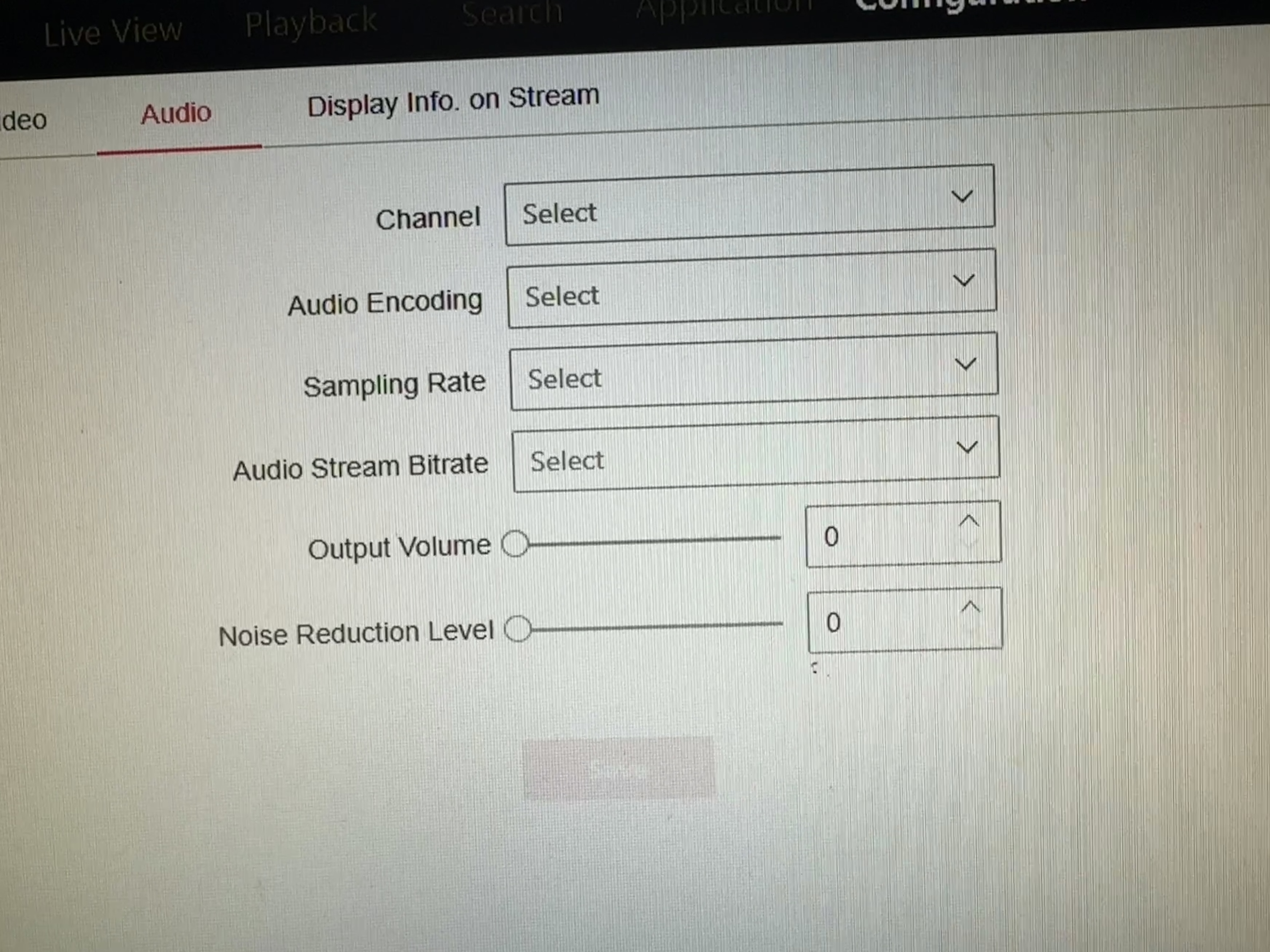

The one thing that I have noticed when logged in via web is under Configuration-Audio/Video-Audio These options are greyed out..

On the web log logged in with chrome on windows I have these greyed out options under Audio…

Those options are greyed out on mine too - I think they're for separate microphone inputs if added via IP where there's no internal mic in the camera. When in the web menu in Safari there's a separate 'Enable Sound Preview' for each of the video outputs so make sure it's turned on and saved for all 3. For 'HDMI' it would just enable the audio in the HDMI along with the video, but I'd assume if it were enabled for VGA or Aux/CVBS, then that would output via the RCA. I can't think of anything else that would prevent it from working but it's not something I've ever needed (the RCA output)
