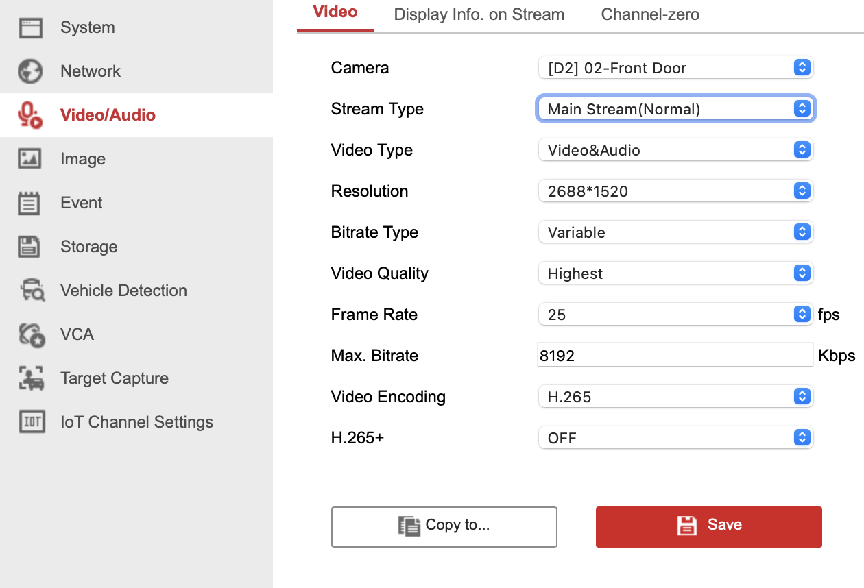

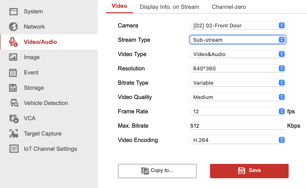

It's fine to access the NVR settings via a web browser rather than use the local menu - I usually just advise that you use the NVR webpage menu when possible rather than directly accessing the individual camera menu. The path I gave to get to the camera settings was for an I series recorder on version 4 firmware. On the web browser it's in the Video/Audio settings. As shown in the two images below you need to set it for both main and sub stream. Use the save key after each change to apply it.
