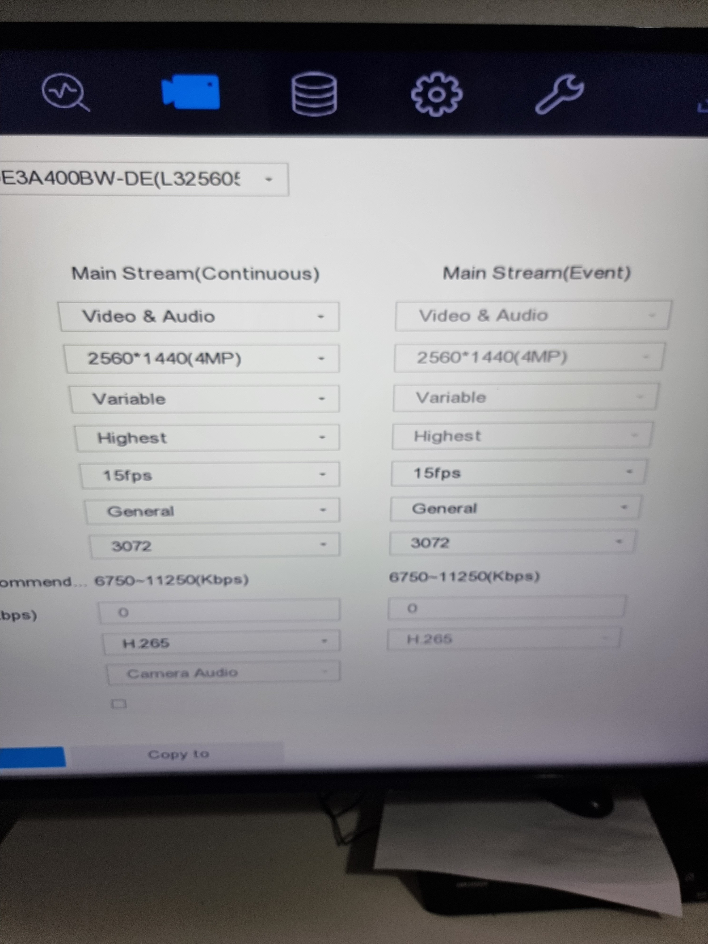

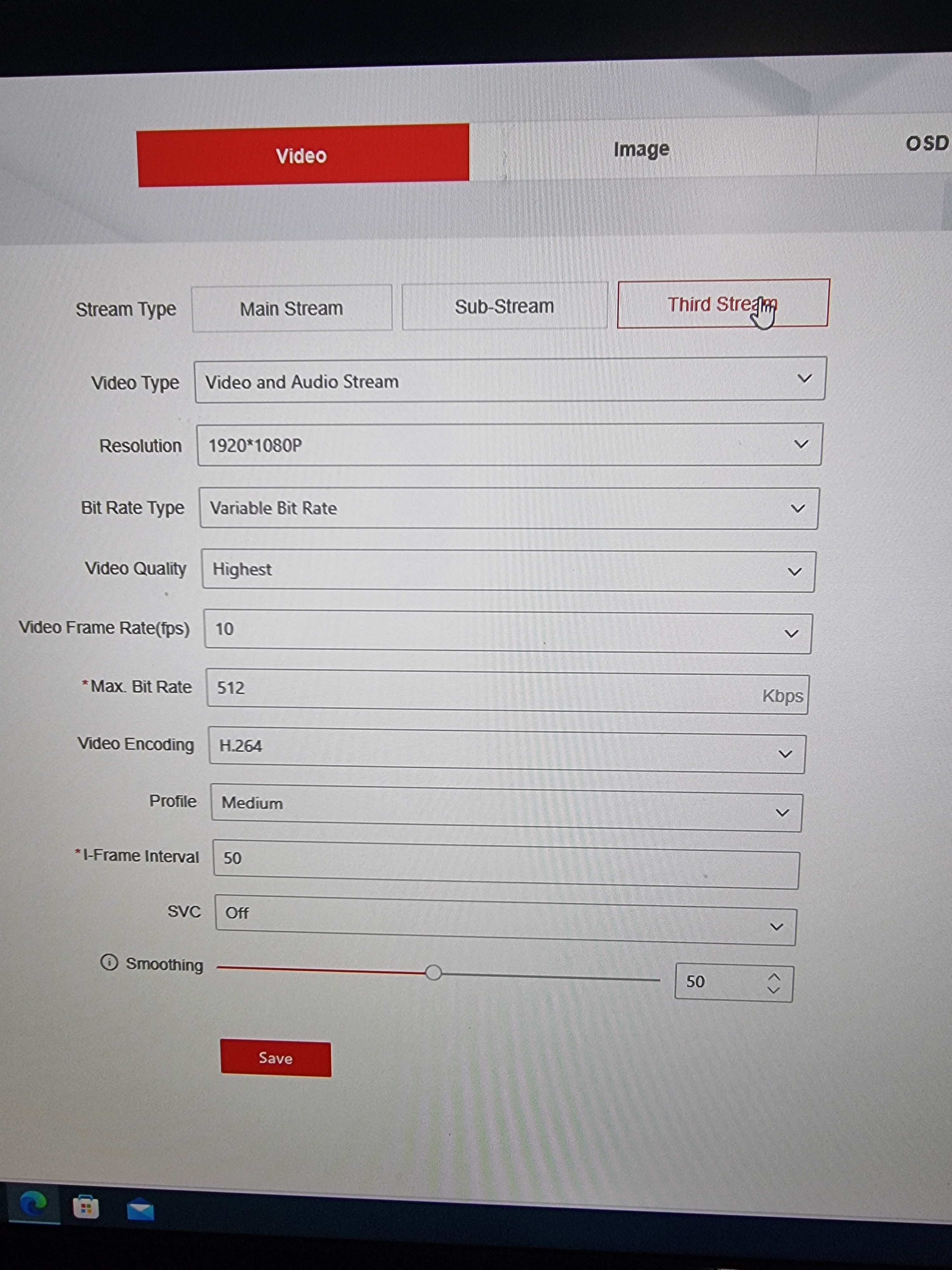

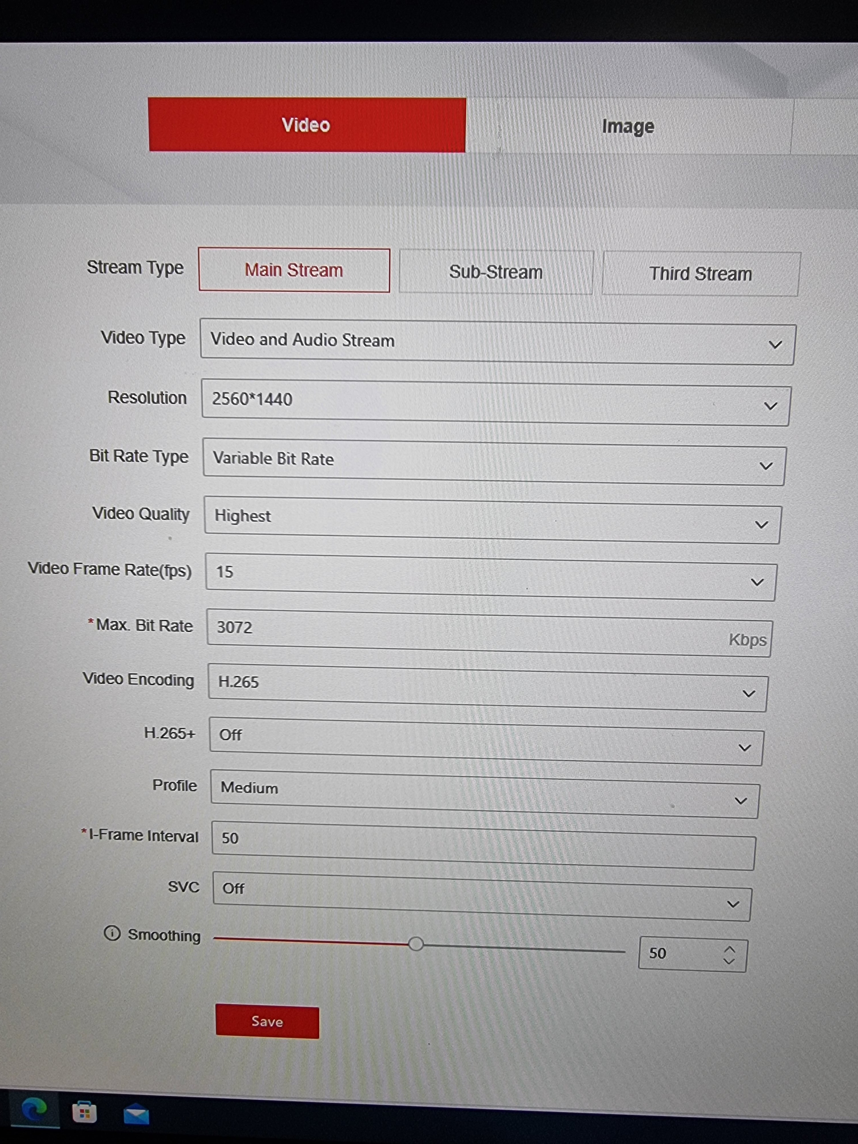

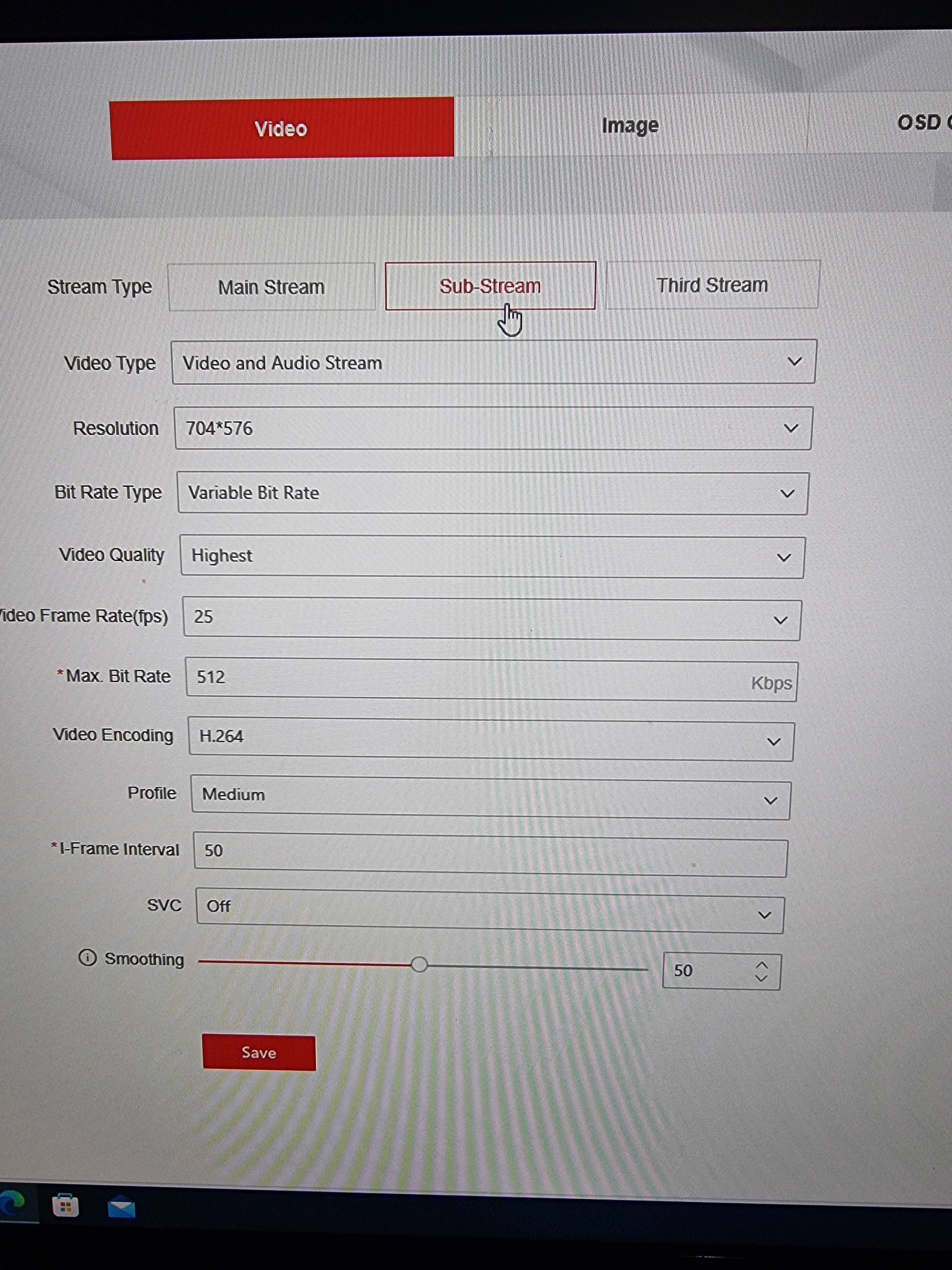

Hi mate
I changed the settings and it's still saying no resources. I'll send you photos of the camera and dvr setting.
Thanks again for your help

Nothing standing out. I wouldn't put the quality at 'highest' as the bit rate will bursts significantly at each I frame and can burst above your setting. You have a maximum bandwidth available of 4,096Kbps. When set to 'highest', even though the main stream is set to a maximum of 3,072Kbps it will go above. Other than lowering your main stream frames per second and max bit rate lower I'm not sure. Check the both camera and DVR are up to date on firmware.
I'll have to have another play about with it. The dvr and camera have the latest firmware iv did that that the other day. Will changing the other 4 analogue cameras bit rate make a difference. If no joy I'll just have to change it back to 3mp. Will you be able to send me the best setti gs for 2mp if I have no joy?
