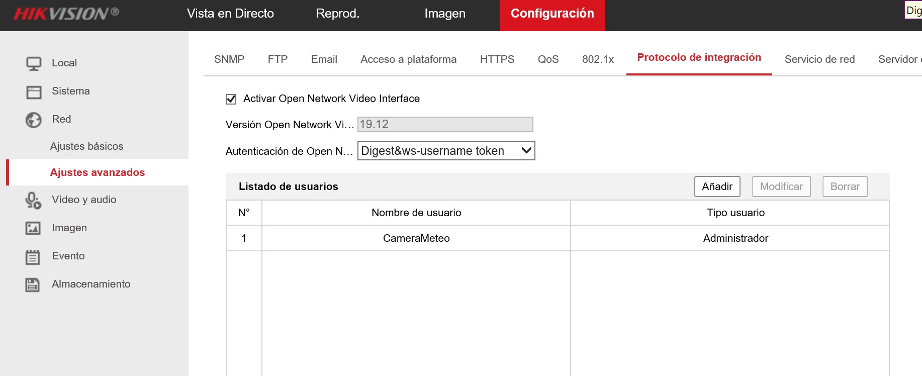

Hello, good afternoon. My camera is not the same as your model, but I check this path to see if it follows the same route as yours and the ONVIF is there.
Hi, Thank you for the reply. This looks the same as my setup and that is the way mine is setup and it still won't work on the onvif on my DVR wondering if there is something else I am missing thanks again.
Well, I can't help you any more. I have two cameras that are recorded in Synology's Surveillance Station, and although the cameras are not on the list of those compatible with Synology, by activating ONVIF on the cameras I can link them without any problem in Surveillance Station.

Thanks for the reply . As per Robertomcat above snapshot my setup does not have the option to tick enable onvif I am just hoping i am missing something being new to IP cameras.

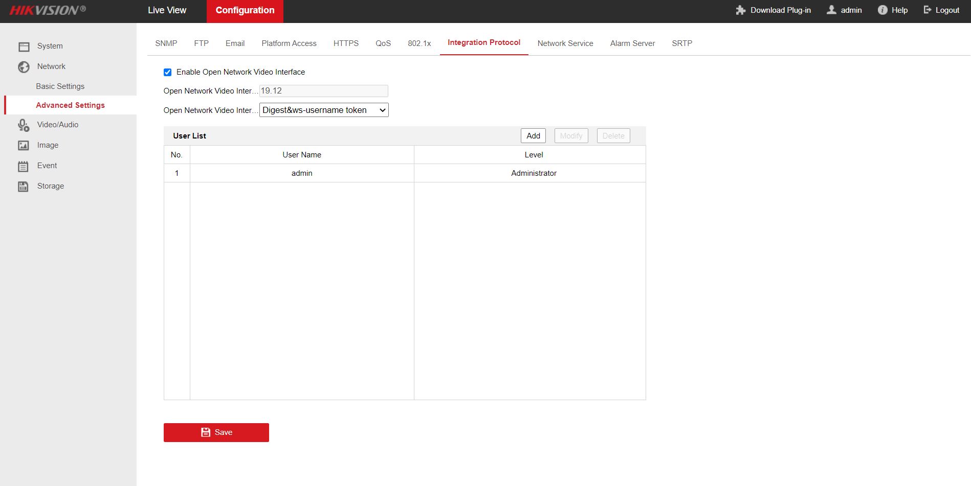

Phil sorry i missed one of your posts my settings is exactly the same as the post from Robertomcat above only in English. But i will post it later. Mine does not have the tick box for onvif and this was the same before I updated from the factory 2021 firmware from new.
Hi GerHil,
Hikvision changed 'Enable ONVIF' to 'Enable Open Network Video InterFace' in their settings, which is what you have already got ticked.
You should just need to add a new user as an administrator like you can see Robertomcat has done in the screenshot he shared with you, this should then allow you to connect your camera using ONVIF.
Hi Jake i never even gave it a thought Open Network is ONVIF Lol. And that is my camera user/ admin so as for is my camera onvif the answer is yes thanks. Now i need to find out why my DVR wont see it as ONVIF etc.
Just to restate you need to 'add a user' e.g. you need to create a user that your NVR can use to access the camera with ONVIF rights.
Add the user in the screen shown.
When you configure your NVR to add this camera, use the user name and password that you set here for ONVIF access to the camera.
