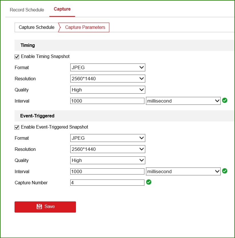

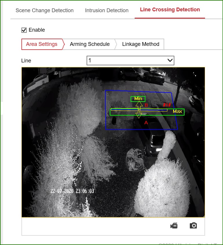

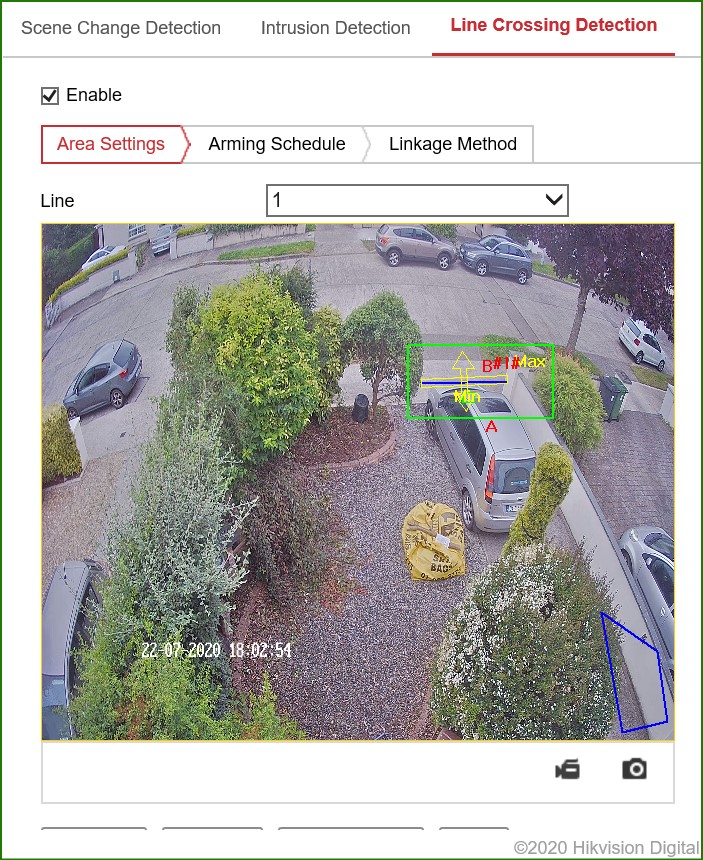

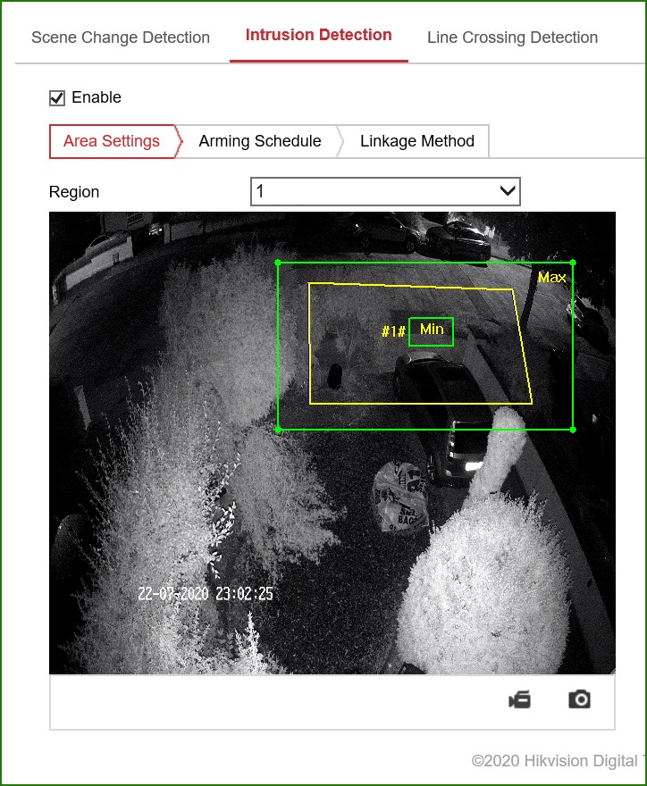

Can you help please? . I just want to capture line crossings and intrusions and see the JPEGs on iPhone. Many hours trying! There is a memory card in the camera but I cant see where it is. I do everything through the IE Browser. Hik Connect app is working as far as I can see. Any suggestions would be appreciated.

Some of the information we need to see is not in your pics. But offhand your min and max boxes are weird. Make your max box as big as the whole scene. And make your min box just big enough to rule out cats, possums, dogs, etc. And make them square or slightly rectangle. And is there a reason that your line crossing is only one way?
The min and max boxes do not need to be located in the areas that you are monitoring. Just make them anywhere on the screen.

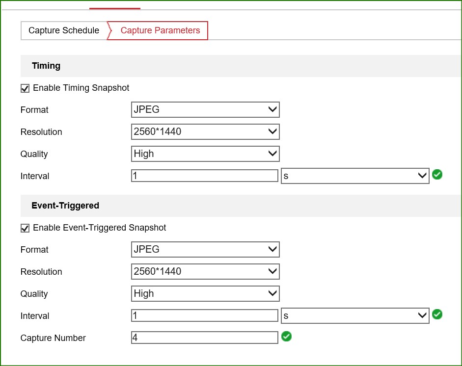

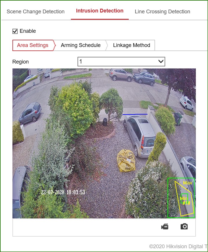

Thank you for your insights. I made a few alterations and I am also noticing now how poor the night view is. It should be better than this I think

Also you need to enable recording A1 ( where you modify linkage method). If you don't enable that camera will not record anything.

That third picture for line crossing - why are the min/max boxes so small and right on top of the line? See my prior post about size and location. And for intrusion your max box is too small.
Yes you can do line and intrusion at the same time.

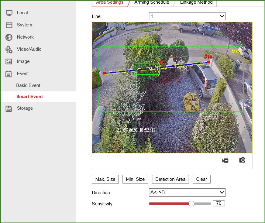

Apologies in advance. I will stick to Line Crossing. If the Min box is too big - does this mean it won't trigger for the cat? Alert for the cat would be good! Then, if the Max box is too big - does that mean a small car pulling in would not trigger an alert, because the car is smaller than the box? Is there an actual purpose for having to draw the box?

How about intrusion detection boxes - can you help us / explain how they work.
Exactly the same for both line and intrusion. Skyler's problem is that the camera is about 100 feet from anything you want to monitor, which means it's going to be difficult to fine tune that min box. You'll just have to keep playing with it.
And Skyler - your intrusion and line crossing has to be set up exactly where you want it. Your last pic shows the line crossing way over to the left in what looks like another property. Was that your intention? And the min box is way too big and will probably not pick up a human.
