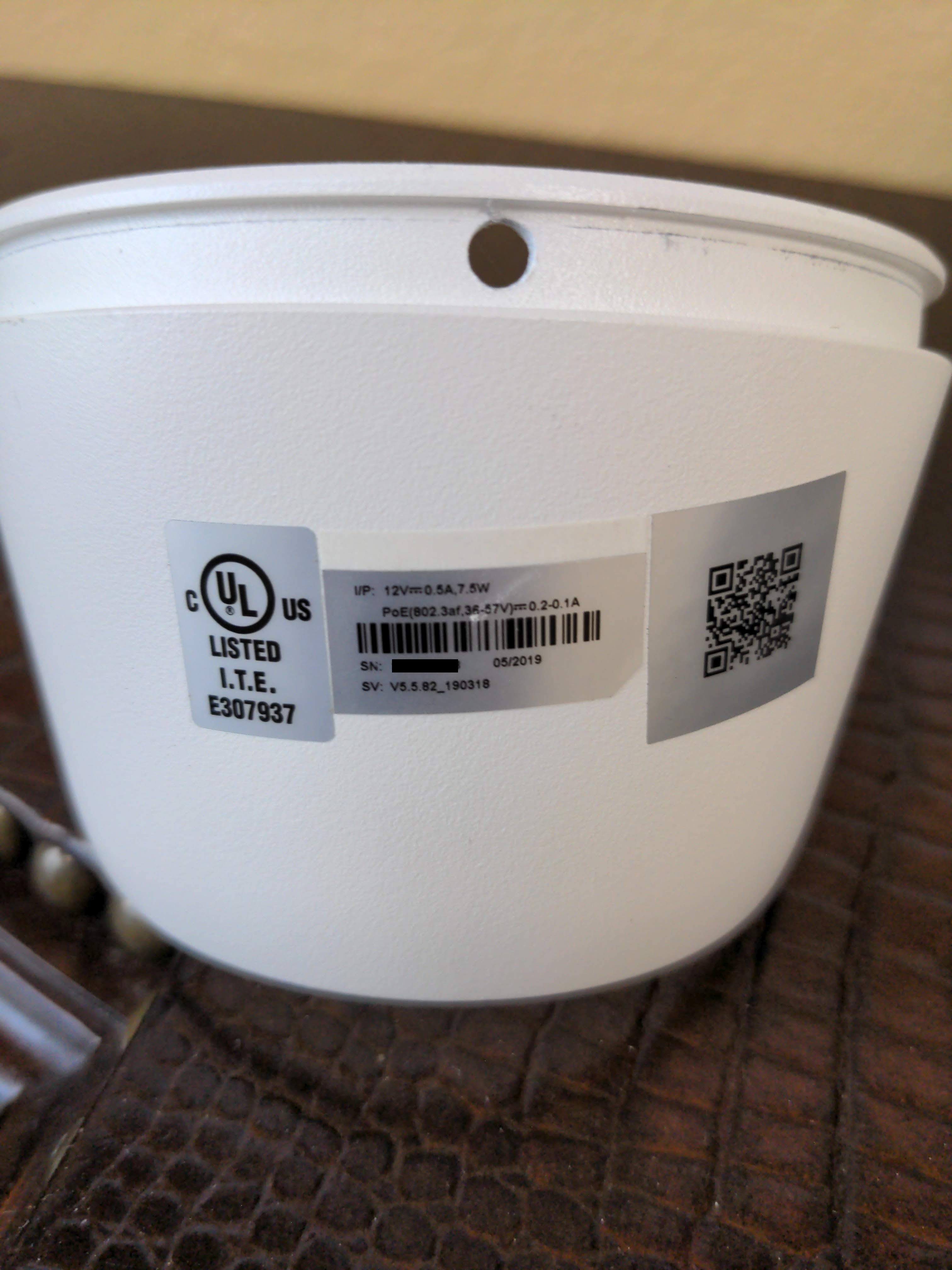

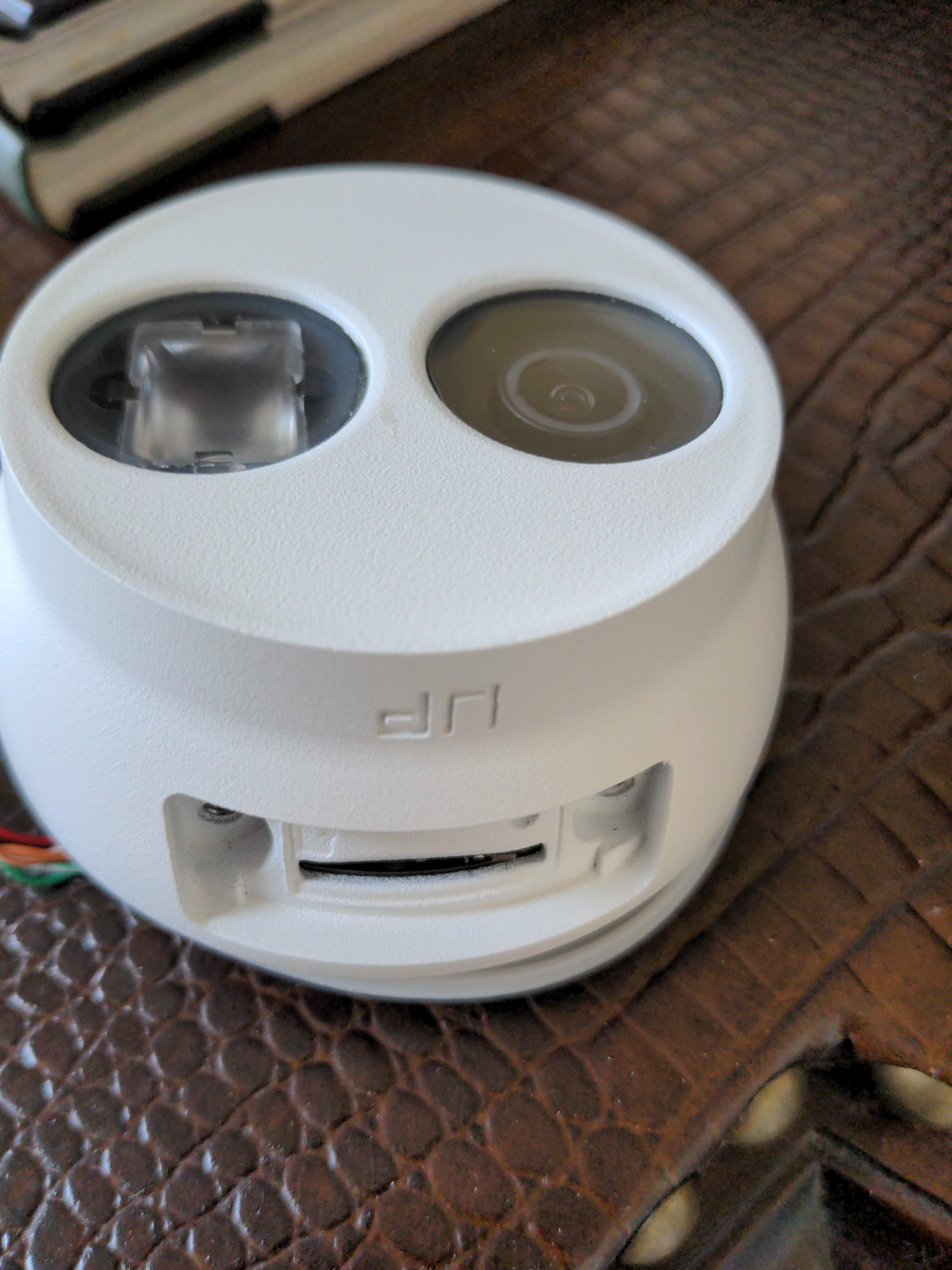

7 of the cameras are TechVision PBE4L3WZ-S/VA, which I was able to reset by selecting Forgot Password. This sent an email to a partially masked email recipient that had enough letters visible that I recognized who it was, and had him forward me the reset codes. This worked great for these 7 cameras. But there is a camera in the foyer that is a different type than these TechVision cameras. It has no name or model to identify it, though it does have a serial number and PoE power requirements. It looks very similar to a HikVision DS-2CD2343G2-I(U), though it also looks like a NC324-XD which I believe is made by Winic Technologies USA, Inc. I contacted HiKVision support with the serial number, and they stated it was one of theirs but that it was a knockoff, and so couldn't help me. I'm confused by that statement because if they recognize the serial number, then shouldn't that mean it was made by them? How would they know if it was or wasn't a knockoff just by a serial number over the phone?

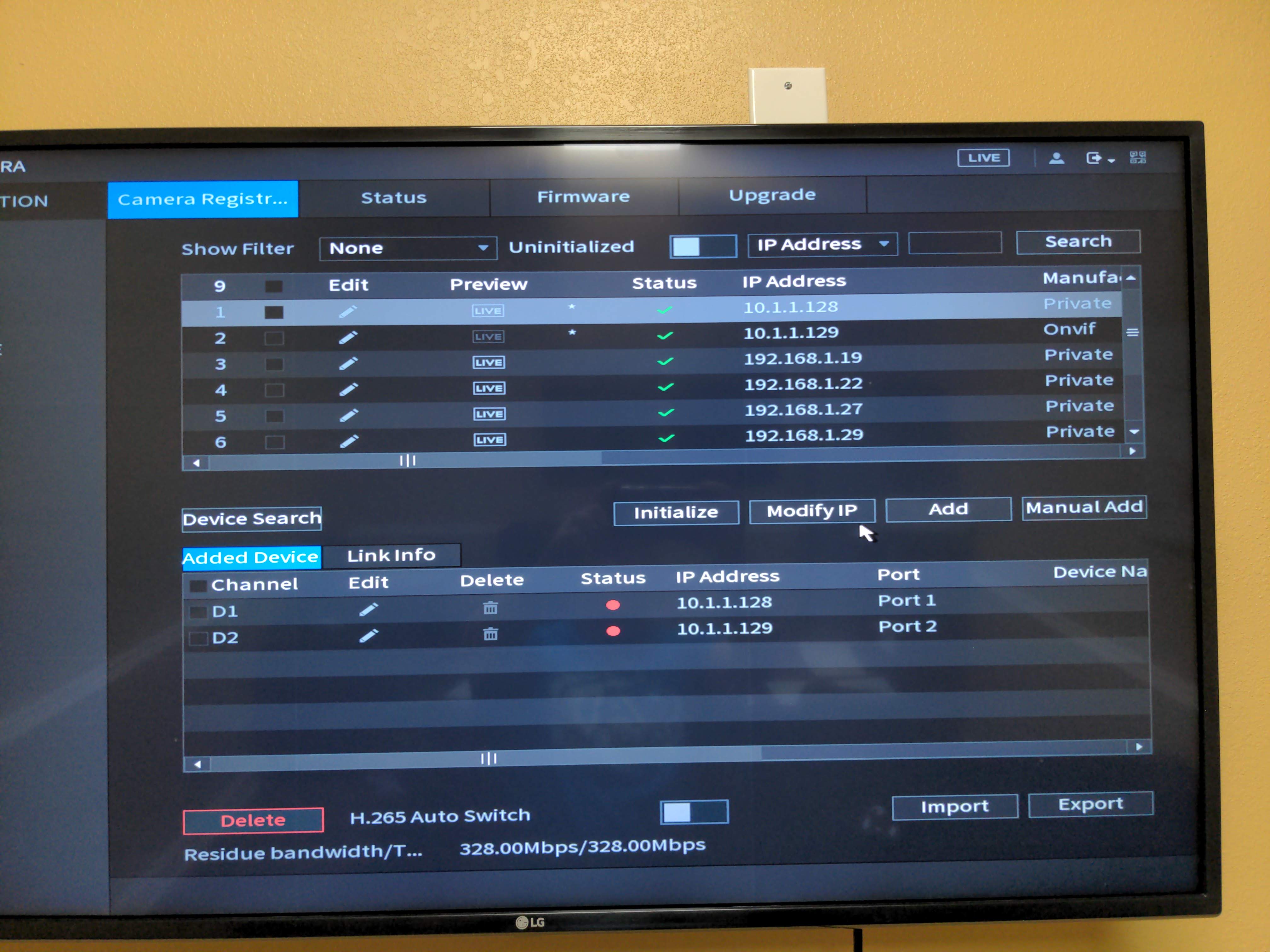

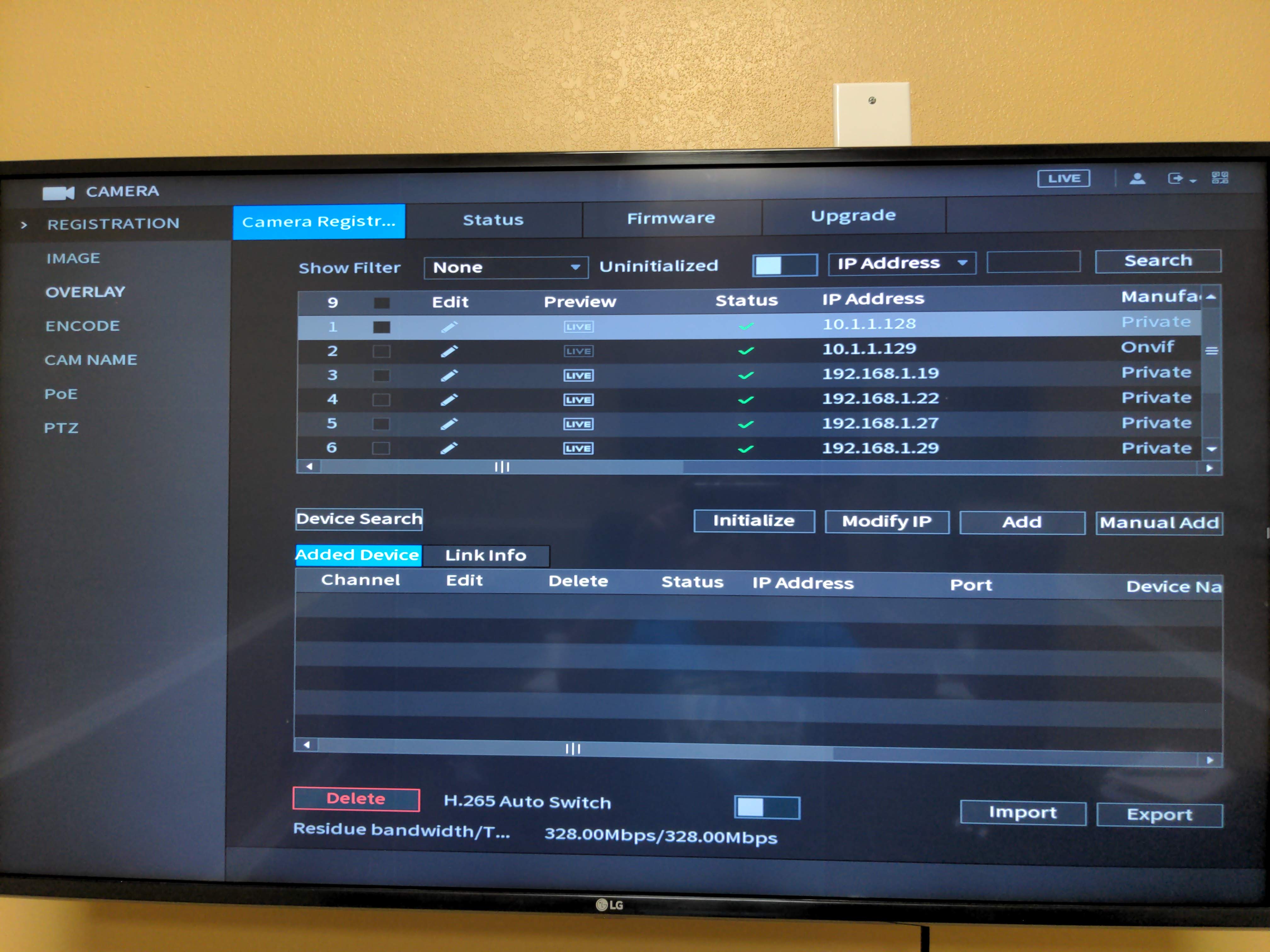

This camera always shows up on the NVR as 10.1.1.128 which is a different subnet than our LAN, 192.168.1.xxx. Also, there is another device that is always listed below it with the same subnet, 10.1.1.129. The interesting thing about this 2nd device (10.1.1.129) is the MAC is blank, MANUFACTURER is Onvif, all other cameras are Private, PORT is 80, all the other cameras are 37777, DEVICE NAME is NC324-XD, all the other names are listed as IP CAMERA. Searching the internet for NC324-XD, it looks like it also could be this no-name camera.
So, once again I'm confused. Is this no-name camera a knockoff HikVision or a NC324-XD by Winic Technologies USA, Inc.?
And which of the two 10.1.1.128 & 10.1.1.129 IPs is this camera actually connected to?
The 10.1.1.129 is using port 80, so wouldn't that mean it's likely a server or host like device, though the Device Name says NC324-XD, which the internet shows is a camera.
The 10.1.1.128 is using port 37777 and it's Device Name is IP CAMERA, so this also could be this camera.
We haven't found any other cameras, so I can't understand what this other device is exactly.
I thought it could be the NVR itself, but then why would its Device Name be NC324-XD?
I just contacted Winic Technologies, and they confirmed the serial number from this no-name camera is a camera sold by them. So, I'm not sure why HikVision told me it was a knockoff version of theirs earlier.
So, does this mean it must be the device linked to 10.1.1.129? If so, I still don't understand why it has no MAC address, is using port 80, and the manufacturer is Onvif. And why does all the other Device Names list as IP CAMERA while this device list as NC324-XD?

Do you have any idea which of the two 10.1.1.128 or 10.1.1.129 IPs this "HikVision/Winic Camera" is likely assigned to?
I'm thinking the .129 since the Device Name is NC324-XD, which is the same as this camera type, but I do not understand why it has no MAC address and is using port 80. Is this something unique to ONVIF cameras?
