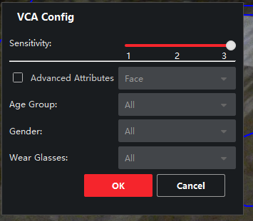

Can you find the Normal Events(Motion), not the ones, clips, recorded and found by Search tab on your NVR GUI or browser, but those that can be found by using the by Rules option in Playback - Event - Space Rule - Draw Motion Detection Rule.
If not, there you may have the exact issue with my NXI-K NVR, where after firmware v5.7.17, I cannot find Motion Events in timeline and also no Smart VCA events other than Human.
Also by using the iVMS4200 there is the option in Remote Playback to incresae Sensitivity for VCA rules search from level 2 to level 3. I don't think this exists on browser search by rules or there no such an option at all.
