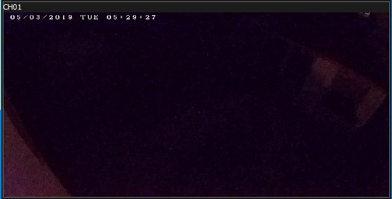

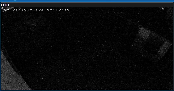

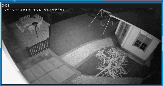

Can anyone advise what setting is causing the camera to alternate between these scenes through the night?

Do you have an external lamp that may be switching on (and off again quickly?) and causing the camera to think there is enough light for it to operate in colour day mode?
No i do not have any light source between the hours this is happening. I do have soffit lights on a timer but these are off when this is happening and once the soffit lights come on the camera is fine with no problems.
Managed to sort it last night, was a setting which should of been set to LDR Auto it was on LDR Colour.
