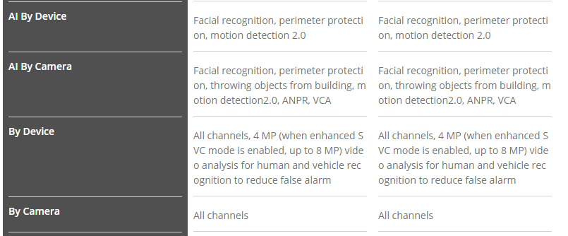

Hello everyone good day! I am planning to install CCTV on our house. I have been lurking and reading most all of the threads with regards to the decoders and cameras that is only available in our country that is not very expensive. Below is my plan setup and I am hoping that you could help me if there are incompatibilities with it or if you have better recommendations specially for the cams and POE Switch specs and cables and camera. Thank you. Another question is that is ColorVu whit light very noticeable when there are no other lights around? I just learned that IRs can't be seen with the human eye, is colorVu better?

NVR: Hikvision DS-7616NXI-K2
POE Switch: DS-3E0310P-E/M (8x10/100m POE, 2gbit uplink, 60w POE Power budget, 6kv surge protection)
Cable: Cat6e/Cat6a/Cat6 Outdoor
Camera:
4 x ColorVu DS-2CD1027G0-LUF 2MP Audio Bullet
4 x ColorVu DS-2CD1047G0-LUF 4MP Audio Bullet
(will replace some with dome/turret cams)
