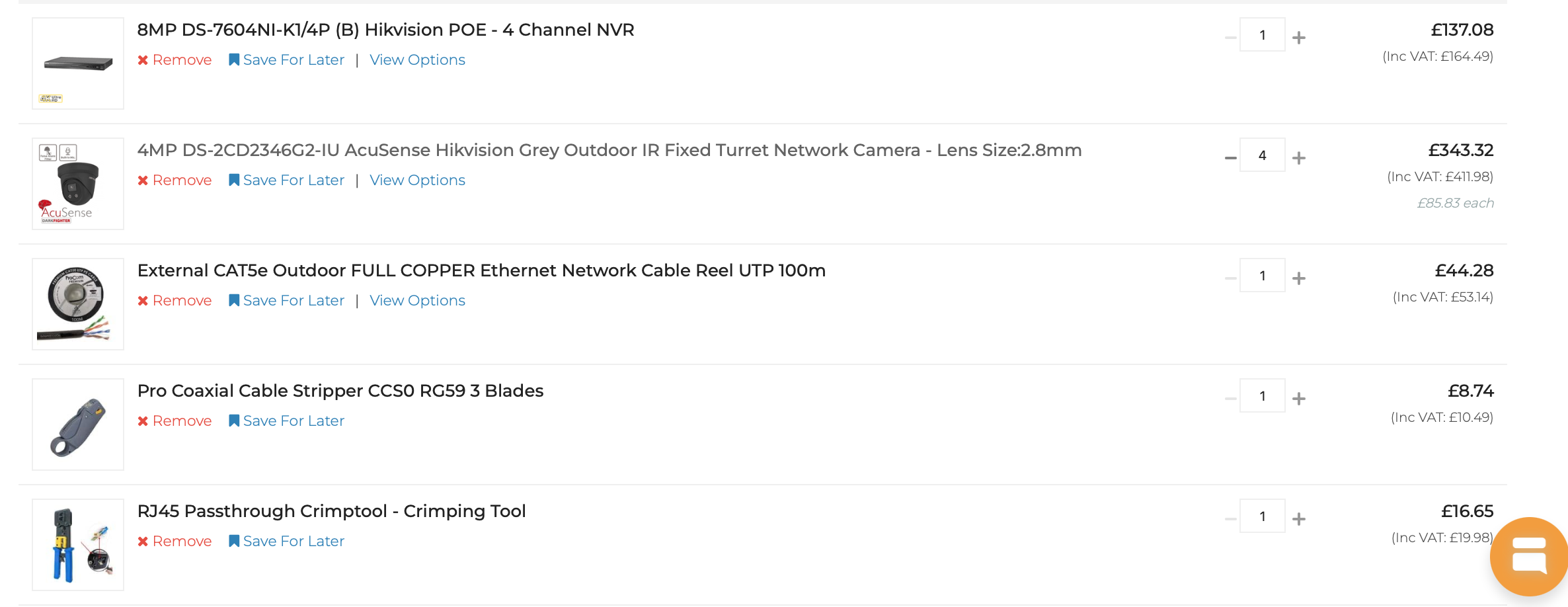

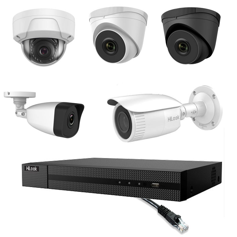

You've linked to a Hilook system - that's the budget brand from Hikvision - and will be better than the Amazon links you were originally looking at, but may not have all the features you'd find on a full-blown Hikvision system. The Amazon products you've been looking at are like a 20 year old Lada or Skoda, the Hi-look products are like a 6 year old Ford Fiesta, the Hikvision products I've listed are more like a recent BMW 3 series, but there are of course plenty of camera systems that are between Audi Q7's and R8's. On a forum like this you won't get any recommendations for the Lada or the Skoda - not many would go for the Ford Fiesta - most would plump for a 3 series BMW or above. But at the end of the day - a camera system is a camera system - you pay your money - you take your choice :)
This would be more likely along the lines of my own recommendations based on what you've stated you wanted - comes to about £550 excluding VAT - with the basic tools needed for building your cables. The cable of course needs to be external grade if it's going to pass through a wall or window and be exposed to the elements. I've spec'd a 1tb drive. You might need additional brackets for the cameras depending on where you're mounting them and to what. These are typically £15-20 a piece.

You'll also find that if you're buying direct from a wholesaler - you won't necessarily get the same support you would as a consumer buying something from Currys. If you can't work out how to make it work, although most suppliers will help with fault finding - they won't baby walk you through a full install. From what you've said, you're confident with IT, networks and cables - so you should be in a better position than most in terms of people that want to fit their own system. Good luck with whatever you choose.

Does this not have a Recorder? I assume that if it does then minus the HDD that you mention. What am I getting here exactly for £245.16 inc VAT? It shows 5 cameras. I will need the Ethernet plugs to crimp the cable too. Is this cable not suitable for external? I would need the ethernet conectors nor shon as extras. AND where are those miniature pub cameras.
The flat would be empty so no recordings there. The one external, possibly only the postman. I would at best have a few hours of recordings a day if EVER. So how much storage for a month? 1T / 2T / 4T?

The link you have posted is a 'build yourself a system page' - you don't get the full system and five cameras for the £245 when you first click on it. Look carefully - you have to move the + and - accordingly for what you want. Once you've added the hard drive, cable, tool and selected which camera you want it's more like £400+. (And with 4 channel - 4 cameras is your max - the picture shows 5 cameras to show the different types of camera available - not that you get 5 cameras)

I would avoid dome cameras as they can have problematic night images, and are more likely to attract spiders. I've found turrets best in general day to day usage.
