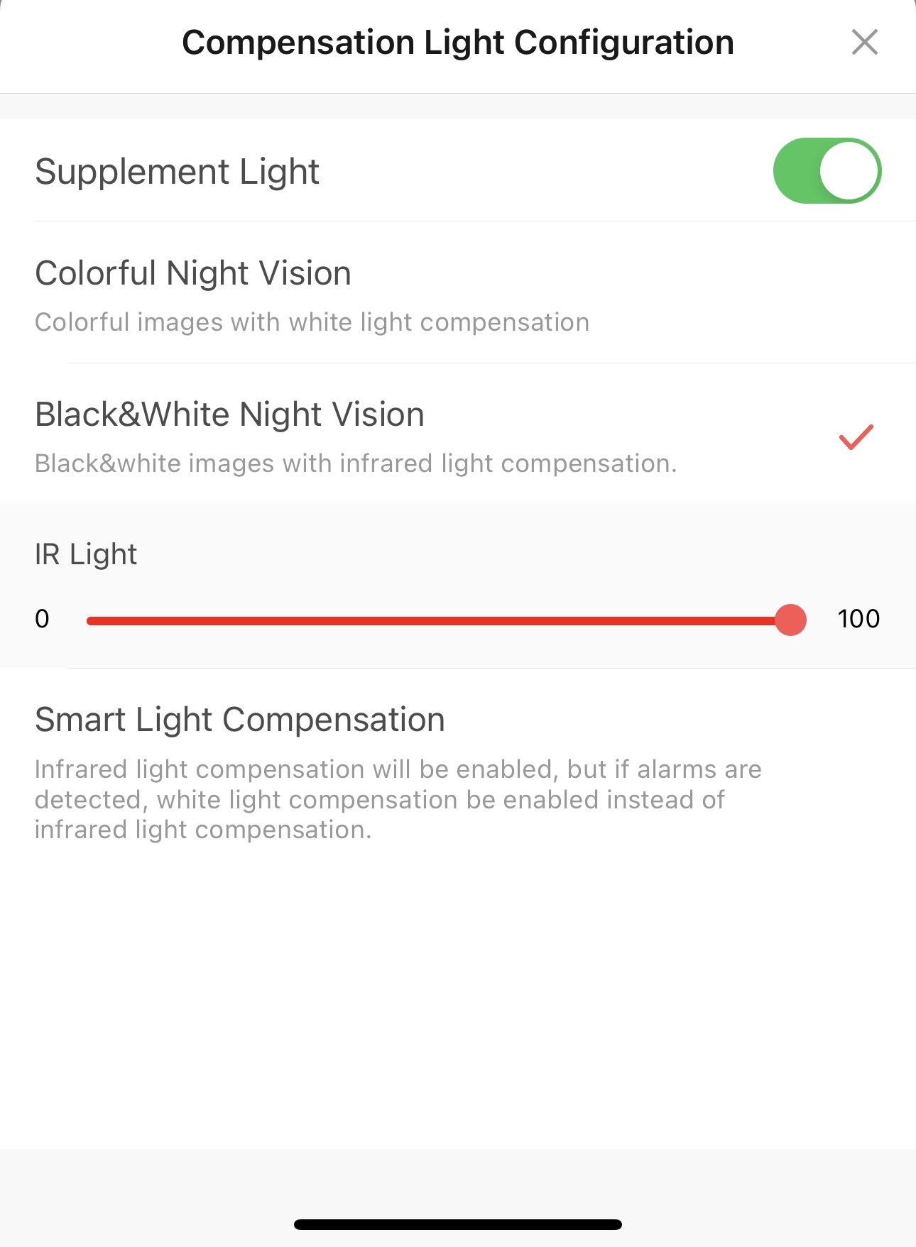

This is where I'd recommend the DS-2CD2347G2H-LIU. Using the hybrid light camera gives both options so that you're not left regretting your choice once installed; there's no need to wonder whether the amount of ambient light will be sufficient to operate ColorVu without supplemental LED. Modes can be switched between Infra-red, ColorVu and Hybrid/Smart directly from the Hik-Connect app now, by the end user, so there's no need to fiddle in the menus:
