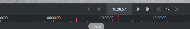

One anomaly I've noticed on this and the previous firmware is that the recorder switches into Event Encoding Parameters (main stream(event) video settings) when there is motion in the image - even when that motion is outside of the area defined in the settings. For instance a car driving along the road will not trigger an event as it is outside of the detection area I've set and I have the cameras filter set to Human only - however in the Maintenance > System Info > Record screen of the NVR the encoding parameters column switches from Continuous to Event each time a car passes or someone walks past outside the configured area.
