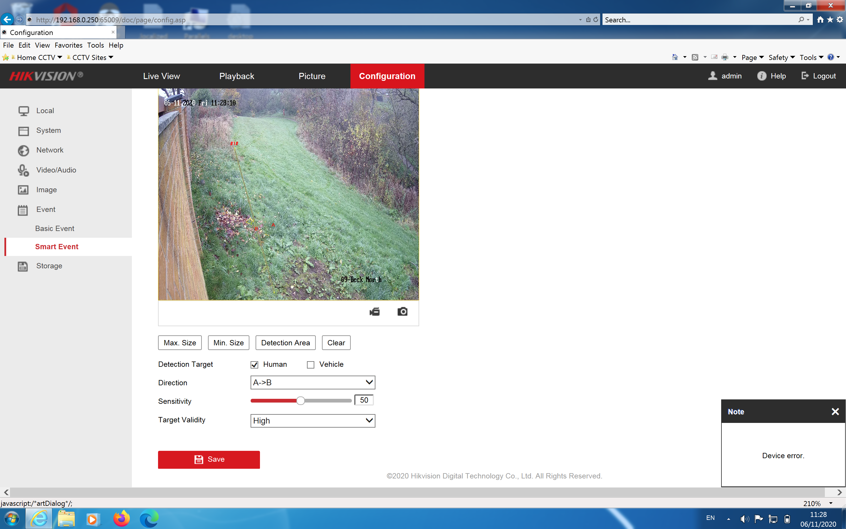

First observation - there's a new option in smart events allowing you to set the target validity for the AcuSense Filter - Basic, High, Higher, Highest (translation - "probably a hedgehog, but might be a shadow, could be a fox, is that a human?"). It would've been a nice feature but attempting to save a change results in an error.

I've tried altering the setting on both the DS-2CD2386G2-IU and DS2CD2386G2-ISU/ISL using IE run as administrator and Safari. Not only can I not change the validity setting, I cannot delete the line, or change any line crossing setting (including disabling line crossing) without receiving "Device error". The DS-2CD2346G2-ISU/ISL is working normally and the validity setting can be adjusted.
The difference before starting out was that the 2346 had a minimum and maximum size box applied whereas the two 2386's didn't. The reason they didn't, was that if you draw and apply a minimum/maximum box using the I series NVR (monitor and mouse) and apply it - it appears correctly on the NVR screen but the setting doesn't get sent to the camera (is not visible when you log into the camera directly) which is another bug

@Dan - Just fixed it without a reset :)
Nothing could be changed with regard to line crossing using a browser including disabling line crossing. I used the NVR mouse with locally connected monitor and refreshed the browser page after each settings change so that I could see that the change was applied in the camera.
  1. Disabled line crossing
  2. Deleted line
  3. Redrew line and added min max boxes
  4. Enabled line crossing
Each change was applied to the camera (when setting via the mouse) including the minimum/maximum size boxes - so that bug is no more - bonus. It is now working correctly via the browser and I can again make all changes - including Target Validity and apply them without error.

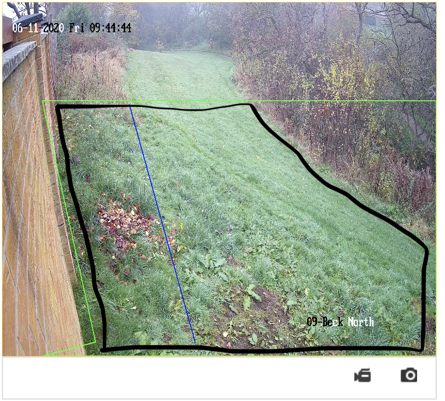

The polygon drawn for motion just randomly loses the shape that was drawn and saved. Sometimes the shape is random and sometimes it defaults to a rectangle. The only way I become aware thats it's happened, is that I begin to get alerts from outside of the originally framed area. I think I added images in another post some time ago (I'll have a search for the post) but I screen shot the attached a few days ago when I noticed it had happened again so don't have a "before". This one is 2386G2-IU. I've crudely marked up what was drawn originally!

Should be fine to upgrade. The issue I've shown above seems to happen when other settings are altered or the camera is rebooted. It's a bit random and did occur on 5.5.134 as well so it's not a new issue. Hikvision are now aware of it as @Dan reported it to them and they took a look at mine remotely.
