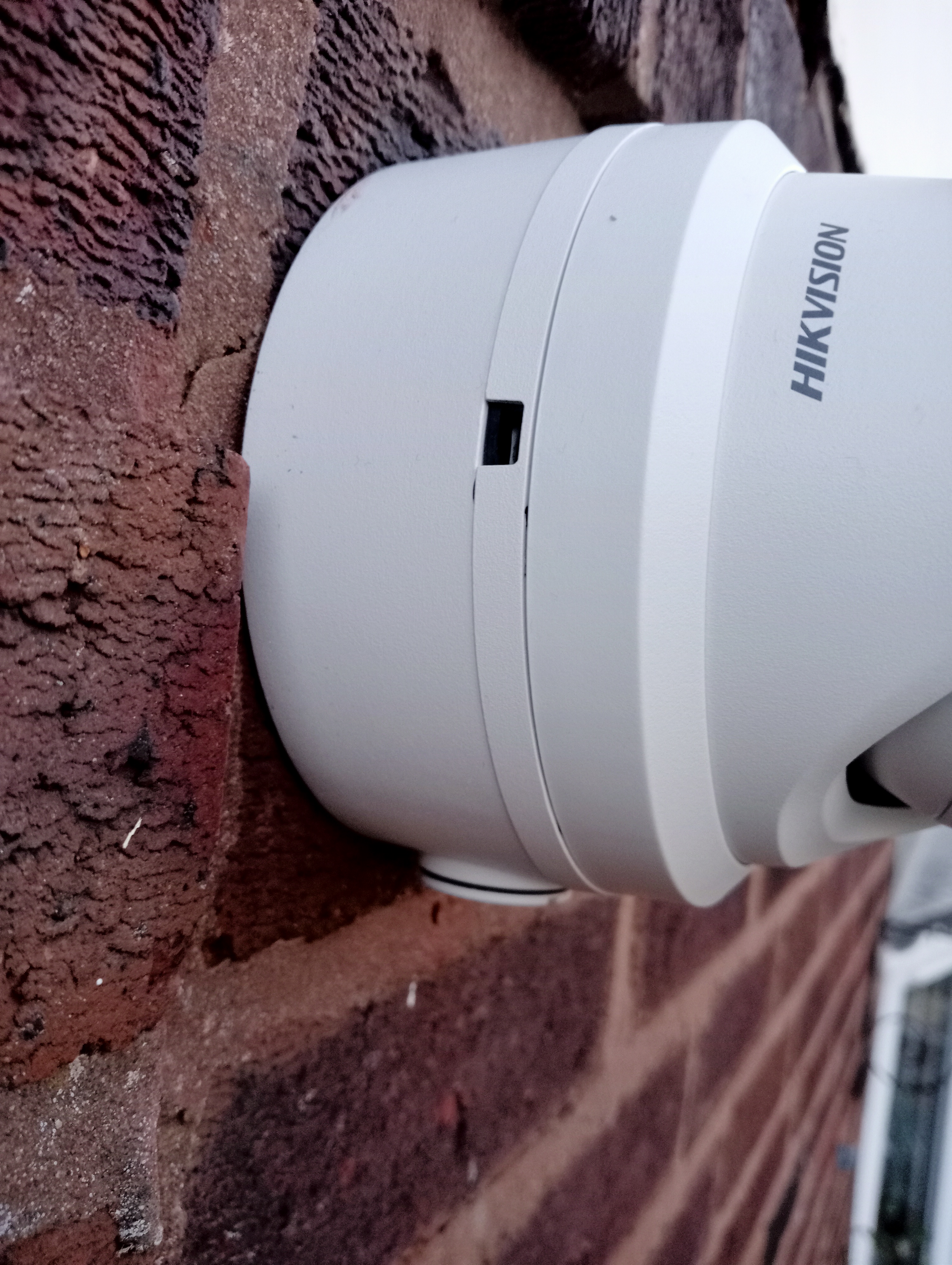

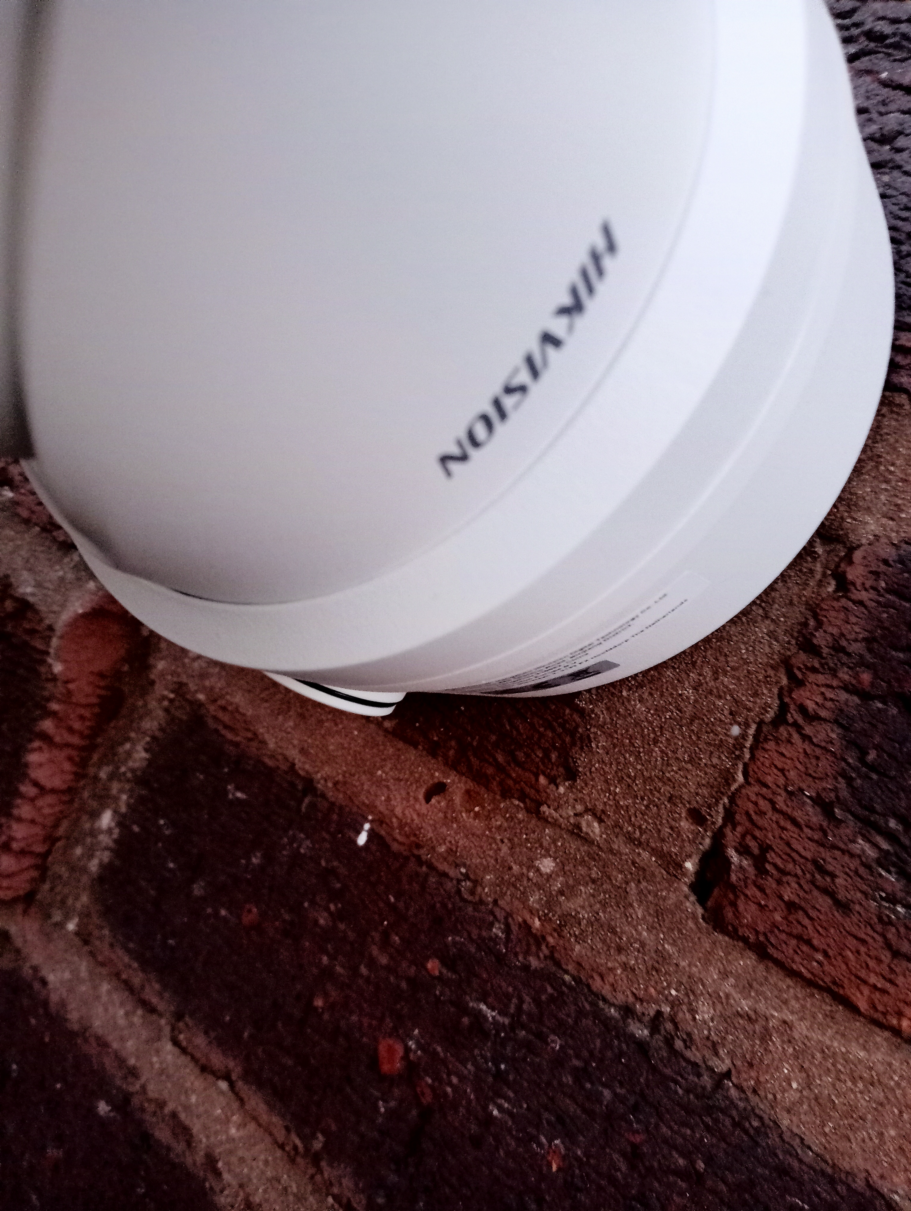

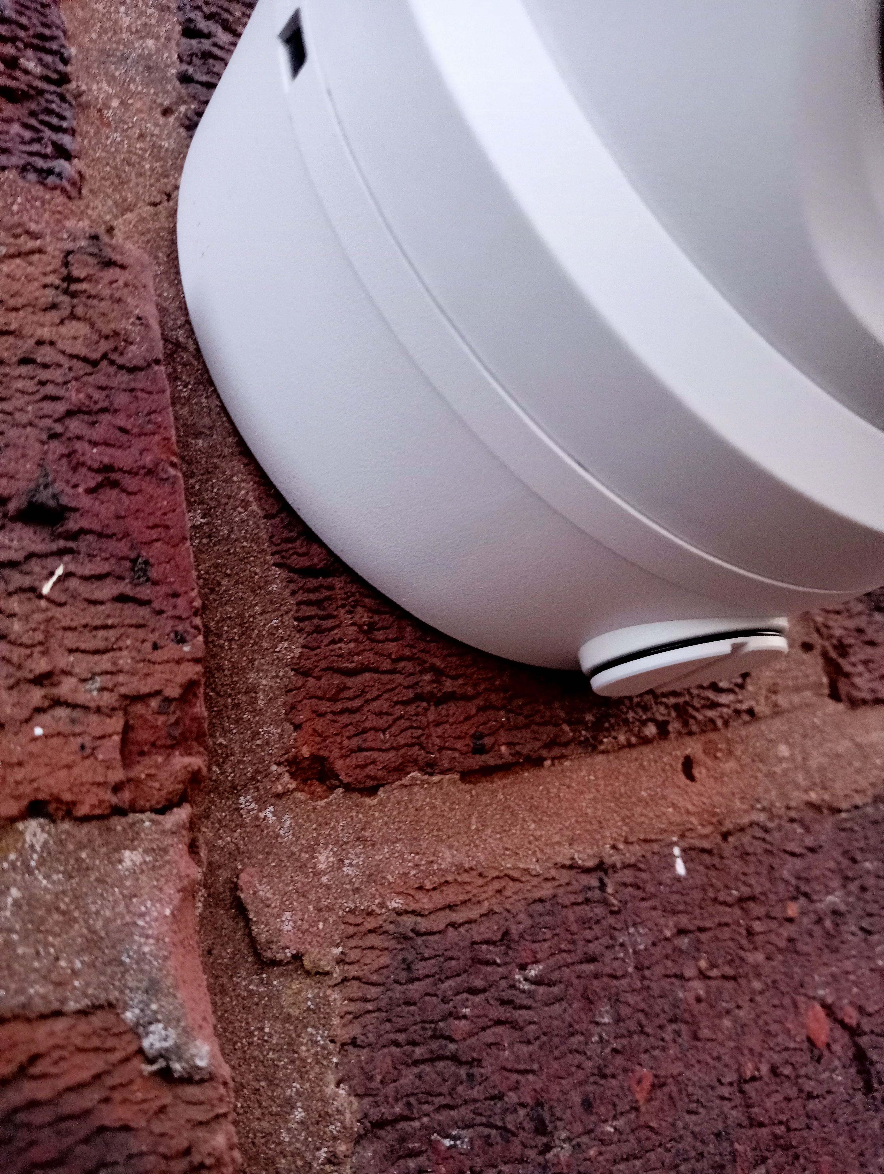

Hi i may have made a booboo hoping for a once over on my first camera install.
Camera is DS-2CD2347G1-LU 4MP with Hikvision DM21 junction box.
Cat 6 cable from rear of JB and pigtail within the JB.
Does something go in this gap as in a plastic plug of some sort and if so does the camera need to be removed to fit it or locate it?
Thanks for any help.

Hi @Moley8
Yes, there should be a small rubber bung that goes in that gap on the turret's base.
It is quite common that the bung pops out when you are first handling the camera, check the packaging and the area where you first opened the camera to see if you can find it.
If you can't find it you'll need to fill/cover the gap with something else like a weather-proof sealant or water-proof self-amalgamating tape.
Thanks Dan, thought that appreciated. Found the rubber bung in the undergrowth and will pop in. Thanks again

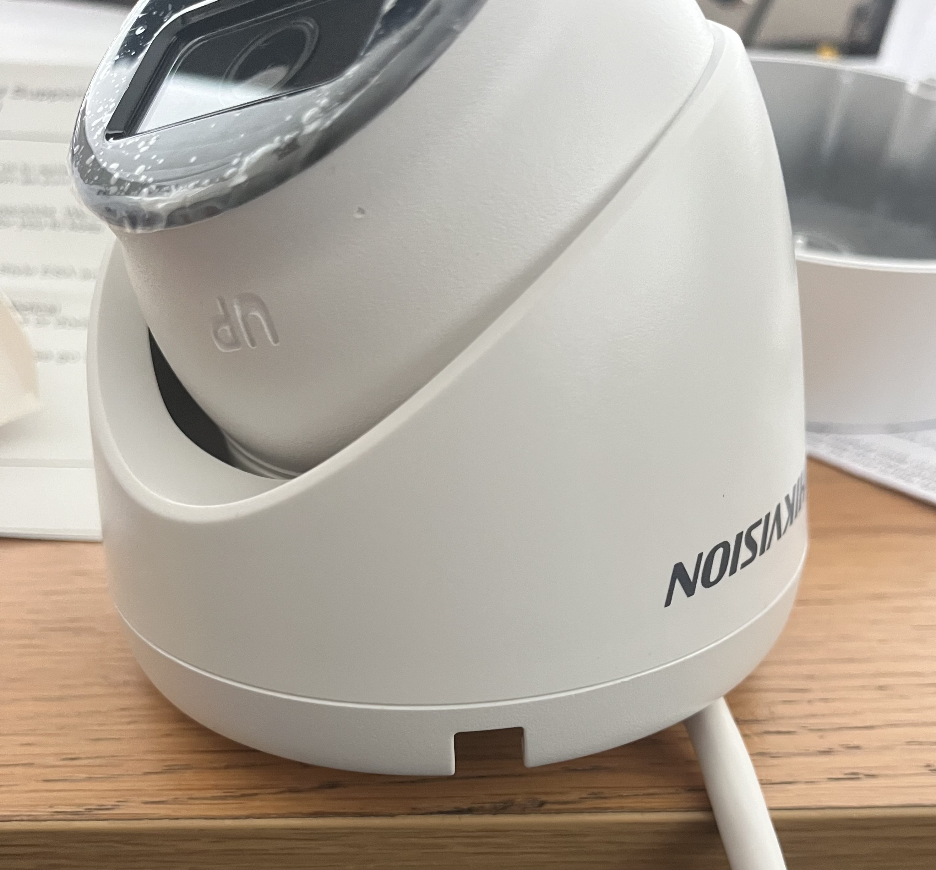

I am just installing DS-2CD1383G2-LIU to DS-1280ZJ-S and I definitely don’t have a rubber bung in the box? I can use silicone to seal it but I’d rather not.
That model does not have the removable plug/bung. You can just seal it if needed. I have one of my own cameras of the previous type where the gap is not covered and it's been like that for 4 years without issue. The cable assembly is waterproof anyway if installed correctly.
Thanks for replying yeah I do look out for odd bits falling out the box but i knew nothing was in the box and it looks like a plug/bung wouldn’t fit in anyway.

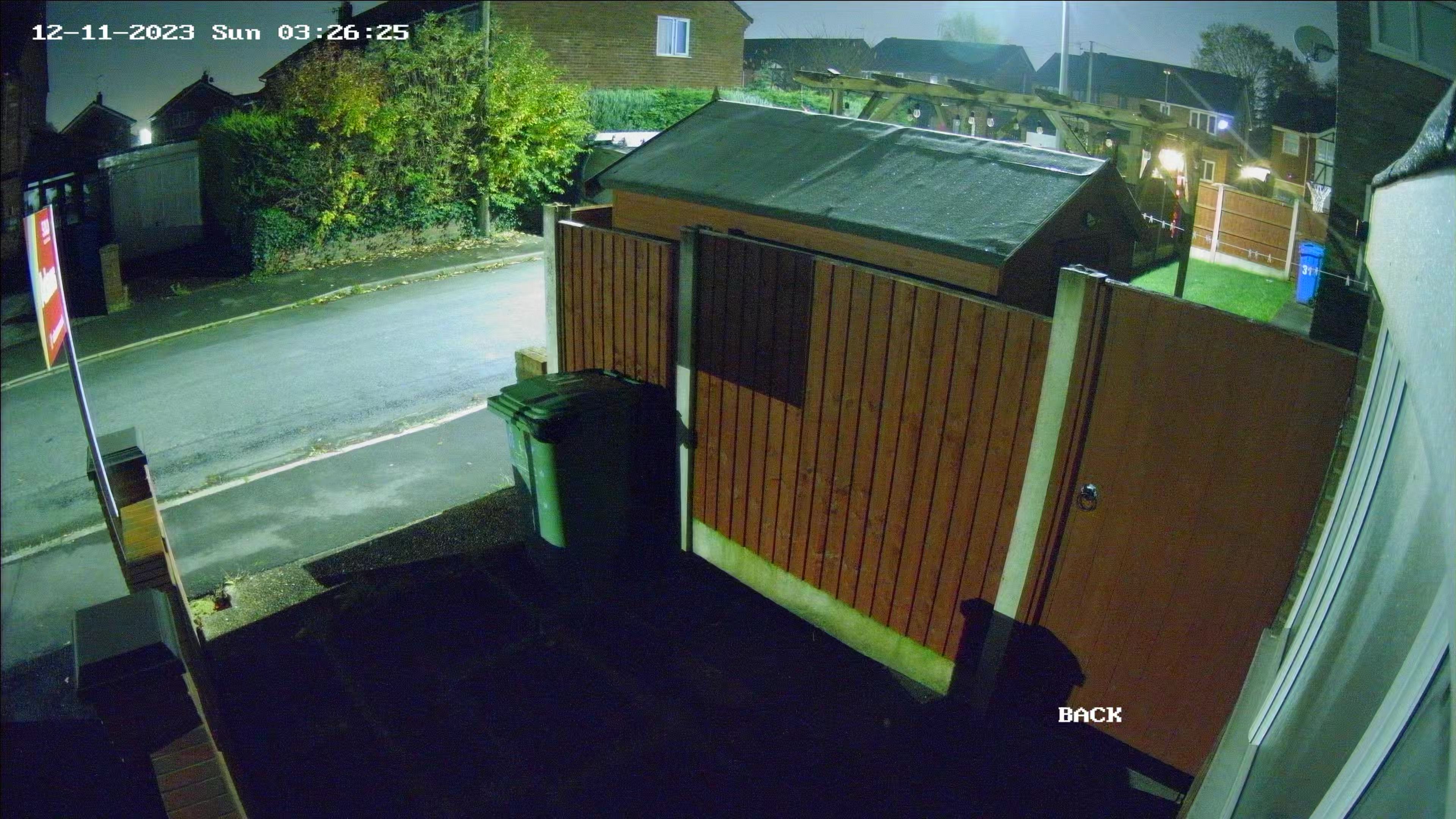

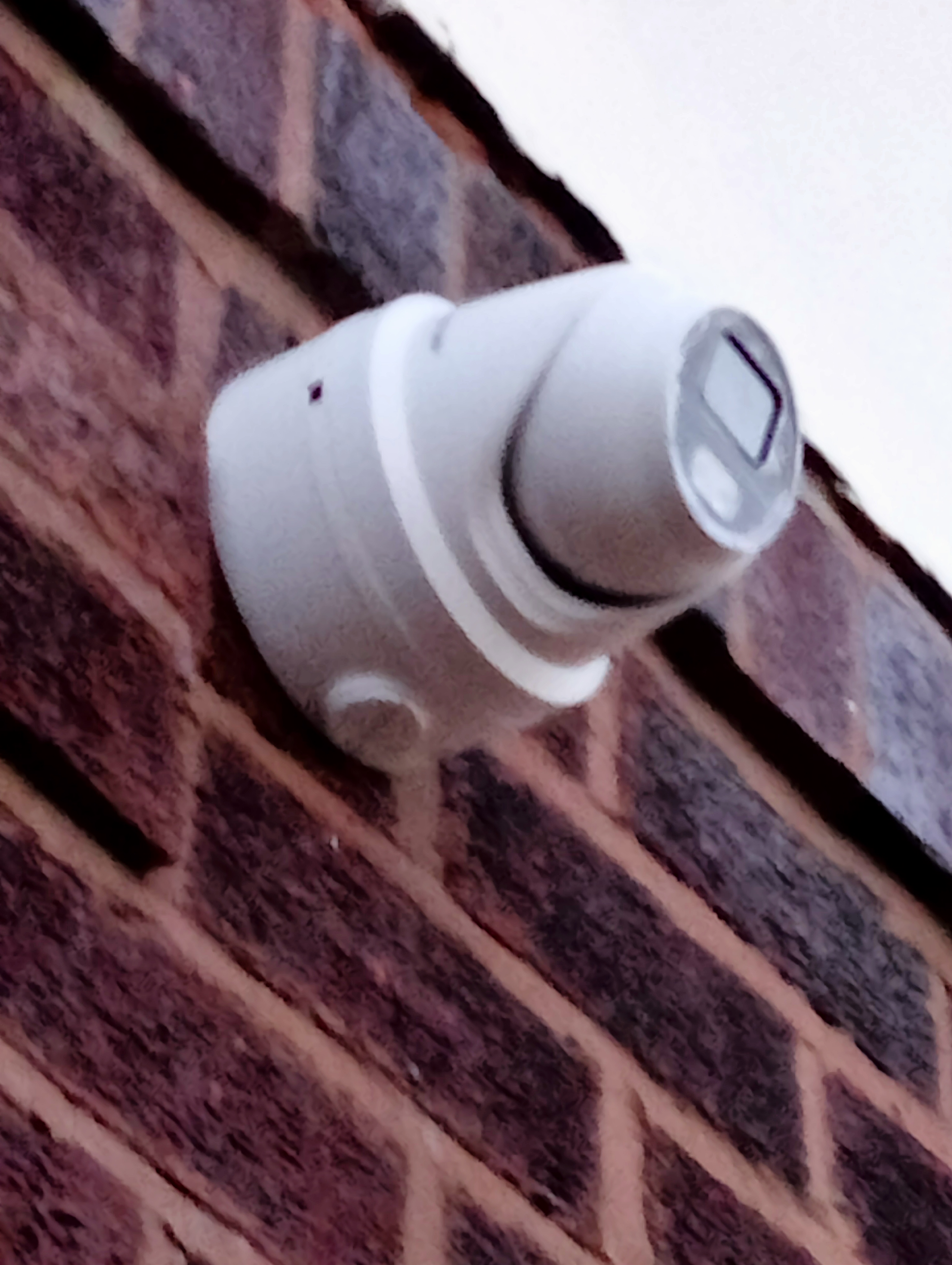

Thanks that’s a very good explanation of ColorVu. One of the best I’ve seen. I have DS-2CD2347G1-LU at the front of the house and DS-2CE72UF3T-E at the back of the house. I’ve never had to use the supplement light because of the street lights. At the back of the house it’s actually pitch black but the camera uses the light really well. Discusting as it sounds I’ve actually had a dog walker have a wee because they think they won’t be seen. The lens is steaming up on that one and I thought let’s try the new hybrid camera. I’m yet to fit the new one DS-2CD1383G2-LIU. I just assumed it would give me the option to still have colour like I have now without using its supplement light but I am going to give it a go because I don’t mind the light coming on at the back and it is a good deterrent. I will put a couple of pics on for examples but the back one is older as I don’t have a new one as it’s not working now.
