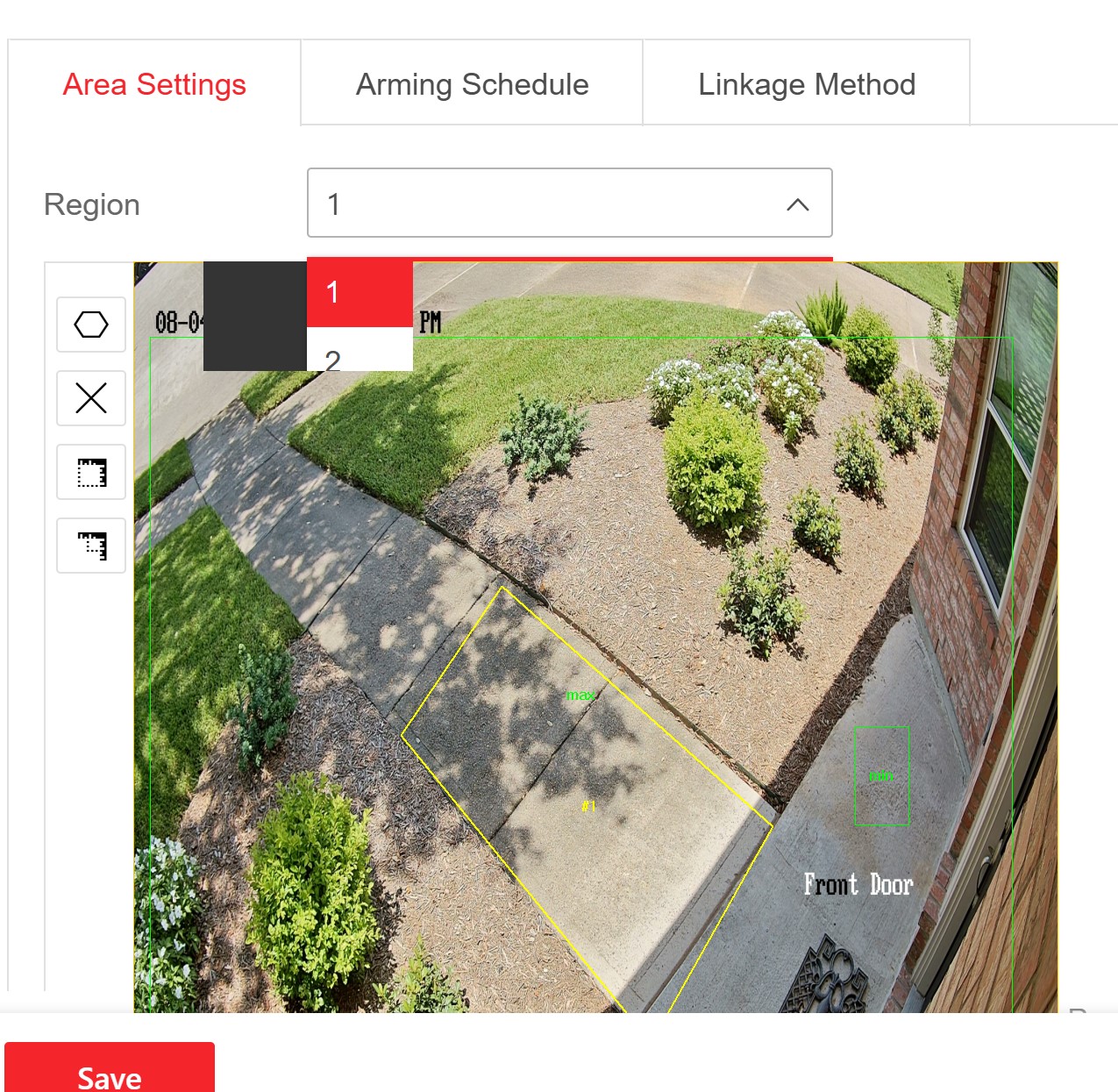

And yet another problem with the browsers - any function that ends up having a dialog box, or "click here for OK" or anything like that gets hidden behind the live view of that camera you're working with. You get stuck without being able to confirm or reject the function. The pic below was my attempt to clear all the areas for intrusion so I could redraw the area, but I get stuck at this point. The only workaround I've found is to hit the browser's "settings" then "inspect webpage" which pushes the dialog box further left and allows you to click it.

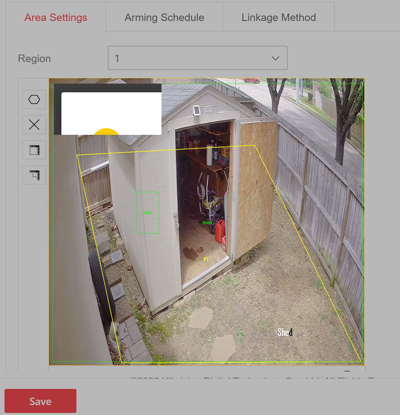

Another example. On the G2 I just installed, I cannot see all four intrusion detection options to set parameters, because the dropdown box is obscured behind the live view. I've updated web components, updated local services, whitelisted the URL and everything else I can think of. This is in Edge. I cannot even get the web interface to load in Brave or Chrome, despite the same efforts at whitelisting, etc. Maybe someone smarter than me can figure this out.

Can you try the HiToolsDelivery for your Settings? The interface is similar to Edge
Since none of you over there seem to have experienced the same problem - yet - here is a partial fix according to the U.S. guys, if you are interested. Uninstall each browser, one at a time. Reinstall, and import your bookmarks/favorites from another browser. Do the same to browser #2, #3, etc. Once they are reloaded, go back to your bookmark for the NVR and it seems to work for some of the problems I've mentioned. For now.
