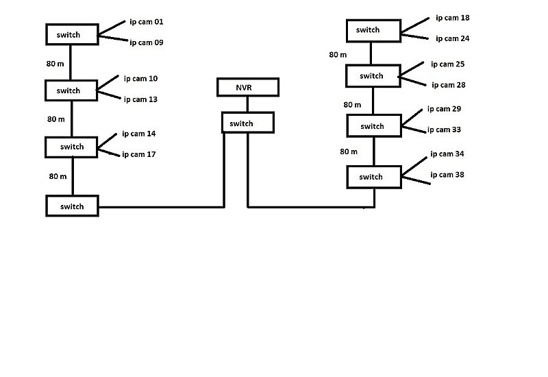

there is a place already having an existing infrastructure for cabling as shown in the image above, my question is this topology will be fine with that total number of ip cameras which are 38 with no lag or delay in live view ?.
Some details:
1- approx distance between all switches are 80 meter.
2- Total bandwidth of all 38 ip cameras = 340 mpbs.
3- all switches are giga ethernet.
4- Packet Filtering / Forwarding Rates for switches = 1,488,000 pps per port
5- Data Transfer Rates for switch = 2000 Mbps (full duplex).
6- Packet buffer = 128 KB per device.
7- all cables are UTP CAT 6 .
8- frame rate fps = 25 fps
