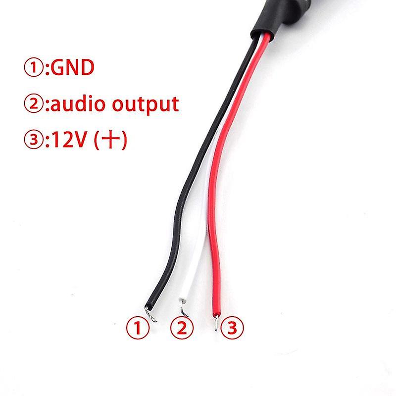

I am trying to wire an external microphone (see attached image 1) to my bullet cam.

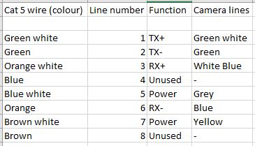

The pin out wiring is absolutely fine and the video feed is now spot on. Refer to image 2 on the current pin out.
Right now on the cat 5 cable I am only left with "Brown" and "Blue" wire.
Can someone advise would it be possible to "hard" wire the microphone with 3 wires (12 V, GND, Audio out) to the exisitng Cat 5 cable.
This may mean i may have to tap the existing connection to power the mic as well as allow audio transmission via ip.
