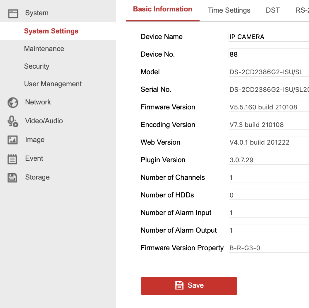

Ok, so here is one of my DS-2CD2386G2 cameras (which I've just
noticed I've not got the latest version on) - if you look at the bottom line it shows that it's a G3 in the firmware version property box:

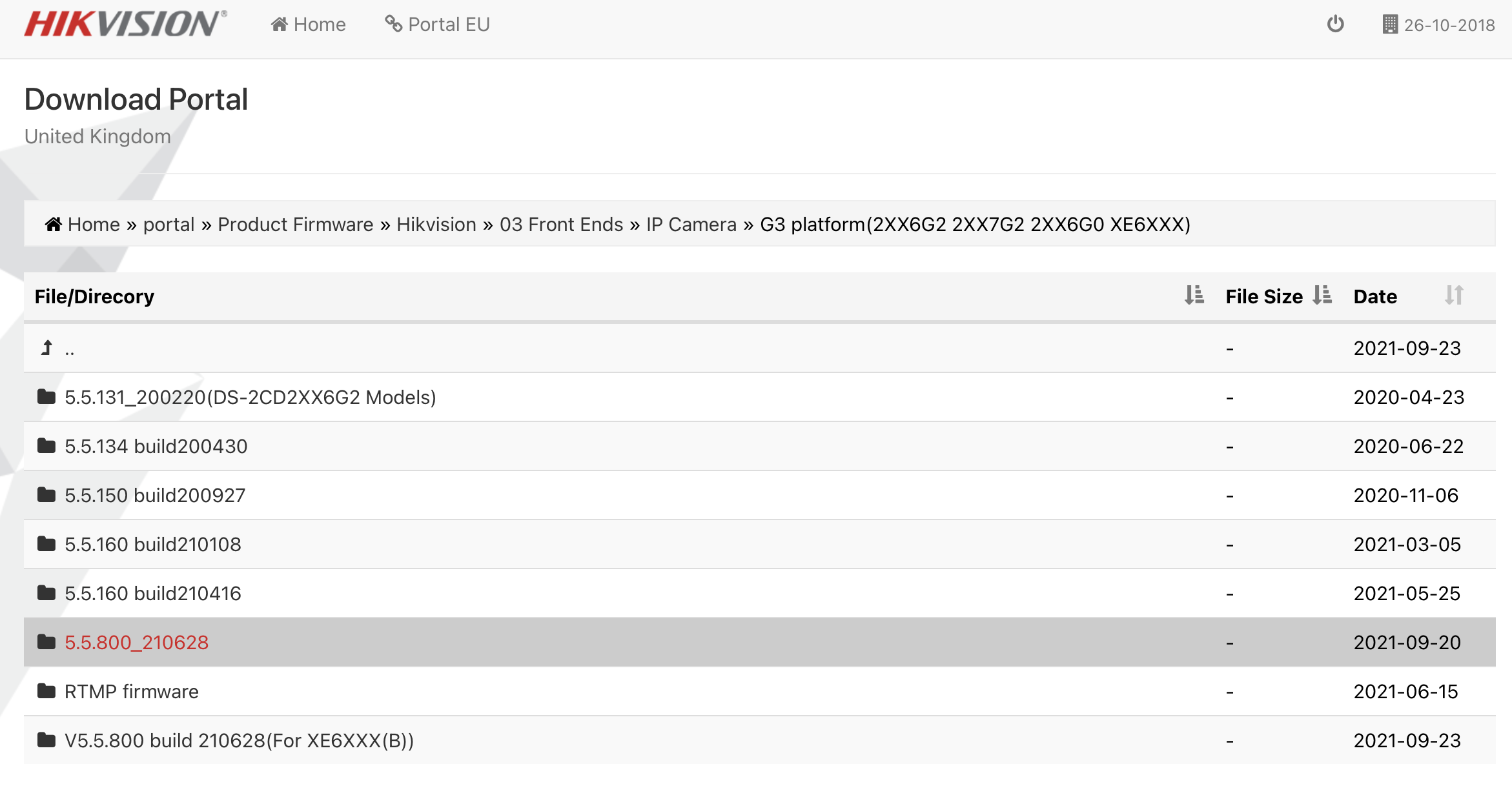

And here is the page from the UK portal for the G3 platform cameras - at the top, in the path, you can see it's suitable for G3 cameras with model numbers "2XX6G2" so that includes the 2386G2:
You can see that version 5.5.800 is the latest version on there for that model. The update is running on mine now....

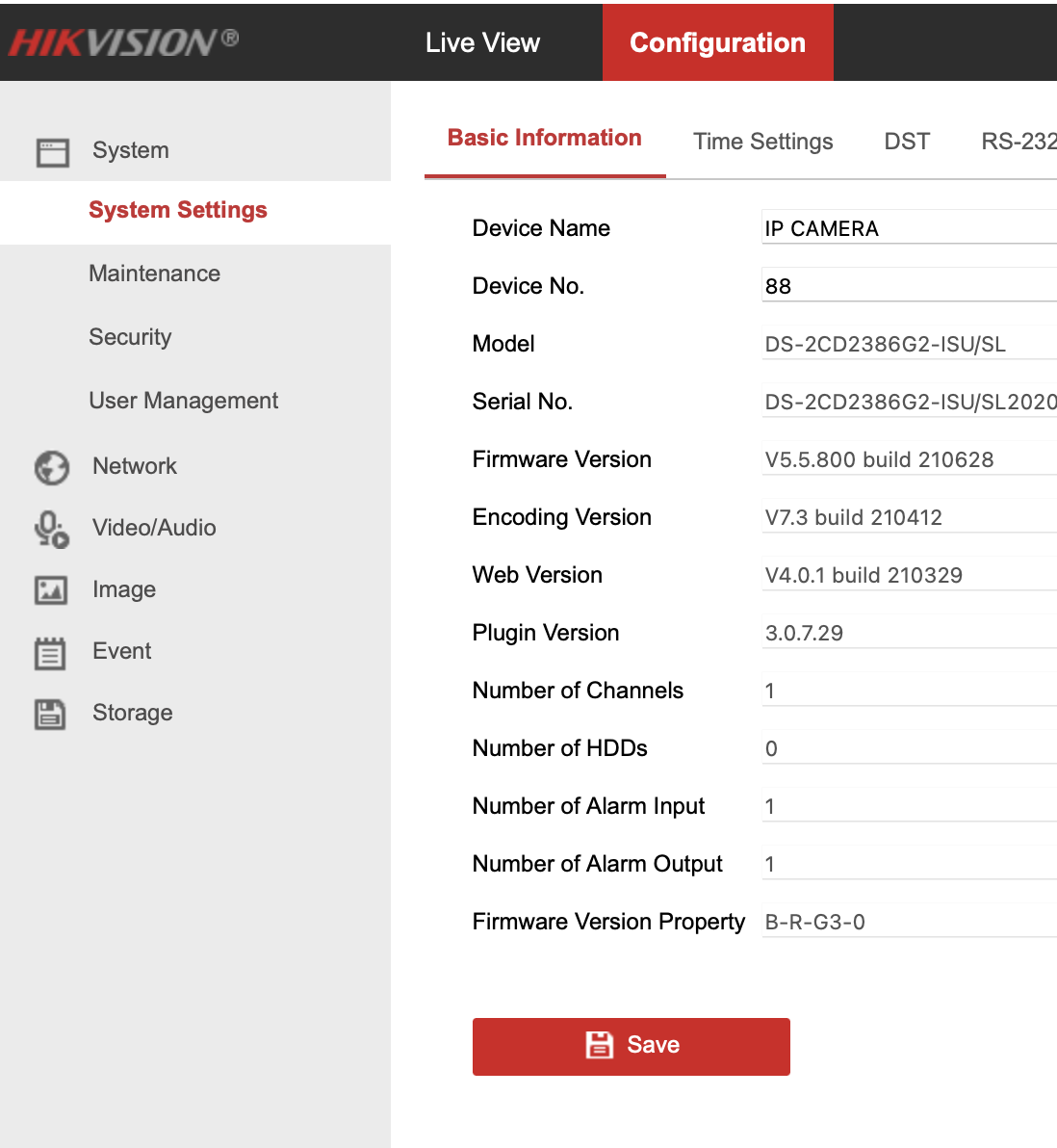

.... and here it is following update and reboot on 5.5.800:
